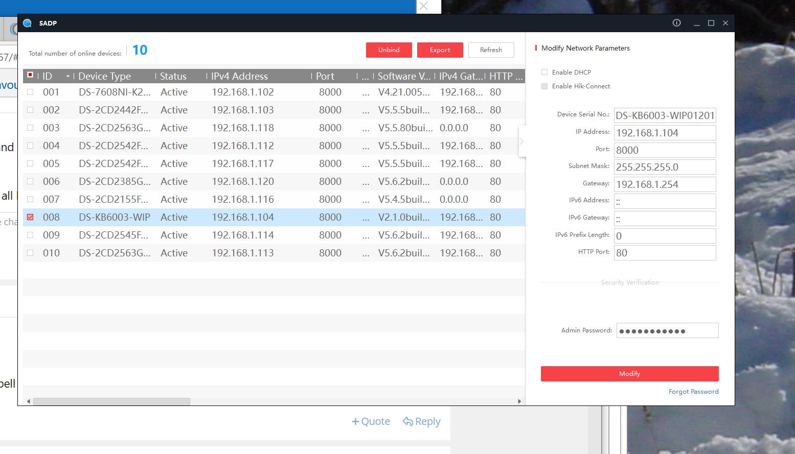

If I open up the SADP software and put a tick in the box for the camera, I can change the parameters but to save the changes I need to put in the cameras password. If I input the password I have, I get the message that the "parameters, modifications complete". If I put in a random password, I get the error message that its the wrong password.
I double click the Cameras IP address in SADP the browser opens and put in the password I used to save the changes, I get wrong password or user name message!

Maybe upload a screenshot of what SADP is showing?

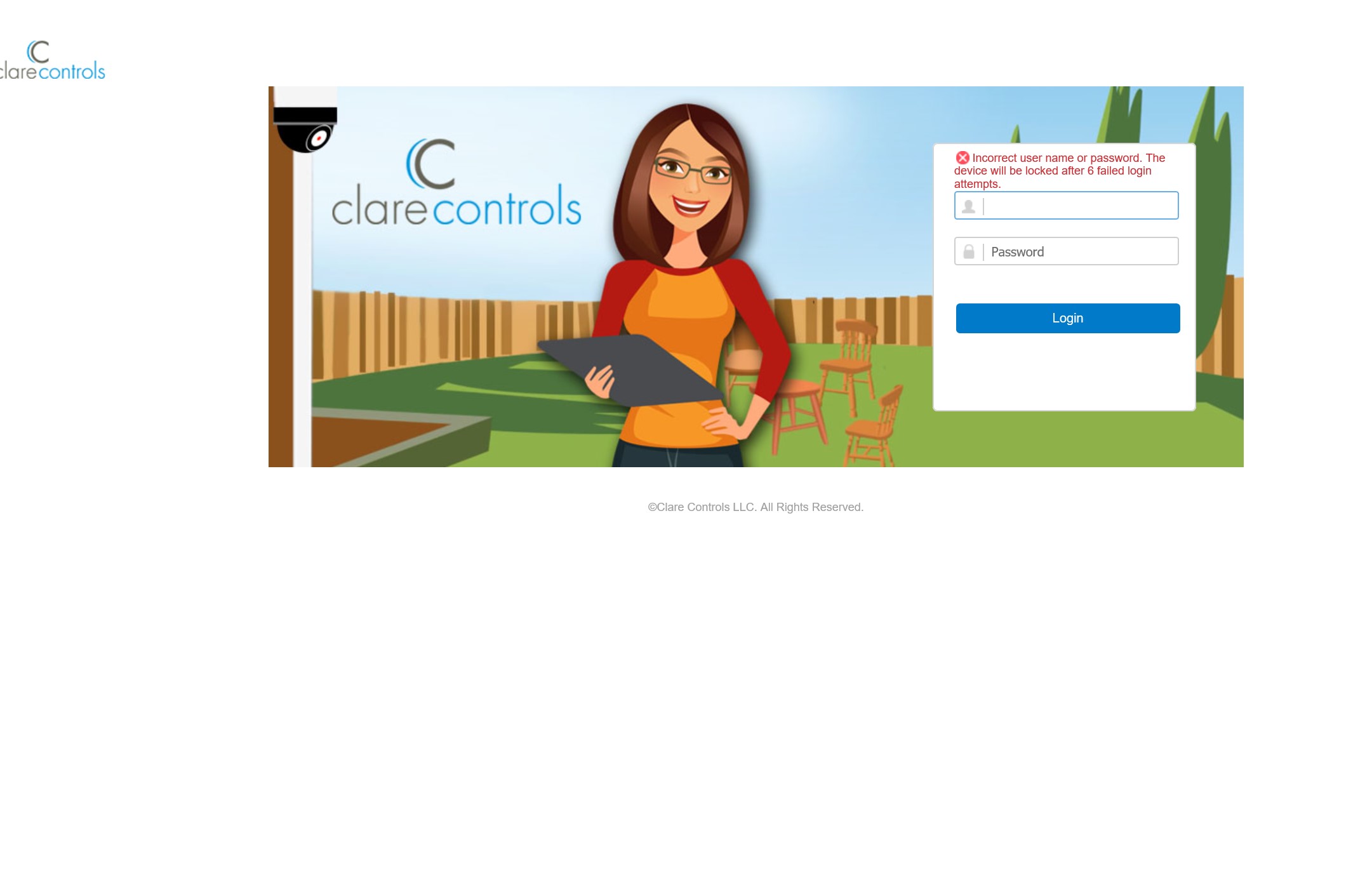

Also, please upload a full-page screenshot of the login error page?
Hi, here is the screen shots.
I've never seen that Clare Controls screen before?
I had a problem last year with the bell and I was sent an update file with new firmware which was Clarecontrol when I installed it. When I could get into the setup pages, it was just Hikvision under a different name. I looked at the clarecontrol web site and its the same doorbell.
Are you definitely using Internet Explorer as your browser when you attempt to login on that Clare Control screen?
And admin as all lower case?
And even when you paste in your password it fails?
Perhaps you've exceeded six attempts?

it still fails when I cut and paste. When you exceed 6 attempts, you are logged out for 30 minutes before you can start again.
