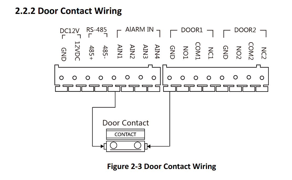

It seems this green indicator reflect the Input1 status. By default, Input1 assigned to the Door status. Door contact should be connected as shown on the scheme from User Manual. I can't disable it through the device web Interface, probably this can be done with the Hik-Connect app, so I just connect Input1 to the ground with short wire.

@Cool2000 thankyou for the time take to respond to me, I thought I’d tried this but not sure if I corrected correctly so I will give it a second try. Do you have one of these and had the same issue and resolved it the same way?

I have DS-KV8113-WME1(B) model with 2.2.43 build 210407 firmware and this shortcut connection definitely switch green LED off.
Wonderful again thanks for replying, look forward to trying this weekend. Strange I don’t have to do that with my other unit the 6113 which is from the same Villa family
