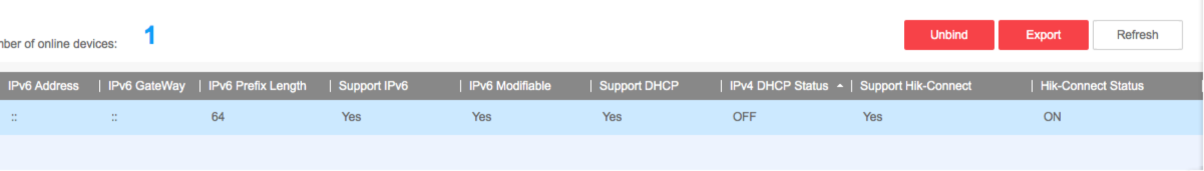

The camera appears on SADP when I've visited the property and is 'on' (I've attached a screenshot)

Hi @GemmaM
Can you just confirm that the "4G enabled SIM card" you describe is installed in a 4G router?
You say you have tried the IP address in the browser but the login page it takes you to does not accept the password you have, this would suggest you have the wrong login details which is common with less experienced installers.
You are likely going to have to hard reset the camera to set a new password to access it with a browser and properly set up Hik-Connect.
If you can wait it may be best to do this once you have the internet connection installed because once that happens you will likely have to do further network configuration to get the camera working on the new network range.
