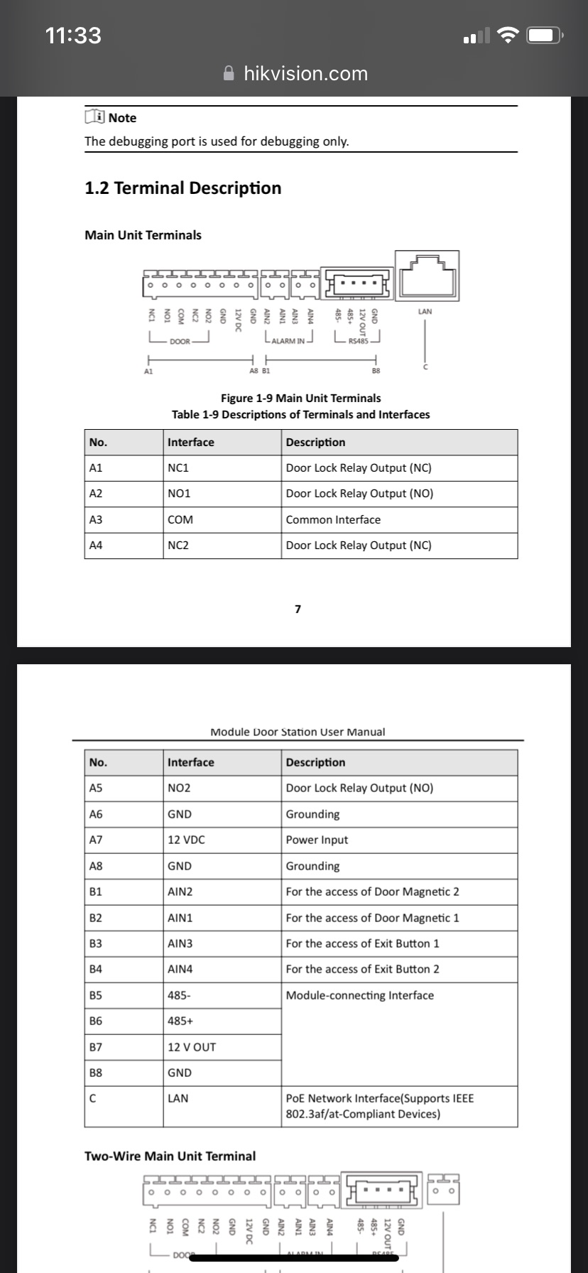

I’m in the middle of getting sliding gates made, and have an electric motor to open/close it. We have also purchased the hikvision IP modular intercom system, I believe I can connect the hikvision intercom to my electric gate motor using hikvision NO1 and COM. This will open the gates using the hikvision app/ screen. However my concern is will it be able to close the gates? I’ll be turning the auto close off on the gates as we wish to set a timer which I believe we can on iVMS (open at say, 8am and close at 4pm), so ideally we would like to manually open and close the gate.
Will we have a button to ‘close’ gates on the hikvision intercom screen? And should this close the gates or do we have to add some sort of relay to power the close?

I've not used the Hikvision intercom. If it provides a volt free changeover or common/normally open output nothing else would be needed. However if it supplies a voltage (intended for a maglock or electric strike, you'd need a relay with a coil matching that output in order to provider a volt free contact to the gate controller terminals.
