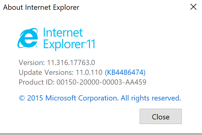

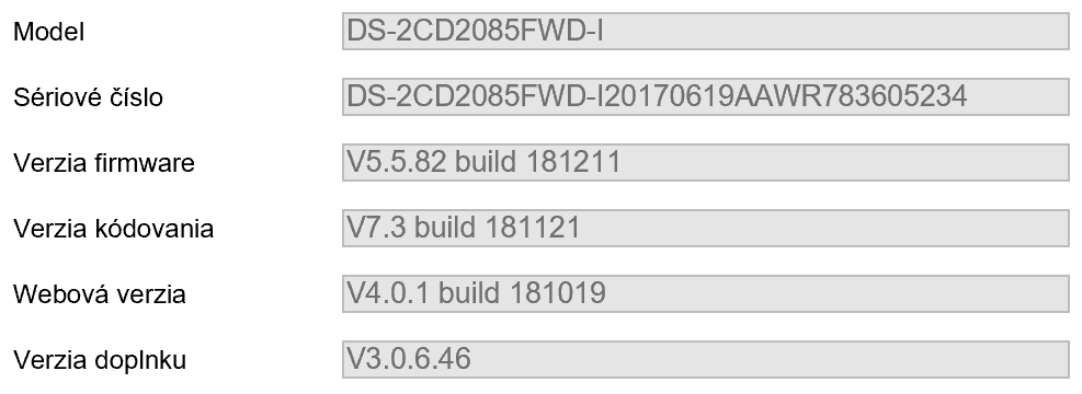

O OndrejL Member Messages 11 Points 1 Feb 21, 2019 Thread starter #3 ofcourse i am using IE. version 11.316. 7763.0 version of camera firware: 5.5.82 181211 Attachments ie.PNG 21.6 KB · Views: 601 ver.PNG 20.2 KB · Views: 615
Phil Administrator Staff member Messages 5,195 Points 113 Feb 21, 2019 #4 I can see that you are now running V5.5.82, are you still having a problems changing resolution or selecting a CODEC?

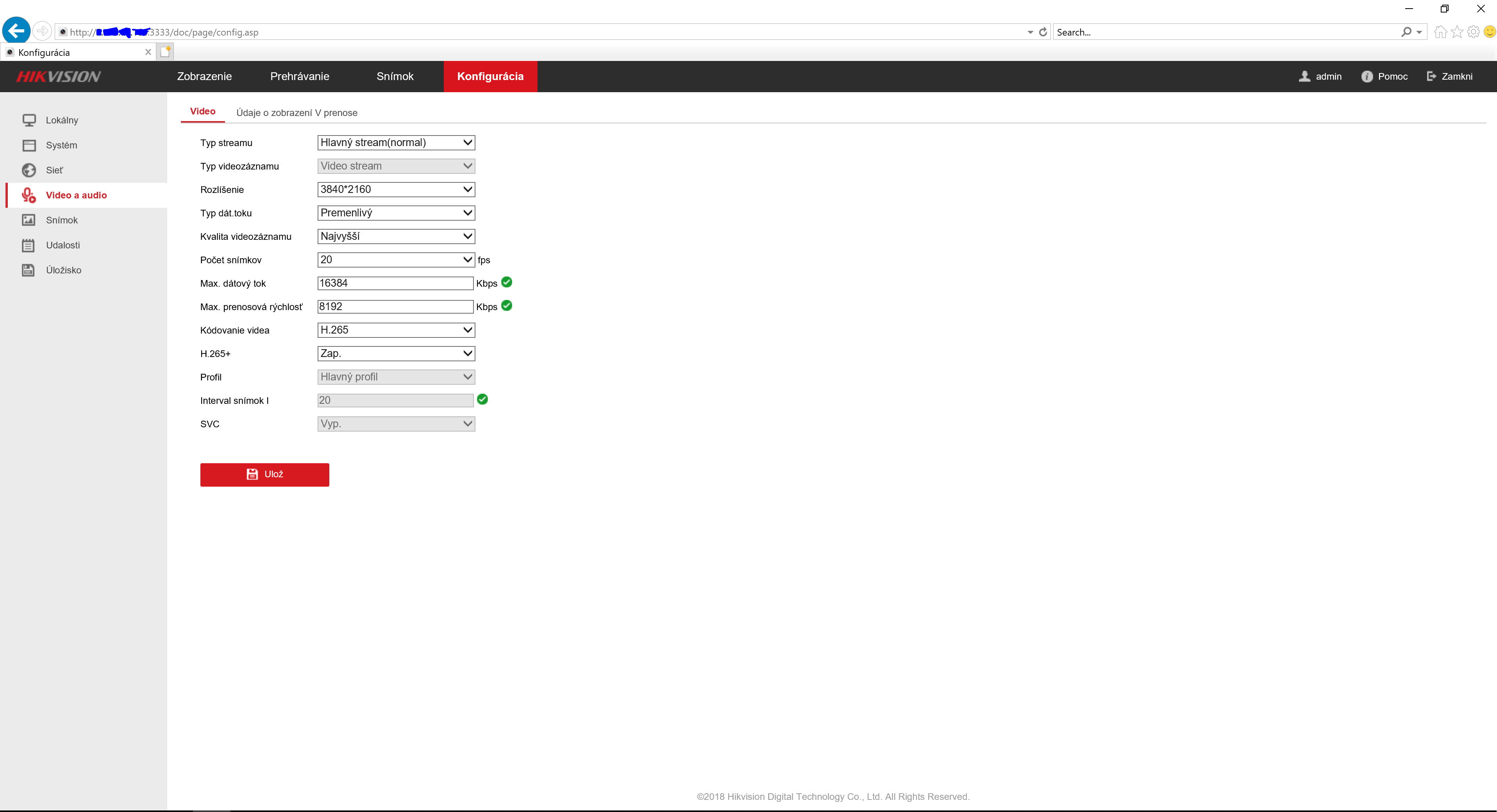

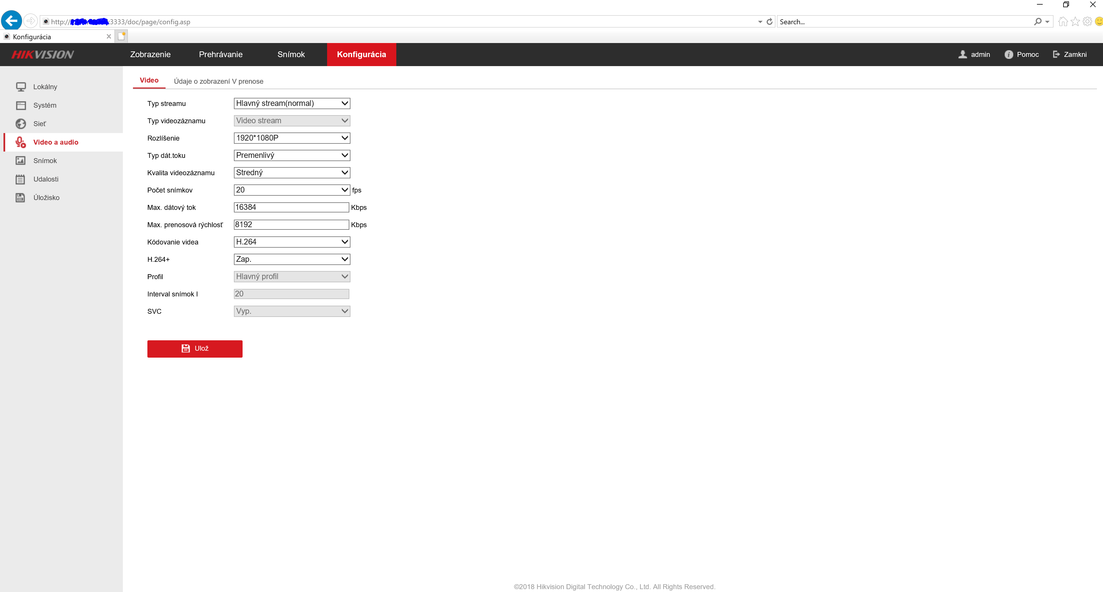

O OndrejL Member Messages 11 Points 1 Feb 21, 2019 Thread starter #12 config page before and after Attachments config.PNG 144.1 KB · Views: 1,056 config2.PNG 131.4 KB · Views: 900
Phil Administrator Staff member Messages 5,195 Points 113 Feb 21, 2019 #13 Is your camera perhaps connected to an NVR that cannot work with those higher settings? Are other changes that you make being saved OK?
O OndrejL Member Messages 11 Points 1 Feb 21, 2019 Thread starter #14 NVR is able to work with 4K. Sometimes it save setting correctly, most of times not
