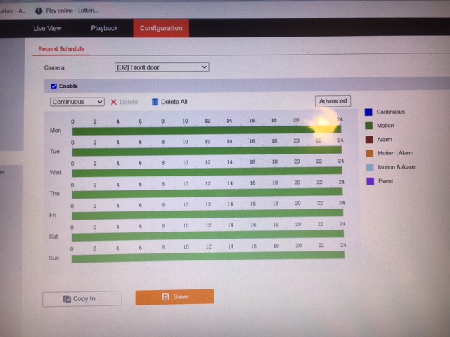

We got a new Hikvision security system a few months ago and after setting it up I would do random checks every time someone would leave or enter the house to make sure that it was picking them up. On two different occasions I noticed that it did not record when someone entered the house. I thought ok this is weird but today after doing a random check I noticed that it did it again. What could be the reason for this? 99% percent of the time it works....

Have you tried adjusting the threshold and sensitivity settings?
what camera / NVR are you using?
I just put the sensitivity up to 60 from 40. I am not home right now and will look at the model numbers and post later. Thank you.
i had exactly the same. I have just installed a camera and wanted to see how clear the Amazon delivery drivers face was so i checked the replay and dragged the recording to the time. One frame the front door step is empty the next the parcel is there but no delivery driver leaving it. I did find in a setting somewhere something about recording 5s before and after and i think when watching it in event mode it seems to skip around the event marker. When i let it run in normal playback mode the delivery chap was on it so i think its either dragging the pointer jumps it too many frames or there is something to do with event mode recording/settings.
it took me a while to optimise my intrusion detection settings, the postman helped a lot. On my security cameras I record continuously to NVR and intrusion detection events to internal SD card.
Here is my NVR ERI-K104-P4. Firmware V.3.4.100_190222
I put my sensitivity up to 60 for the camera and now it is recording events every two minutes. I was wondering if I kept it at 40 and put an intrusion line would this be possible? Can I do that with this NVR?

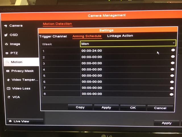

This is a picture of the setting. Not sure what to do with the arming schedule or what it does.
