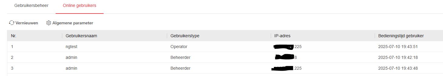

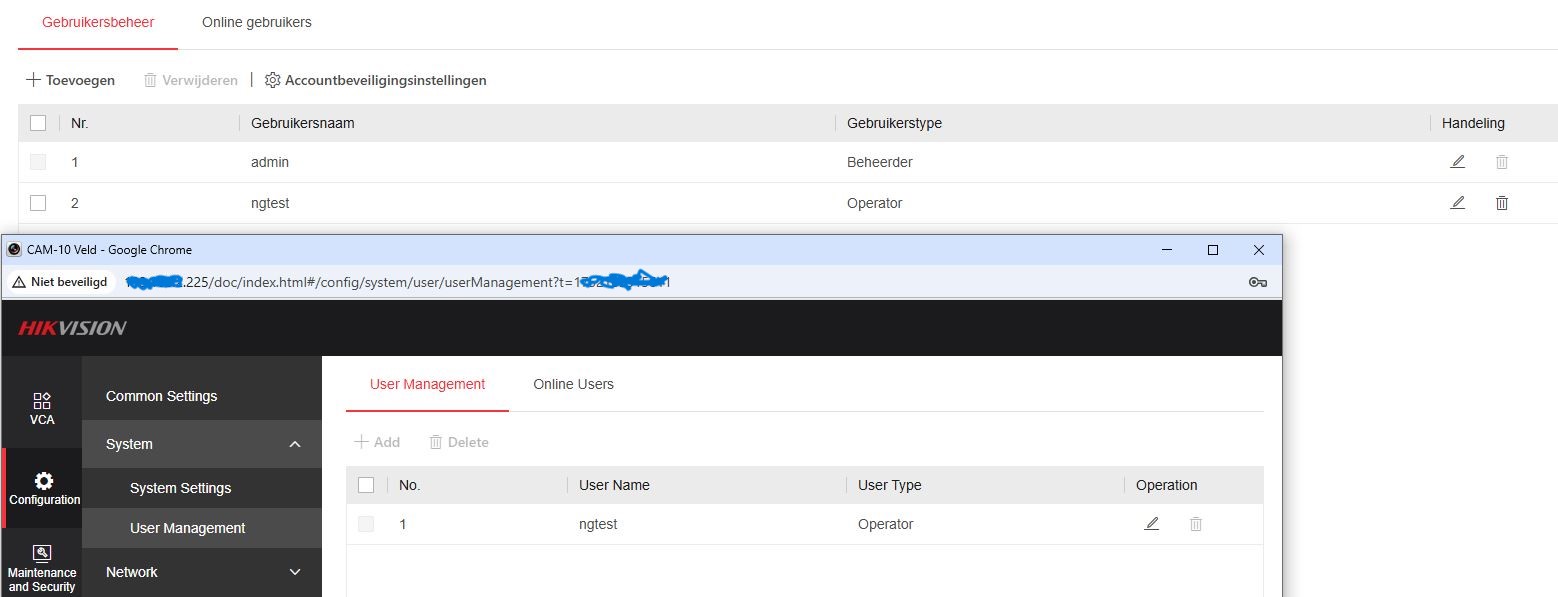

Here are some screenshots (some in dutch) but you can see whats happening. The users also pops-up in the online user list from the camera itself.
The front windows is the pop-up window when you manage a the camera from the NVR (it's the camera that you manage) .255 is the IP of the NVR, The window behind it (dutch) is the webinterface directly from the camera itself, showing the created users and the local admin.
This is the online users list when accessing the camera directly, it is showing the "ngtest" user as "online".

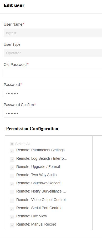

These are the permissions the user has on the camera itself:
I find this disturbing and cannot find any documentation of this "feauture". This shouldn't happen and in my opinion is a security issue. Especially when the camera is accessible from the internet.
