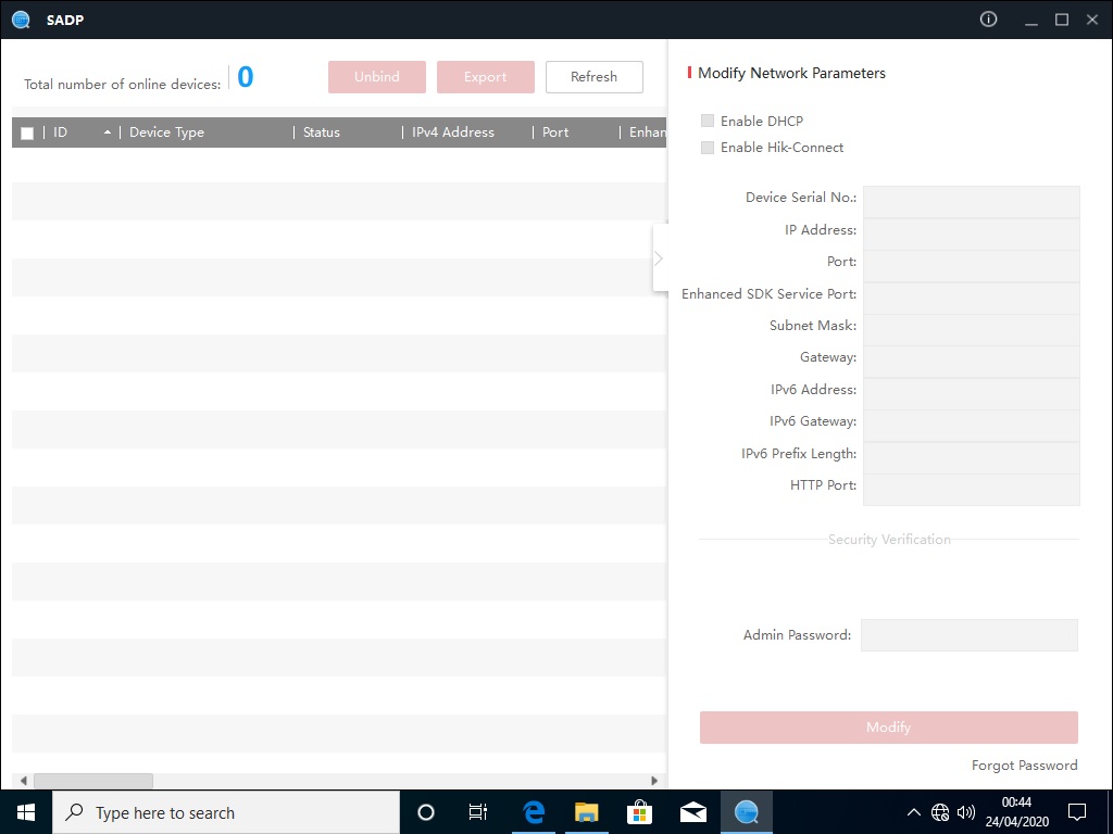

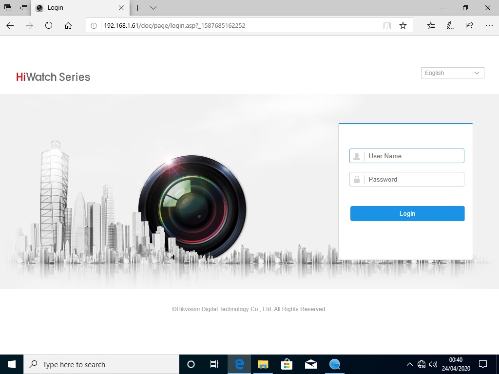

Hi Dan, of course, screenshot attached. However I think I now know where the problem lies. I don't like Windows but purchased Win10 solely to be able to use SADP ! BUT, I'm running it (Win10) as a virtual machine (via Oracle VirtualBox) under Linux (Ubuntu 18.04.4 LTS) so even though I can access the camera at IP address 198-162-1-61 from Win10, SADP is not looking any further than the local Windows IP address 10-0-2-15 ? Any suggestions other than installing Win10 on a separate boot-able disk ? While I have your attention I have one further question - when I get SADP to work and create a password change request file for the retailer to send to Hikvision, do I have the leave the camera, computer and SADP running until Hik / Retailer responds with a reset file ?

Hi @Photon,
We have seen a similar issue of SADP not reaching outside a network for users on Macs, the solution most often in those situations is to open your PCs security software and add the SADP software to the safe applications list and make sure it is given permission to receive and send information through the PCs firewall, that way you should then see all devices on the local network listed in the SADP Tool.
SADP Tool works in Windows 10 emulation for me (Parallels Desktop running on a Mac) without any tweaks. The only problem I had was described at #3 above - it doesn't work if iVMS-4200 is already displaying the online devices so quit iVMS-4200 or disable it from displaying the bottom half of its management window.
