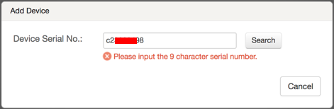

They are case sensitive i.e. if your nine-digit code includes a capital letter - you must enter a capital letter.
If you do not HikConnect will return this error message:
"Please input the 9 character serial number"

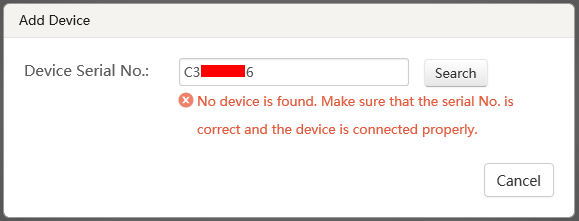

BTW - if you see the below error message and are sure that you have entered the serial number correctly, then HikConnect is actually informing you that it cannot find your device online.

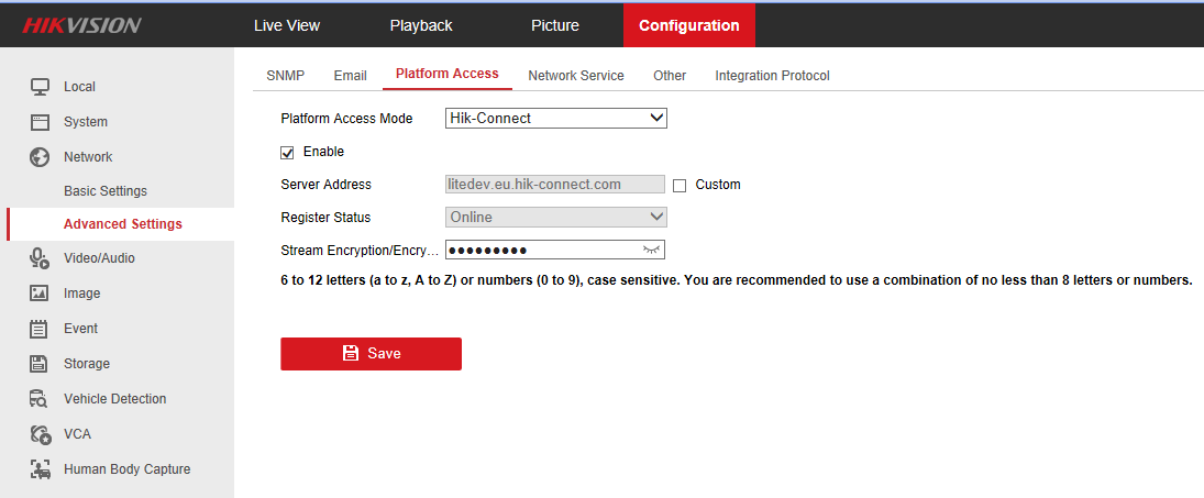

This is commonly due to either Platform Access for HikConnect not being enabled, or the other favourite is that the Network DNS settings for your device to use have not been entered.
"No device is found. Make sure that the serial No. is correct and the device is connected properly."
Platform Access should be enabled and look like this:

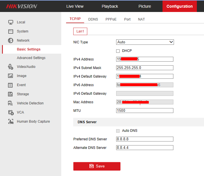

Your DNS settings can be safely set to Google's DNS servers, as per the last two fields in the image below:

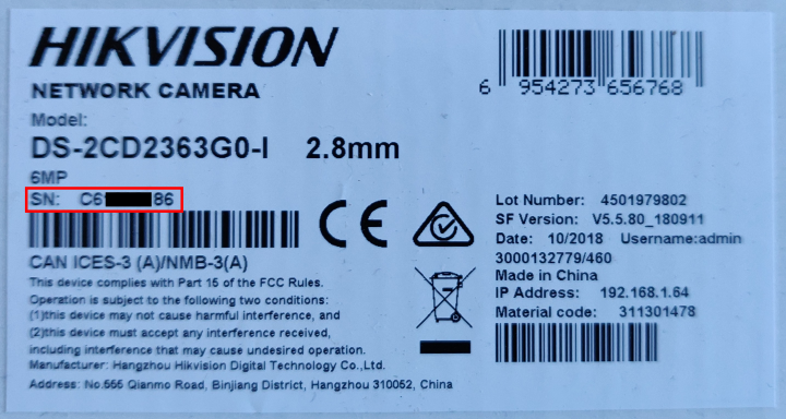

Here's a typical Hikvision product label showing the serial number:

hi i have taken the sticker with the sn on it of of the camera and i never had a box because i bought it used on ebay i have found the long serial code but i dont know how to find the short one could u help
Hi @prince_992636
If you install the Hikvision SADP Tool on a PC on the same local network as the HiLook device you should be able to see the details (including the S/N) of all the Hikvision/HiLook devices on your network.
