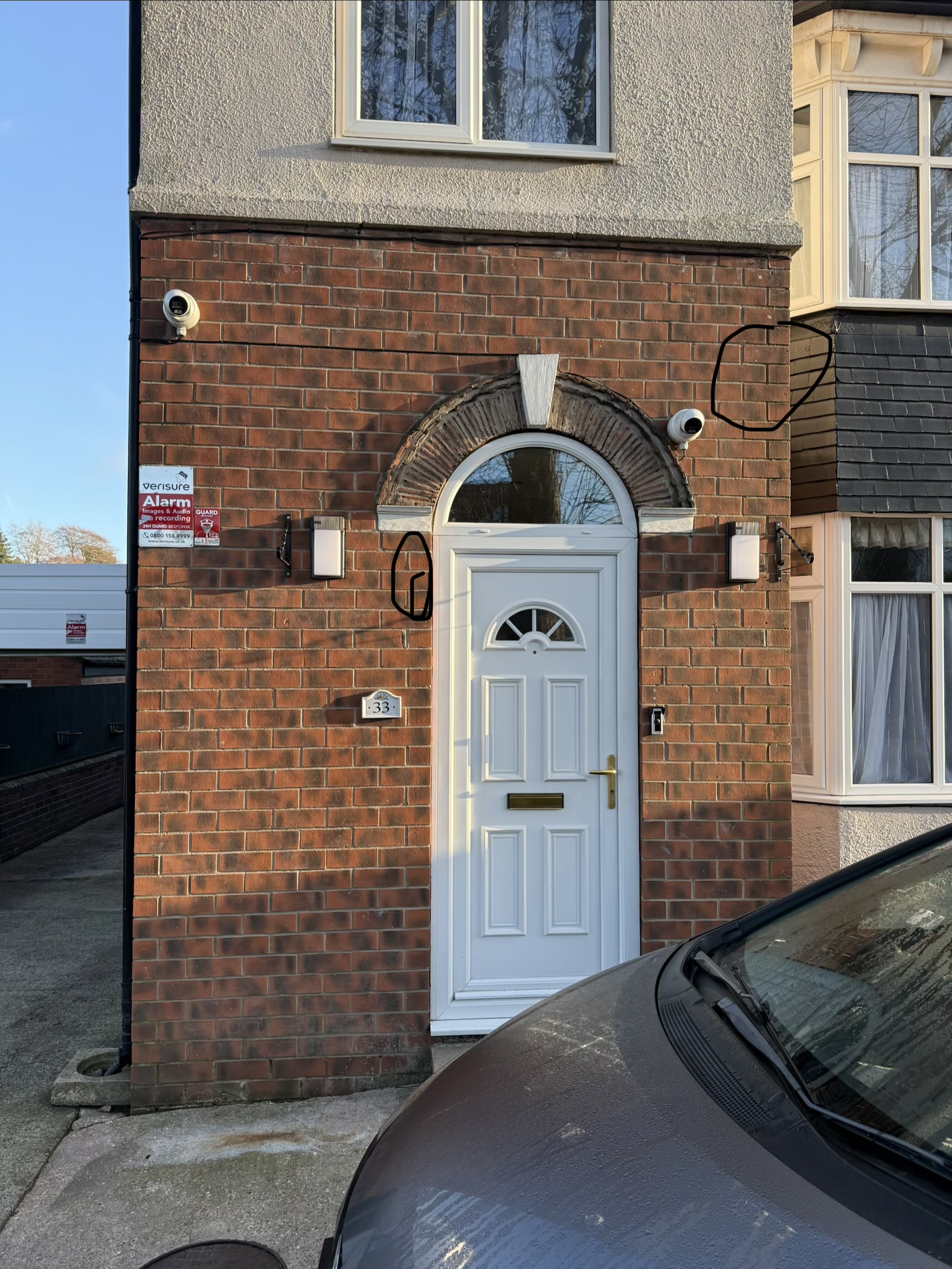

If you don’t mind I’ve attached a pic of my current camera set up at the front door. The low down camera on the right I had intended for it to focus on the front door. In reality it’s too high and probably the wrong focal lens im therefore mostly getting tops of heads. Or an image in one specific part in relation to the front door.
I’m thinking to change this per the picture attached and put the cameras where the circles are. Do you think it will work?

When you're so close to the front door you shouldn't need a vari-focal; it's the one time I'd usually use a 2.8mm over a 4mm.
One thing regarding your installation...If you're mounting directly to brickwork like you have there, remove and throw away the big ugly compression gland from the bottom, replacing it with the blank that's in the back of the box. If you then mount the box so that it's over a horizontal mortar line, it's usually concave enough for the CAT5E to pass behind the box without squishing it. If not you can just scrape a little mortar out under the box - it looks neater.

Thanks a lot as always for the advice. Yes il do that. I’m in the process of getting it redone.
Regarding the front door camera where I have it now it’s a 2.8mm and people see far away. That was my thinking for going varifocal.
I also plan to lower it so I capture faces as people come on tk my property

I meant to say with the current 2.8mm people seem far away. To get good detail you have to zoom in but because it’s digital zoom the quality gets lost
That's just lens perspective. Wide angle lenses will make objects appear smaller and more distant to one another whereas a narrower angle will compress that perspective. If you're installing a camera and want to see a person fully when stood at your door you need a 2.8mm lens. The side effect is that they'll look tiny at the edge of the driveway. There's nothing you can do about that. If you get a varifocal, you'll probably end up using it fully wide so it'll be a waste.

2.8mm is what I’ll go for then.
I plan to have 2 cameras high up that will give me a full view of the drive.
In terms of a front door camera, how high do you recommend mounting them? I’m not that bothered if it could be tampered with. Should that happen I’ve got the other 2 cameras watching

2.8mm is what you'll likely need for the front door if you're wanting to see someone stood at the door.
Those wouldn't need to be 2.8mm. A 4mm gives a 95 degree horizontal field of view so will capture everything. Perhaps consider a vari-focal there if you're wanting to see something larger in view (at the expense of 'a full view'). A wide view you're going to capture everything but it's going to look small. A narrow view you're going to see things larger but you're not going to see it all (decide what you need)
Wherever suits, probably about 8'. You don't want the camera to be looking straight out without any tilt. If you get the sky in view you'll have times of day when glare will cause issues indoor image. You may be restricted by the position of your lights as they could cause glare if they're in the cameras view.

Thank you so much for all the advice. Do you mind just telling me if my plan of action is good.
I’ve scrapped the idea of a varifocal following your advice I think it’s not needed.
1. Top left camera mounted 9 feet from the ground using a 2.8mm lens. Angled slightly down and to the left as you look at it. It will record that part of my drive plus any intruders approaching from the left side.
2. Top right camera exactly the same as the top left but angled slightly down and right watching the right hand side of the drive and approach tk my house.
3. Low down 7 foot from the ground again 2.8mm. Right where the left hand light is. That light is only used if we are at home and people are coming in and out so not worried about the glare. I want this camera to give me clear identification of a person as soon as they are on my drive and at my door. Yes I’ve got a ring doorbell but as you know they’re rubbish and at night the video quality is terrible. With it being 7foot from the ground I should be able to angle it down slightly to eliminate the sky and any glare caused by sun etc.
I’d be so grateful if you think this is a sound plan. The current position of the low down camera on the right at the moment is neither here or there. You don’t see people when they are right at the door, their head is cut off when the approach the drive. So there’s only a split second in between the front door and drive that you get identification. Other than that it’s either top of the head or cut off

I'd only use a 2.8mm for the one that is to cover who is at the door to get them in full view. Any others I'd be using 4mm (as that still provides a wide horizontal viewing angle of about 95 degrees). Your best bet would be to temporarily connect a camera on a long flying lead and bring up the view in Hik-Connect on your phone. That'll ensure that your intended mounting positions can provide the views you want - anything else is just a best guess...
