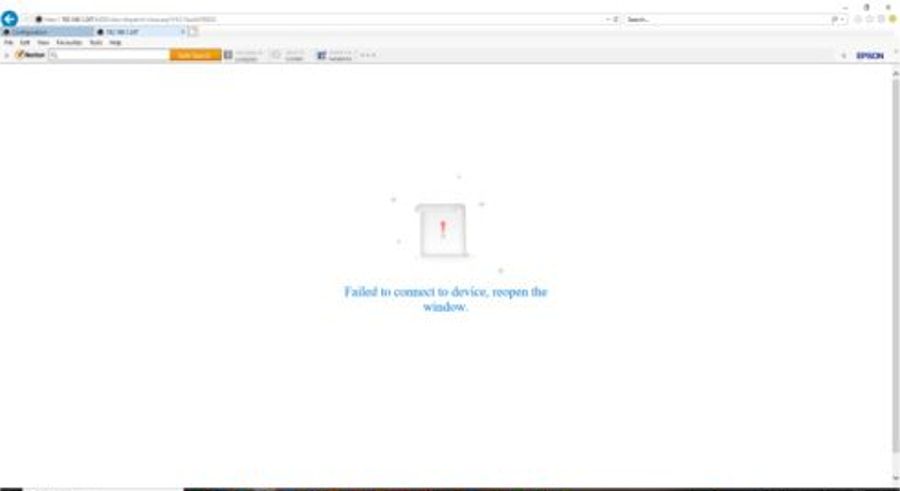

Maybe I have found a bug.
With the old front end, you could go into Camera Management and on the far right, link directly into that camera to alter / adjust its setting etc.
Well the new front end offers the same, but out of my 5 cameras, 3 of the links fail, they open a new browser page but show the result as 'Failed to connect to device, reopen the window.' instead of the 'Log In' page.
With the pages which do work, the address in the browser is: http://192.168.1.247:65004/doc/page/login.asp?_1636415704583
The ones which don't show:
_http://192.168.1.247:65002/doc/dispatch/close.asp?V4.0.1build180905
_http://192.168.1.247:65003/doc/dispatch/close.asp?V4.0.1build180905
_http://192.168.1.247:65005/doc/dispatch/close.asp?V4.0.1build190820
I think I'll unplug the cameras in the morning and plug them in again to see if that changes anything.

Just worked something out.
If I take this address which doesn't work _http://192.168.1.247:65005/doc/dispatch/close.asp?V4.0.1build190820 and delete everything after doc/ and then replace the deleted with 'page/login.asp?' it works.
So the question is, Why is the program in the browser rendering an incorrect link?
Sorted, don't know how, but I did reset the NVR back to factory default and upgraded the 5 camera's to the latest firmware.

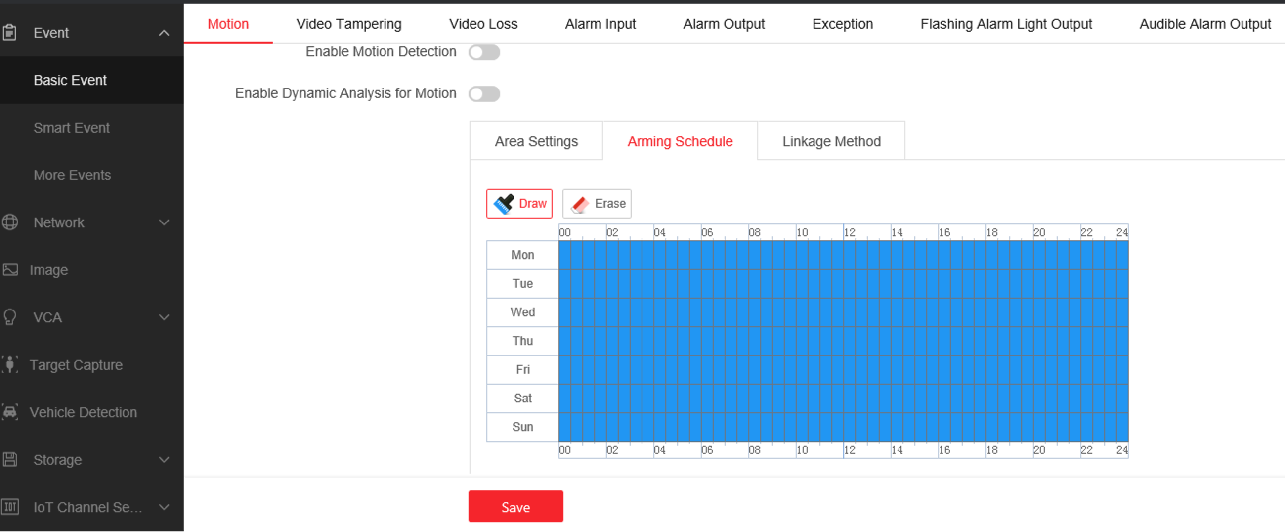

I think I've found something else which seems to have changed for the worse.
With the old front end, if I were to set up say, Motion Detection under Configuration / Event I'd draw the area in squares and then set the 'Arming Schedule'
In the old version, on the right hand side you'd have various colours to choose from, from memory, Blue was 'Continuous', Green was 'Motion' and then there were other colours for different actions, and you'd set the colour side to match the times you wished the event to be active.
On the new version, all these colour options are not present and the only option is 'blue' and therefore continuous. Now whilst I've lowered the 'sensitivity' of my motion detection, I've found that it is capturing 'what it sees' 24/7 whether there is motion or not.
I just can't find a way of setting it like I could with the old version.
I've tried this under the 'main' front end and under 'camera management'
The motion detection schedule setting was always like. You're just setting when you want that detection to be active as below

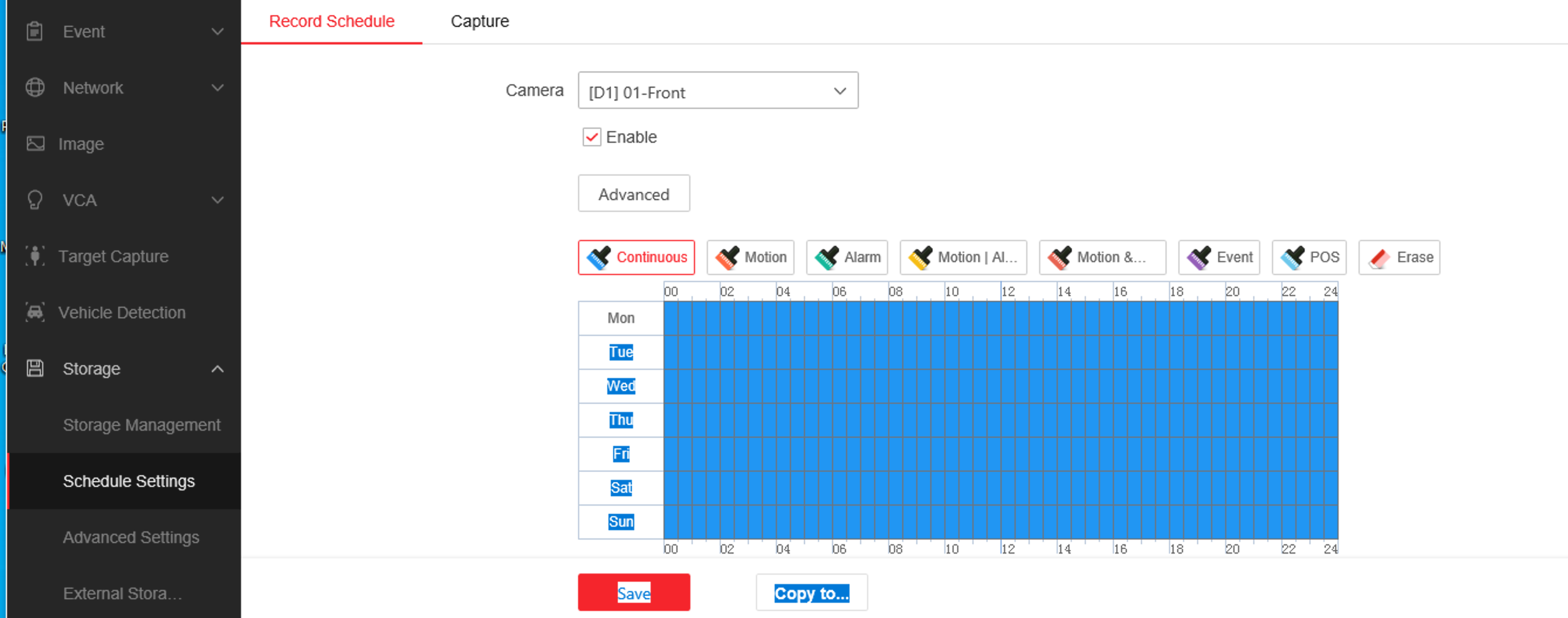

I think you may be thinking of the Storage schedule. There you can determine whether you want recording to be continuous, motion only, event etc and it's colour coded the way you have described, as below:
Thanks JB1970, I was looking for the 'advanced' menu. Under the old interface I'm sure it was on the same page as your first image and there was an 'advanced' button on the same page.
As you've demonstrated, the advance menu has be relocated as a 'sub' menu of the storage menu.
thank you for your help, I couldn't see it for looking.
