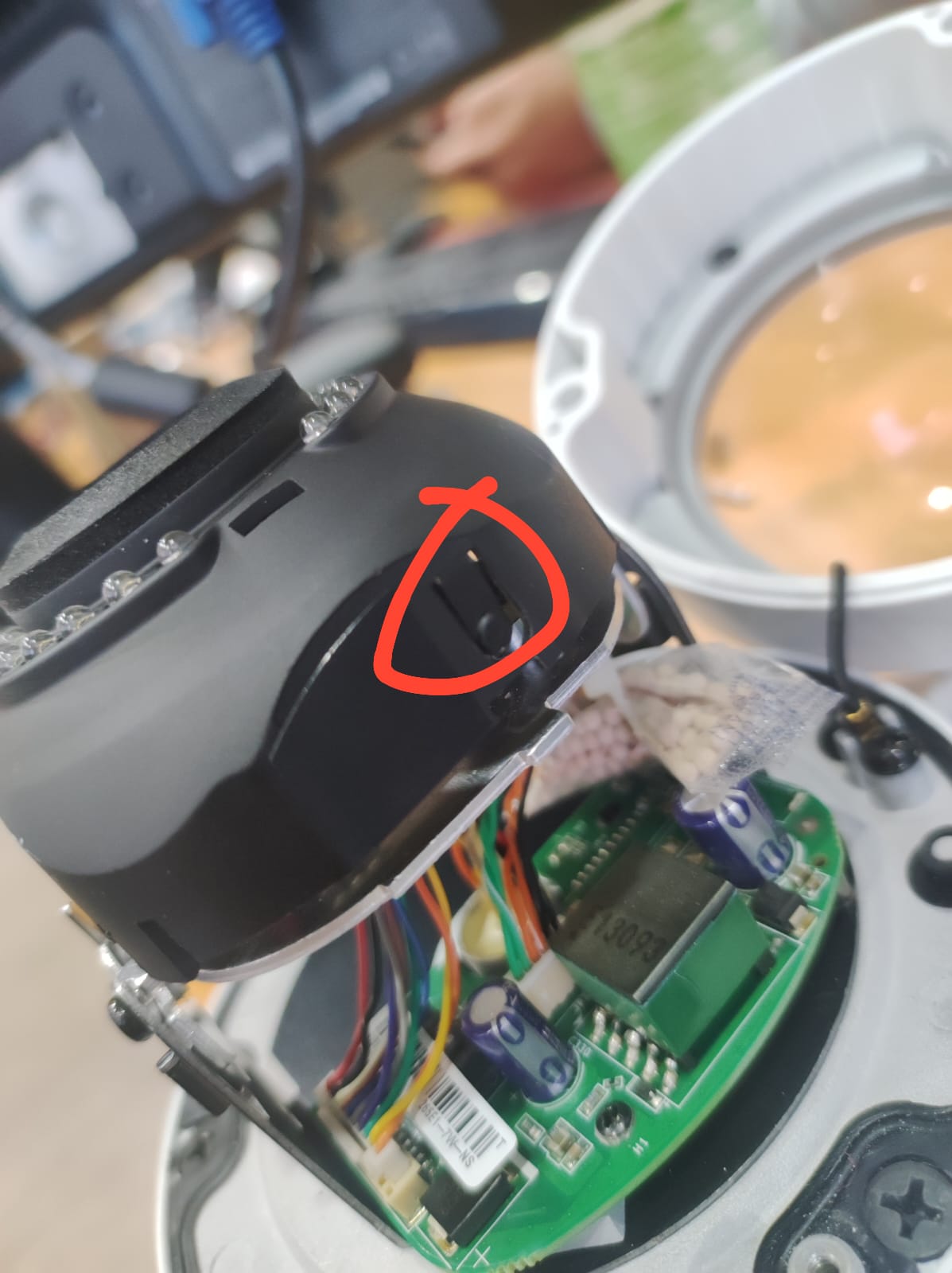

Hi, im trying reset my camera HiLooK d120h but it havent the button that do this.
There is a puslator but this not connect or press with anything

Hi @Protevis
Unfortunately, some older Hikvision models and some of the cheap HiLook/HiWatch models do not support a physical reset button.
The only way to reset the camera would be to do a password reset using SADP, this will require you to send a password reset file to the authorised HiLook seller you purchased the camera from.
