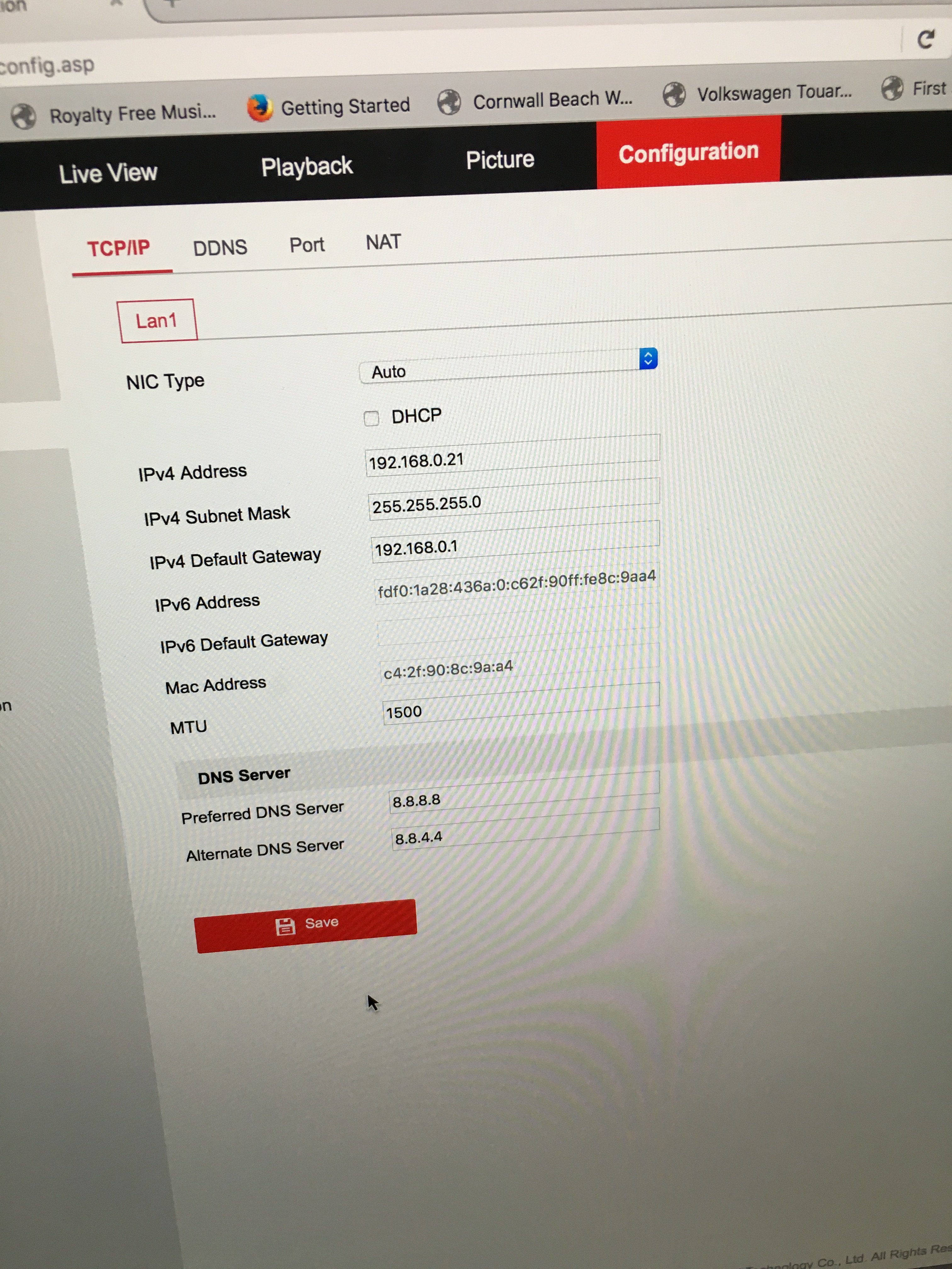

First of all, login to your Hikvision camera via a web browser using its LAN IP and navigate to Configuration > Advanced Configuration > Network > TCP/IP tab. Ensure that you have set a correct Preferred DNS Server. Failure to do so will mean that EZVIZ will not work correctly. We like to recommend Google's DNS server of 8.8.8.8
There's no harm in adding Google's secondary DNS server 8.8.4.4 in the Alternate field below, too.

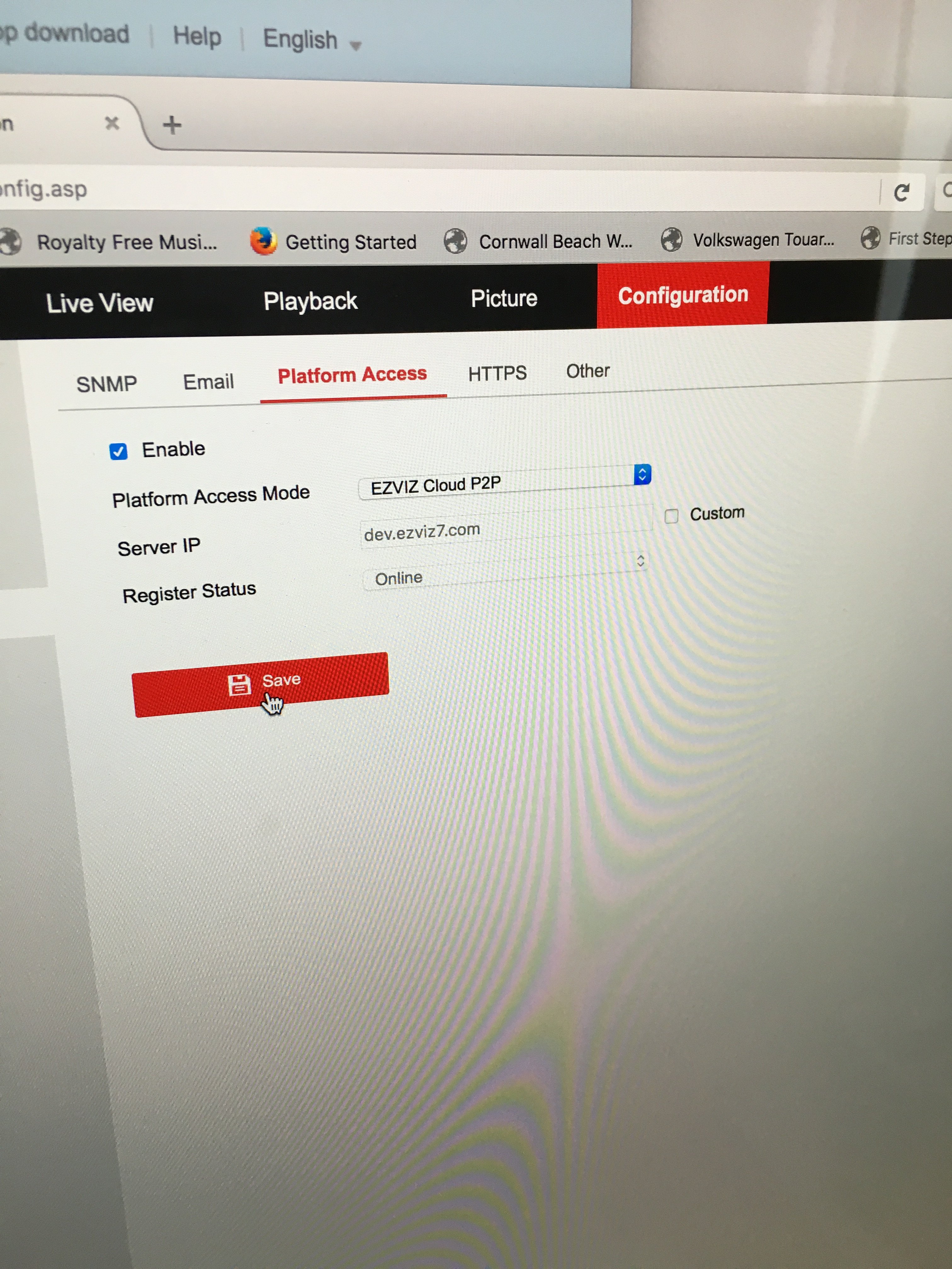

As of Q1 2016, EZVIZ Cloud P2P is being renamed to Hik Cloud P2P within Hikvision's camera / NVR / iVMS 4200 configuration options. Other than the name, nothing else has been changed regarding EZVIZ functionality.

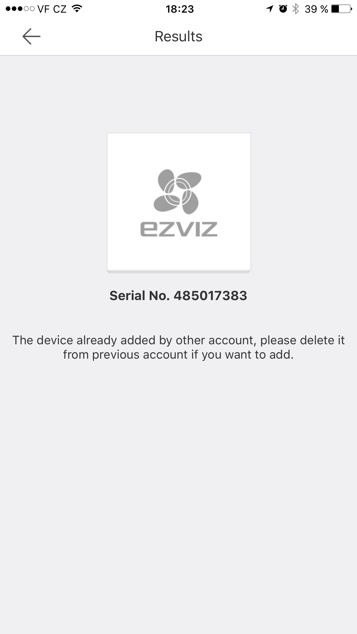

Otherwise, you'll have to add it manually by clicking the Add by Serial No. tab and inputting the serial number of the camera. This can be found using SADP to display it, by navigating to the System Information tab within the camera's web access or by reading the label attached to the camera.
Once you've done this, the following window will appear asking you for a device verification code. On more recently manufactured models of Hikvision cameras, this can be found on the label stuck to the camera which you'd enter in the field shown. However, most existing cameras were not manufactured with a verification code on the label, in which case you'd need to input the default code of ABCDEF.
