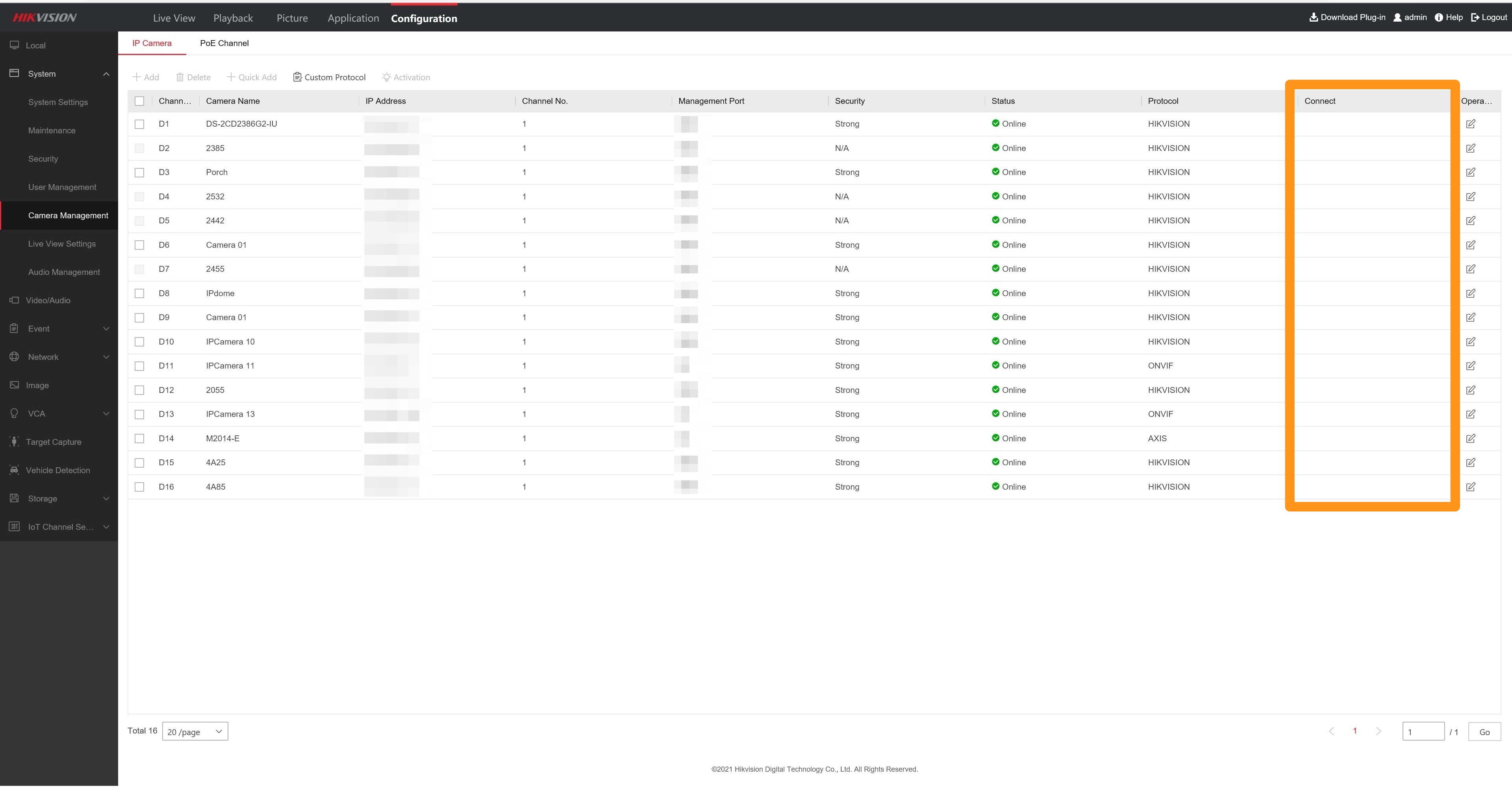

Configuration System Camera Management
This screen displays all the connected cameras on your NVR. Notice that the final column labelled "Connect" is currently empty. We'll be coming back here in a moment.

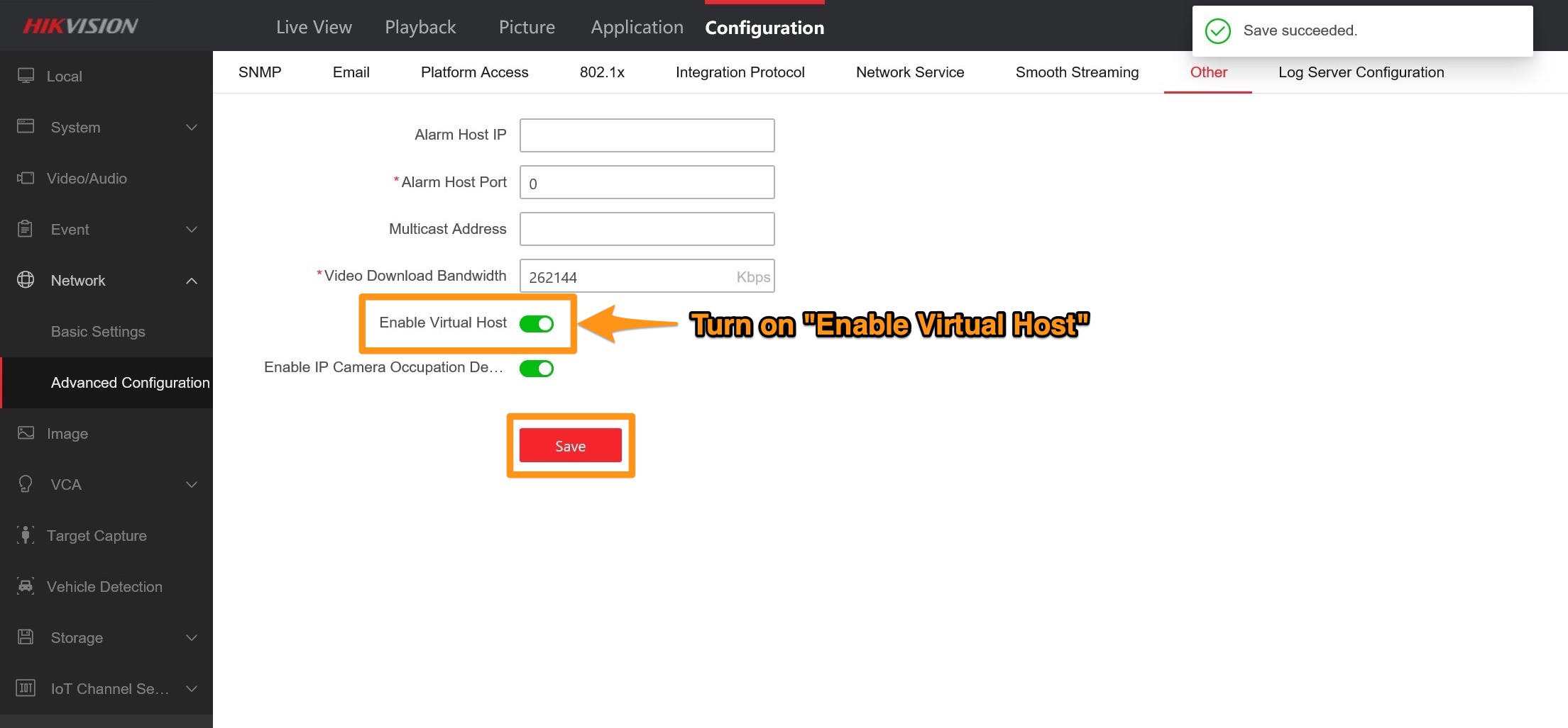

Network Advanced Settings Other
Turn on the Enable Virtual Host option.
Note - Your NVR will reboot when you click "Save".

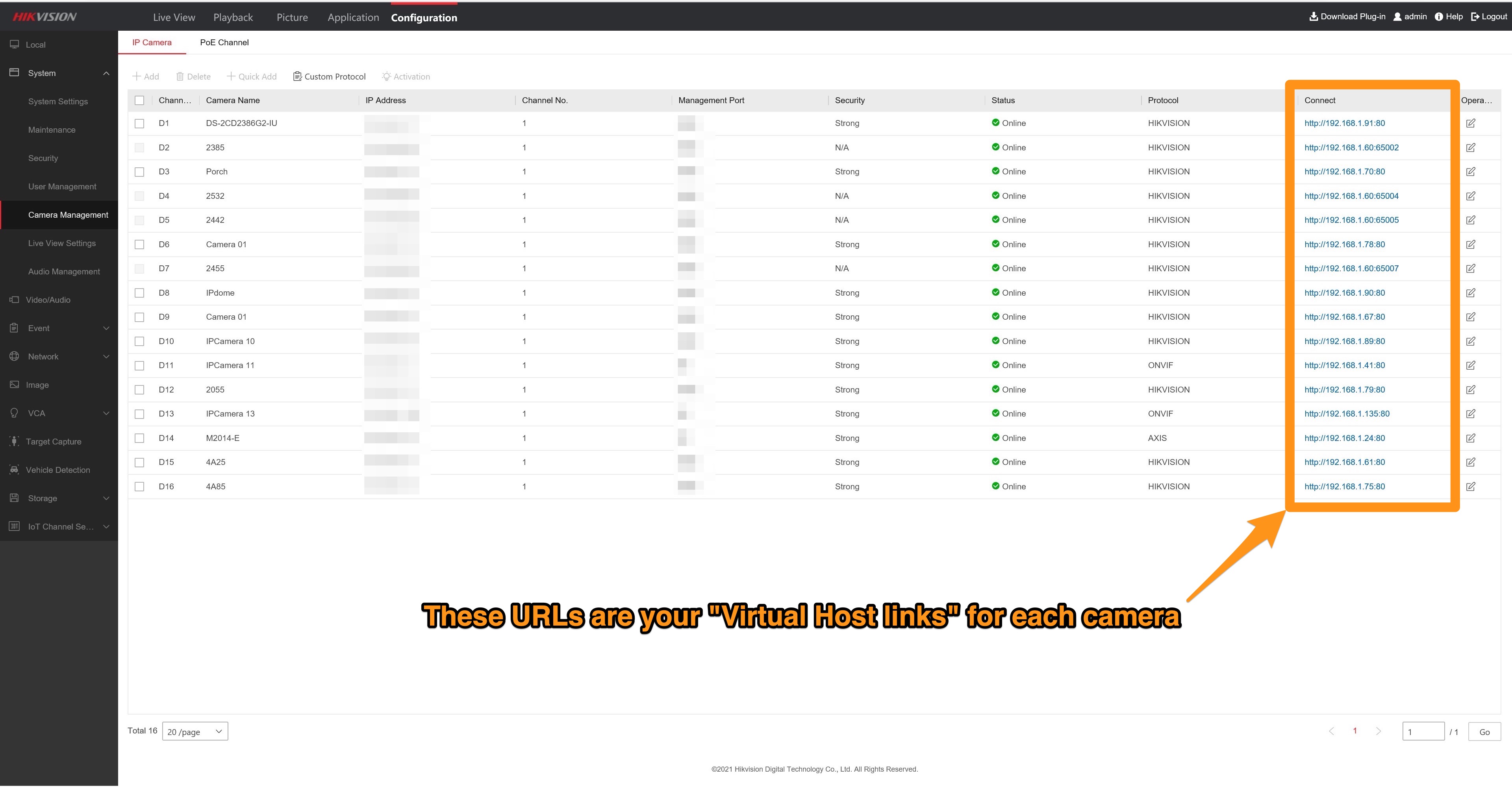

Step 4:
Now, navigate back to the Camera Management window from earlier. You'll notice that the previously empty connect tab now features links for each camera currently connected to your NVR.​

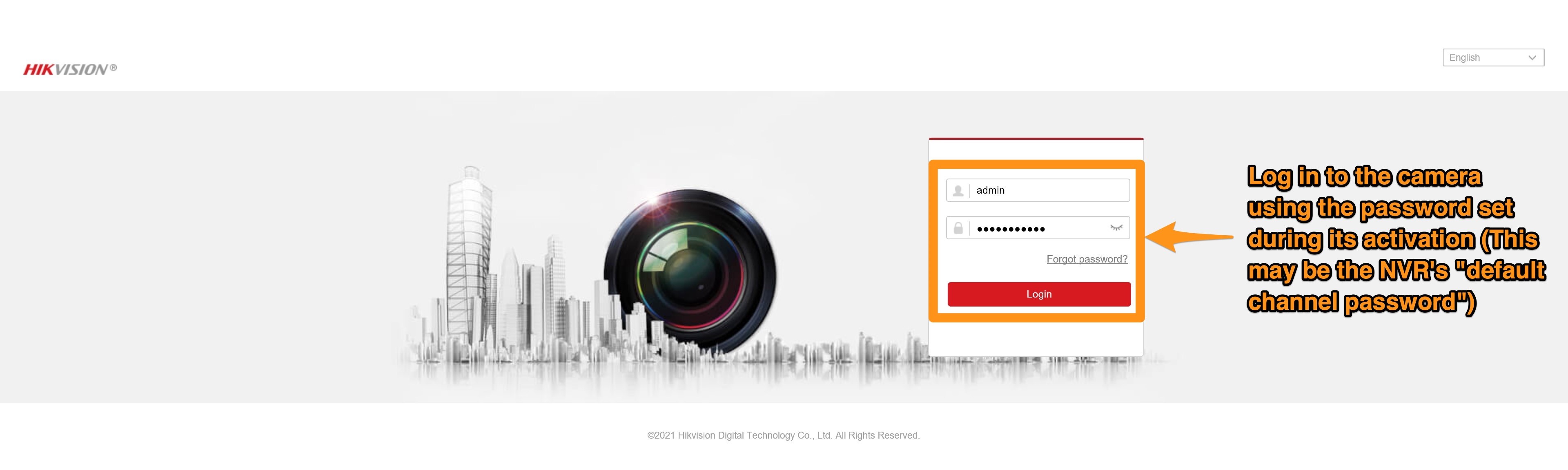

Step 5:​
Click on any of these links to access the respective camera via your web browser:​

My problem is that I just plugged the unconfigured IP cameras into the NVR. They work nicely, but I can't reach them via virtual host, since their password was automatically set by the NVR. Is there any way to configure these cameras without resetting them to factory defaults? My cameras are Hikvision 2CD2020-F, the NVR is DS-7604NI. Could you help me please?
If your NVR sets a camera's password it merely passes-on / shares its own i.e. the camera's password will be the SAME as the NVR's password.

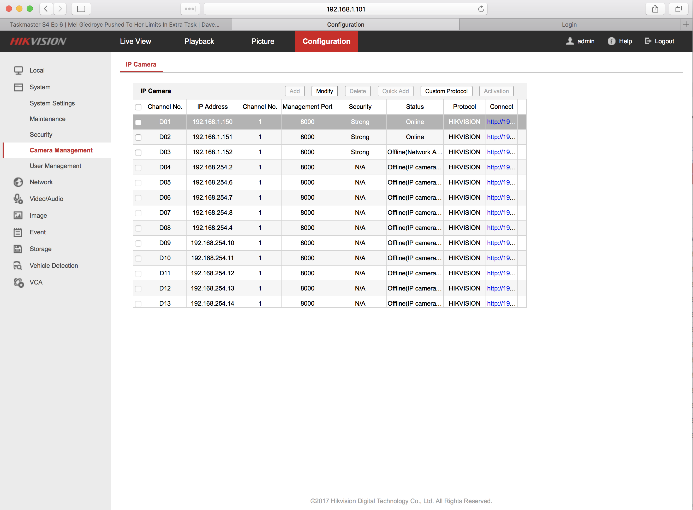

Question re: NVR DS-7608NI-E2/8P/A (v3.4.96 build 170921) interface on OSX 10.13
I have set up virtual host. Trying to view camera(s) IP & port on Configuration/System/Camera Management.

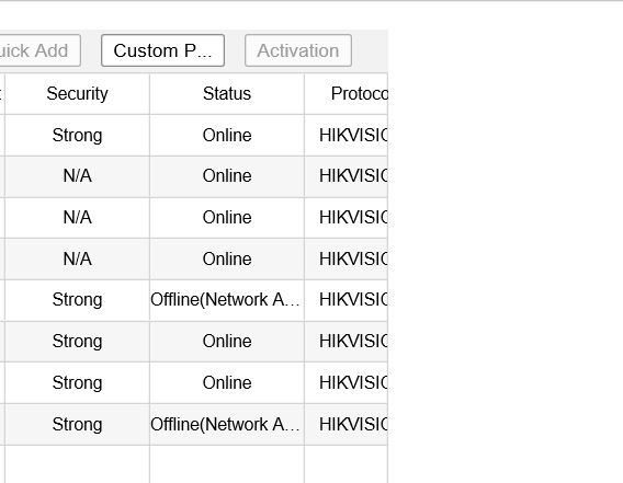

Unfortunately, the viewable columns in the table finish half way through the Protocal column on the RHS. Any ideas on how I can access a wider view of the table to show the column with the IPs and ports? There are no handles to drag the table.
Kind regards
Alan
Do you mean this view?
I'm afraid it always looks like this, but you should be able to click the hyperlink in the right-hand 'Connect' column to open a new tab in you browser and access the camera and its setting.

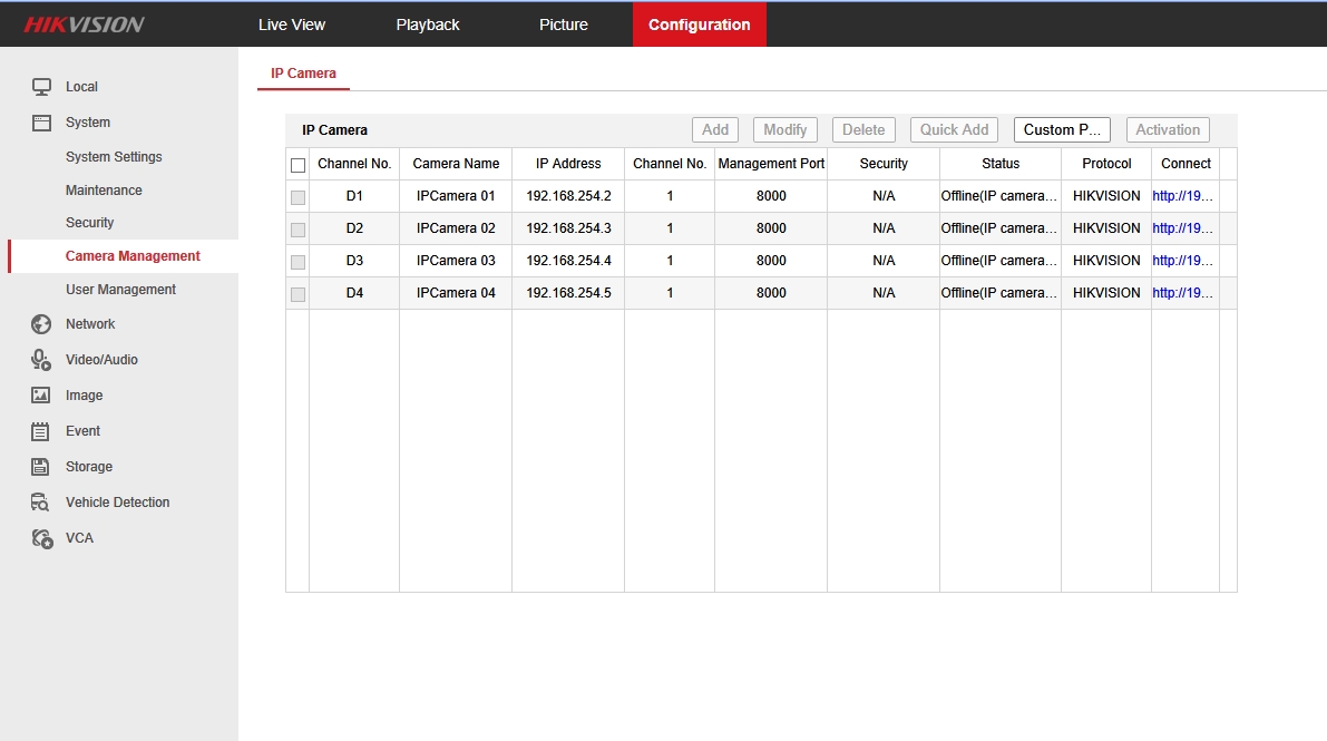

Hi everyone
I have the same issue. I cant see a connection column.
How did you correct this please?
As a work around, I did CTRL A to select everything on the page, then pasted onto a word document and could see what you mean Phil23 by the NVR's ip address followed by the ports, 65001. 65002, 65003.
So i inputted this into IE address bar and can navigate to the cameras that way. Saved each camera to IE favourites.
