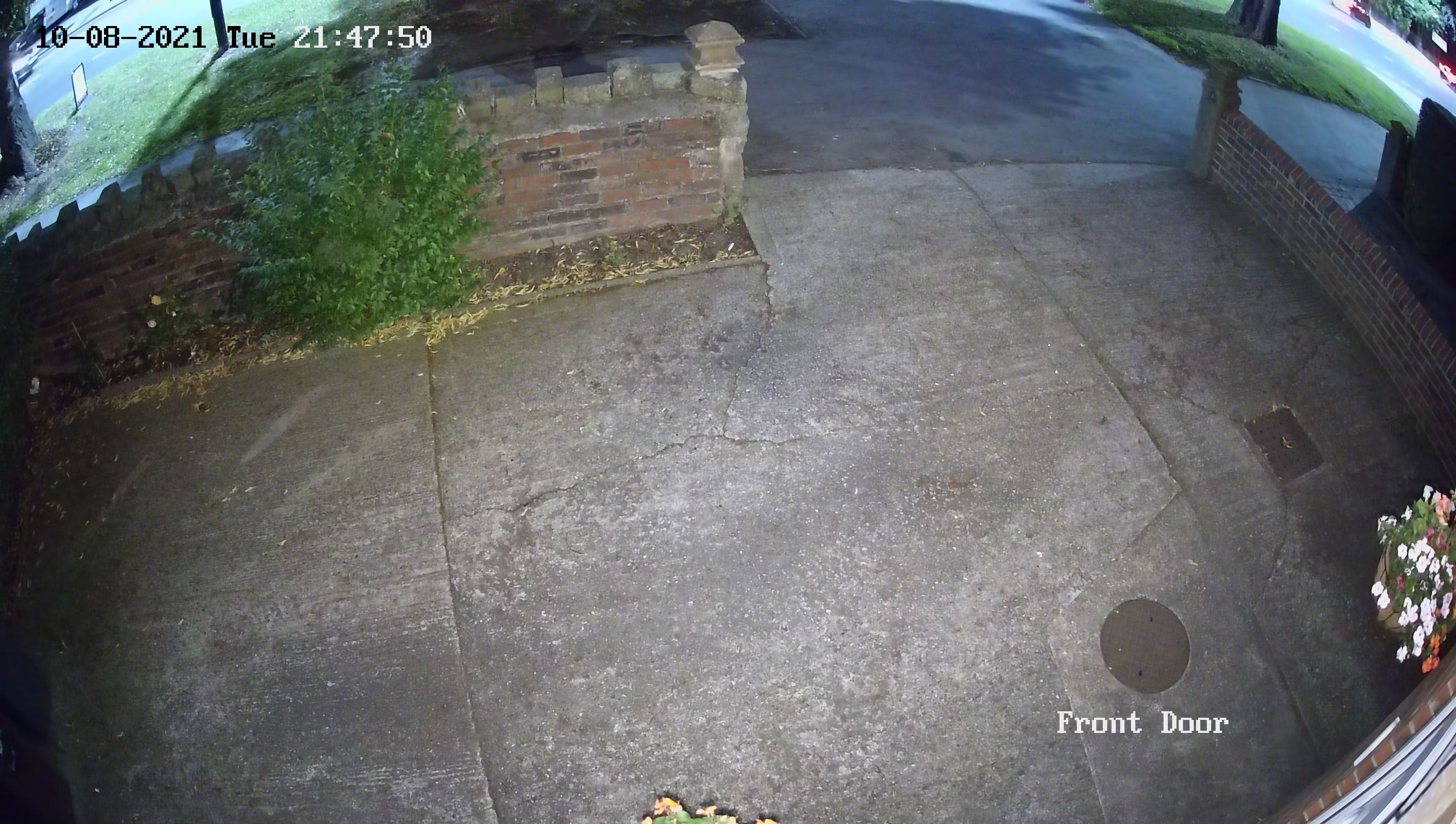

These are night shots. Is there anything you would suggest to improve the scene? Ideally any settings I change I would like to not adversely effect the day time footage
All the settings are default
Wdr off
Hlc off
Blc off
Contrast 50
Sharpness 50
Color 50
Dnr auto mode at 50
Exposure time 1/75
Color vu light is on at 50

I think the images look fine. Try playing with the contrast slider - drop it a little and see how it looks. Dropping the contrast usually lightens the shadow areas a bit but don't go too far or the daytime image will start to look washed out.
With regard to your other query regarding Auto WDR setting, I've not looked at that recently. I could be completely wrong in my interpretation of how it's supposed to work. In an ideal world (and in my opinion), when set to Auto the camera should analyse the scene for clipped bright or dark areas. It should then apply WDR and the effect should be capped at the level set with the slider. But it never worked that way. I found that if I set it to Auto and level 1 it would apply excessive WDR (equivalent to setting at about 50 in manual mode) and would negatively affect a previously faultless image.

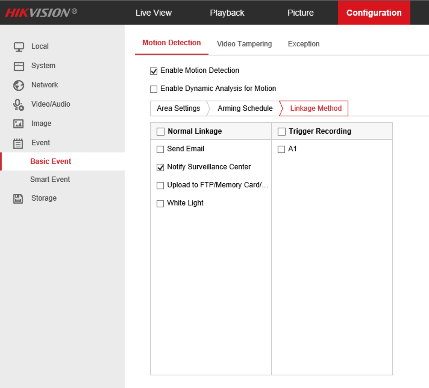

Thanks for all your help. I don't suppose you have a guide on how to set up the white light to only come on with motion
It's not something I've used, I have the white light disabled on mine. However, if you log in to the camera directly via virtual host there's an additional option to tick in the event "linkage method" that's not visible when configuring events from the NVR. You could try that - not sure if you set it to off elsewhere then tick that as an action it will bring it on.
@badayuni92 I can confirm it does work on the existing G2 ColorVu cameras that run G3 firmware (DS-2CD2347G2-LU - 5.5.160). As mentioned it needs to be set in the cameras own menu as it's not accessible from the NVR.
First in image settings you check that Smart Supplement Light is set to On AND Supplement Light Mode is set to Off. That disables the light coming on when it's dark but leaves it available for use on alarm.

Then you set the White Light option to On for your selected alarm in the trigger actions (I used line crossing in the below) and set the dwell time for the light to remain on after activation.
