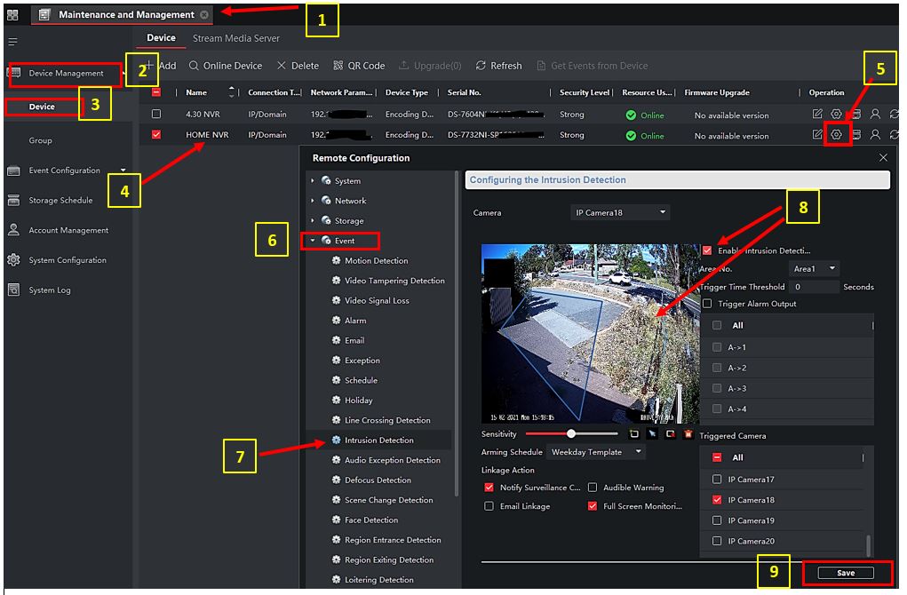

Follow the following instructions & See "Set Events via iVMS4200" Picture attached.
1. with iVMS4200 open & your device is added - choose the "Maintenance & Management" tab
2. Click "Device Management"
3. Click "Device"
4. Select your Device
5. Click the "Remote Configuration" icon
- Now you are accessing the settings of your device
6. Click "Event"
7. Choose the Event you want to Configure
8. Enable the Event & Configure the Event Settings
9. Click "Save"
- you have now Set an Event Parameter in your Device via iVMS4200
Exit/Close the "Remote Configuration" Window. The following Instructions & (pic) "Set Recording Schedule" of Device/Camera

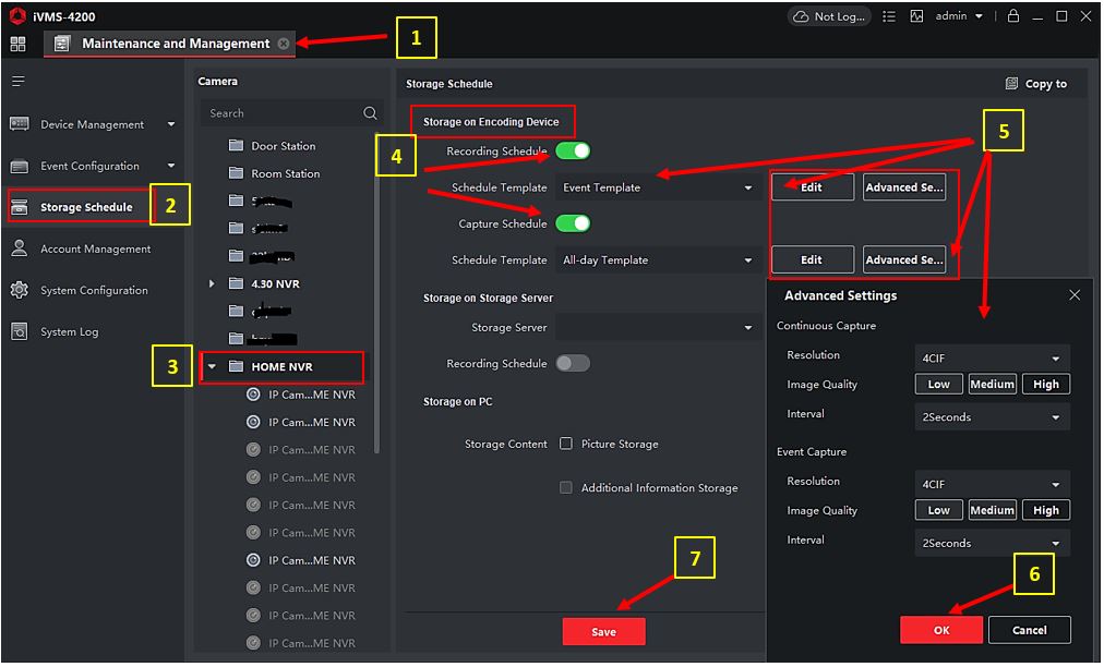

1. Remain in the "Maintenance & Management" tab
2. Click on "Storage Schedule" in left column
3. Choose the Device you want to set the Schedule to (or Camera)
4. Under "Storage on Encoding Device" (this example is an NVR) - Enable the "Schedule" Type.
- If you are not recording to a Storage Server or your PC, do not configure these settings or Disable them
5. "Edit" the Schedules (in this case "Event Template") including further settings under "Advanced Settings"
6. Click "OK" & the pop-up will close
7. Click "Save"
- Via iVMS4200 Settings, your Recordings will Record to the Device Storage (SD Card)

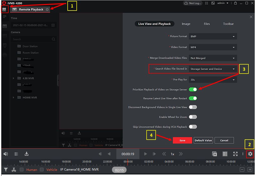

Like Wise to View Recordings. If accessing the Devices Recordings (SD Card) via iVMS4200, ensure iVMS4200 is Configured to Search the Device Recordings. See "Playback Location" pic & following instructions:
1. Click on the "Main Menu" icon & choose "Remote Playback"
2. Click on the Configuration Icon at the Bottom Right of Screen
3. in the Dropdown, Choose "Device" & Disable "Prioritize ...... Storage Server"
4. Click "Save" & Exit/Close the Configuration Window
- iVMS4200 is now Configured to Search the Device Storage for Recordings

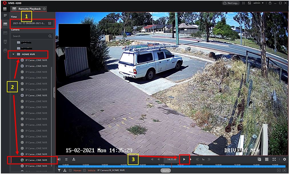

To playback Device Recordings, see "Remote Playback" pic & following:
1. Click the Calender Icon & Choose Date/Time you wish to Review
2. Choose the Device (or Camera)
3. Click the "Play" icon & the Recorded Video should appear.
- you are now viewing the Recording from your Device via iVMS4200

View attachment 5179View attachment 5180View attachment 5181View attachment 5182

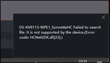

Thanks for these detailed instructions, although I'm afraid it's definitely not working for this specific model...
I go through the "Remote configuration" part without any problem, I can set up the recording schedule (although the "capture schedule" switch remains disabled for some reason). But when I reach the "Remote playback" part, I get the attached error.
I'd love to be proven wrong but it seems like the SD card of this doorbell is definitely not accessible (yet) through iVMS :-(
