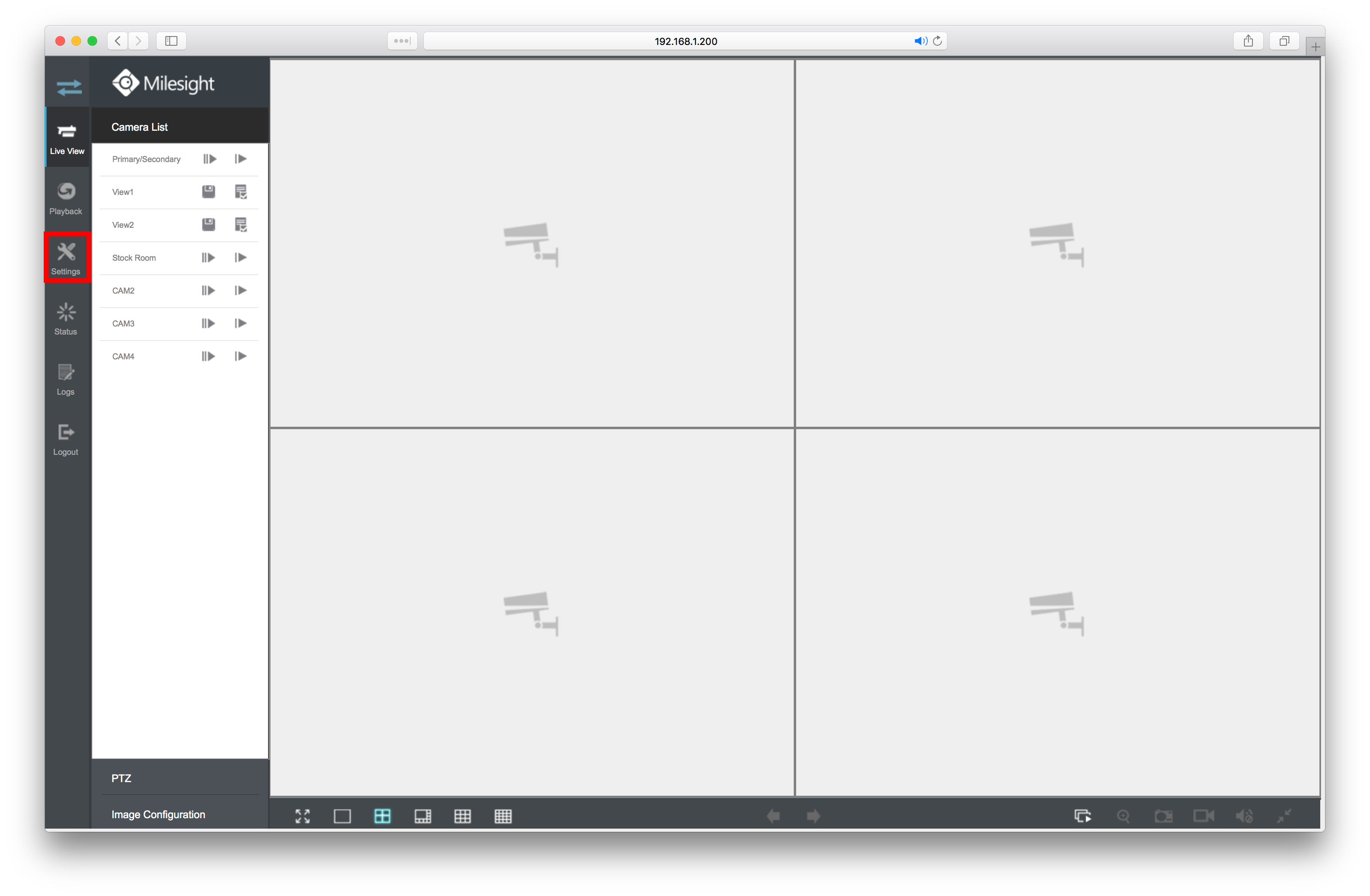

Step 1: Open Internet Explorer/Safari and log in to your NVR, once logged in click on Settings from the left menu bar

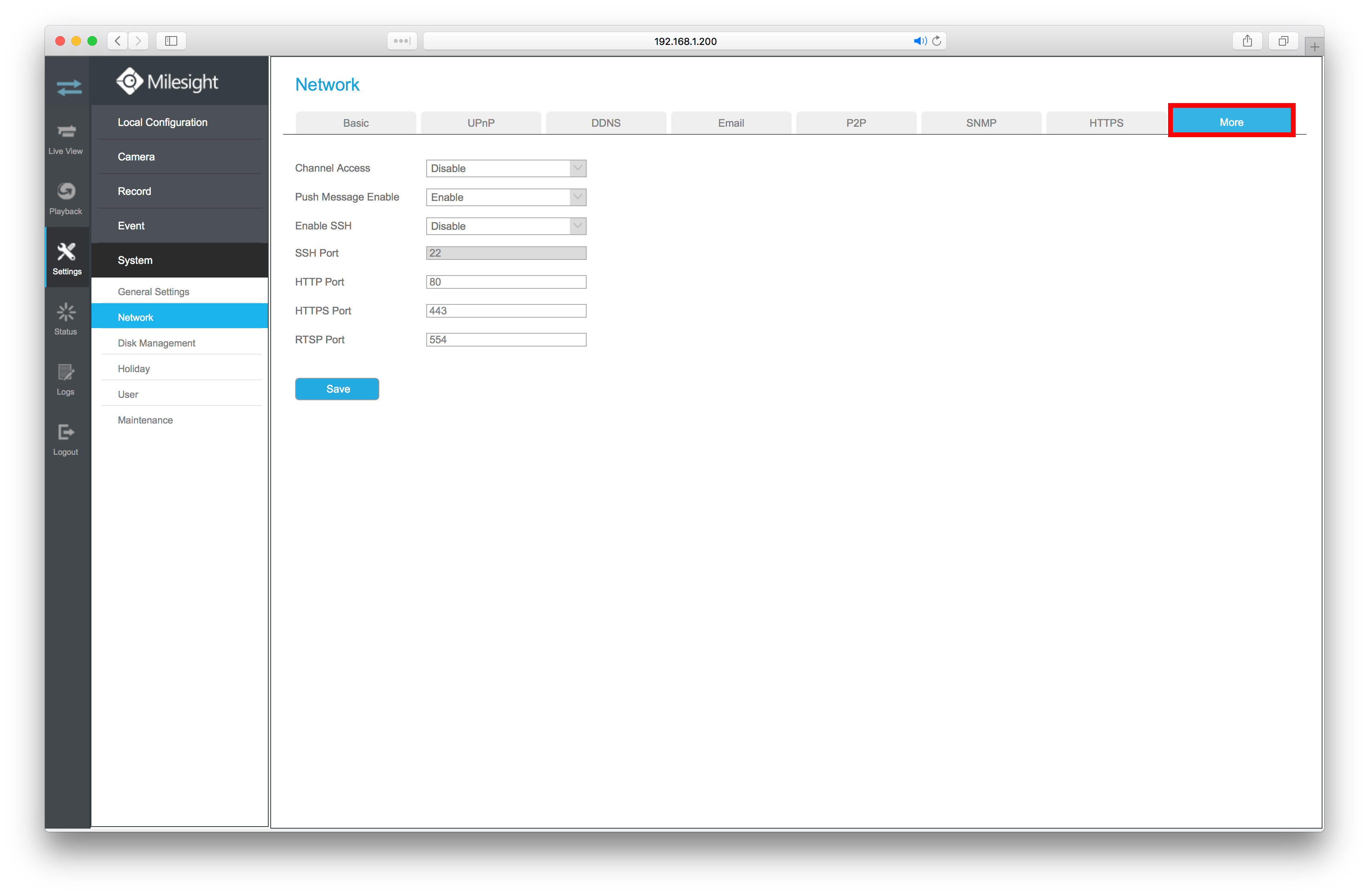

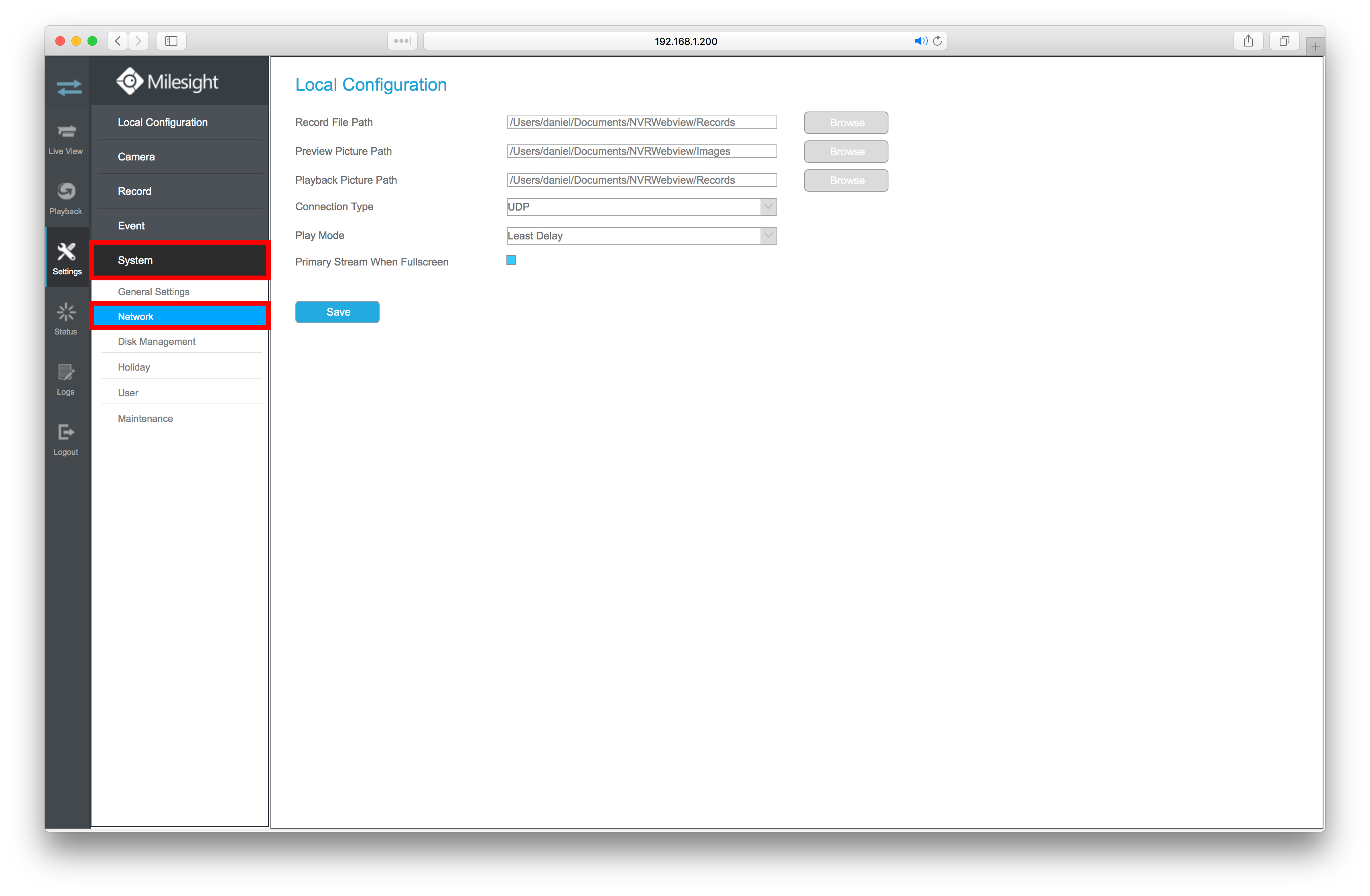

Step 2: Click System and then click the Network menu from the drop-down
Step 3: Click the More tab

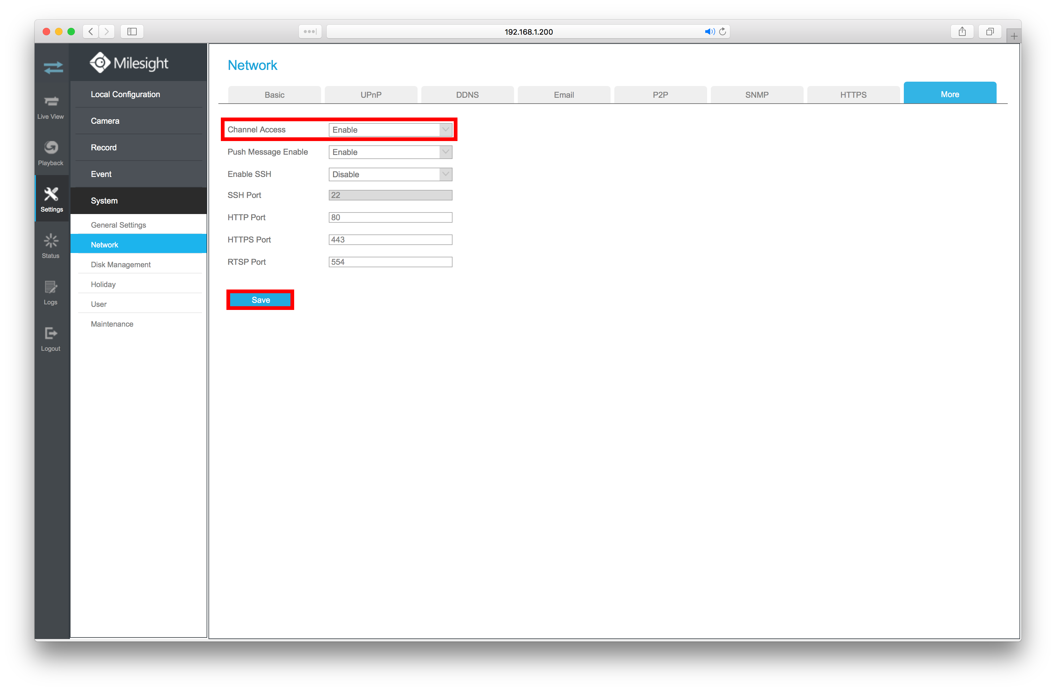

Step 4: Click the drop-down labeled Channel Access and change it from Disable to Enable, then click Save

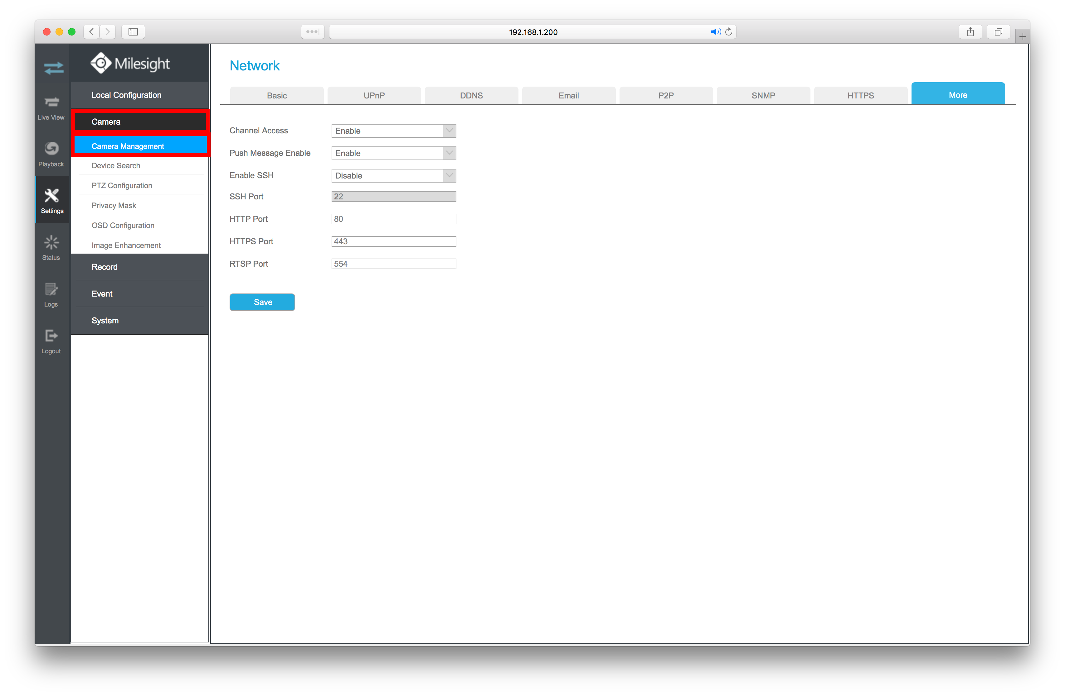

Step 5: Click the Camera menu and then click Camera Management from the drop-down
Step 6: Click the IE icon next to the camera you want to access
Step 7: Login to the chosen camera
And there you are, you can now access any Milesight camera connected directly to the PoE ports of a Milesight NVR, once you have access you can click Configuration and edit any camera setting you want as well as update the cameras firmware.

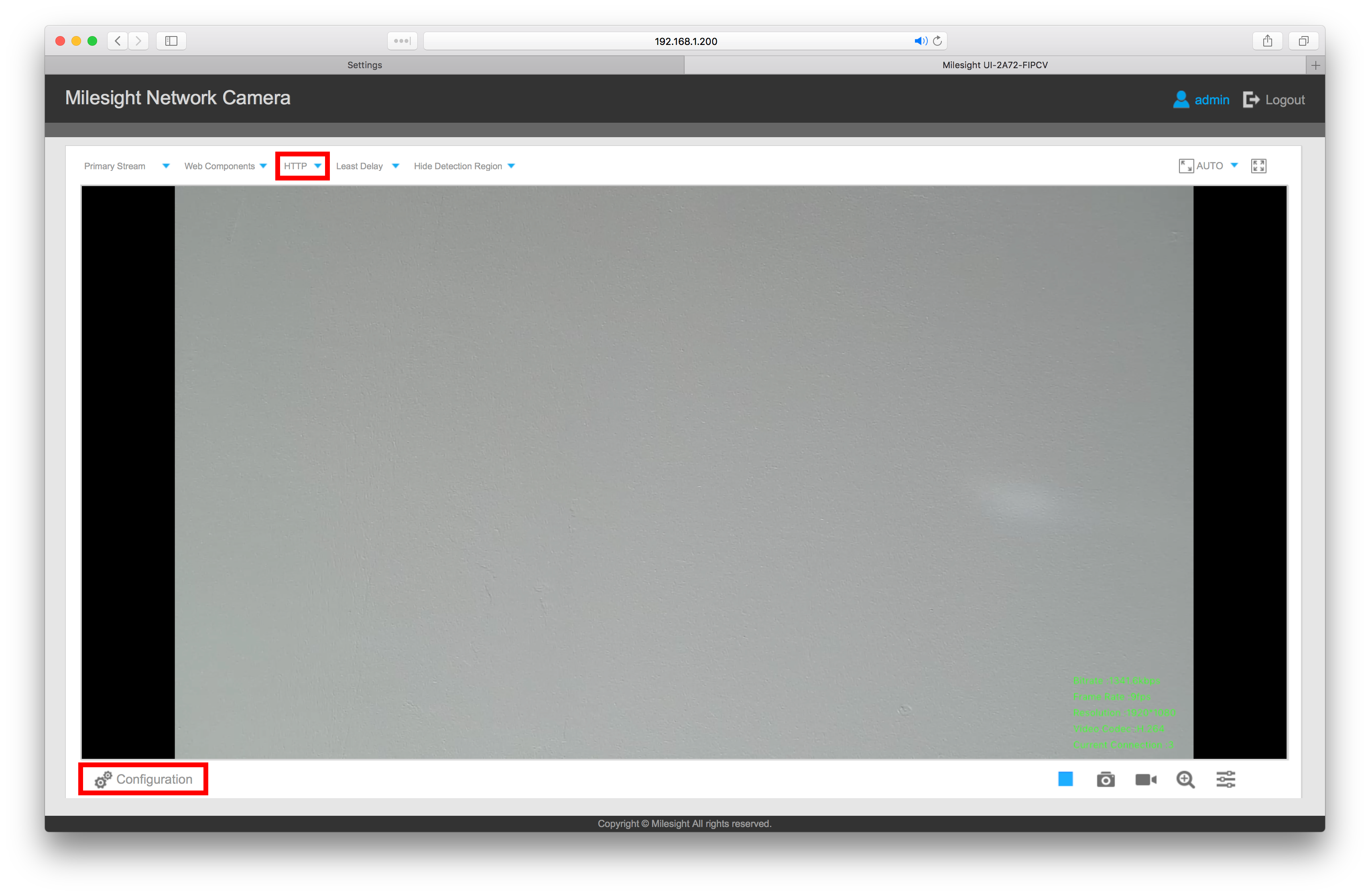

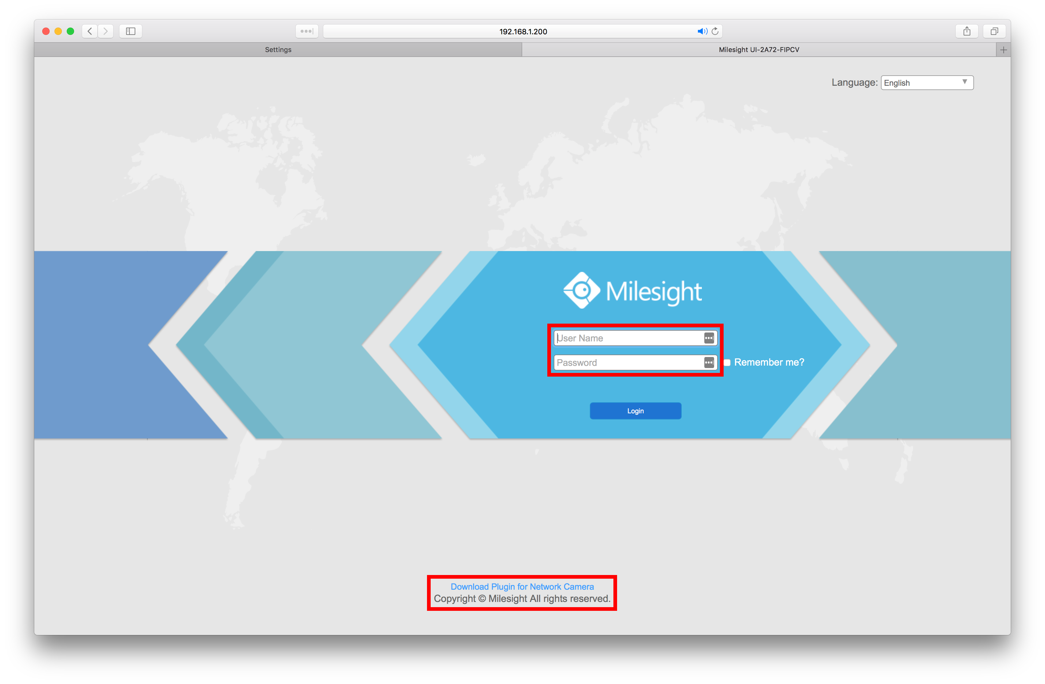

After first enabling the channel access/virtual host feature you may not get a live view when you access the first camera, to fix this we recommend trying these 3 things:
1. Check that you have the latest web plugin downloaded (link to download the plugin file can be found on the login page - see above)
2. Check that the camera is streaming with HTTP and not UDP (see above)
3. Clear the cache of Internet Explorer/Safari
