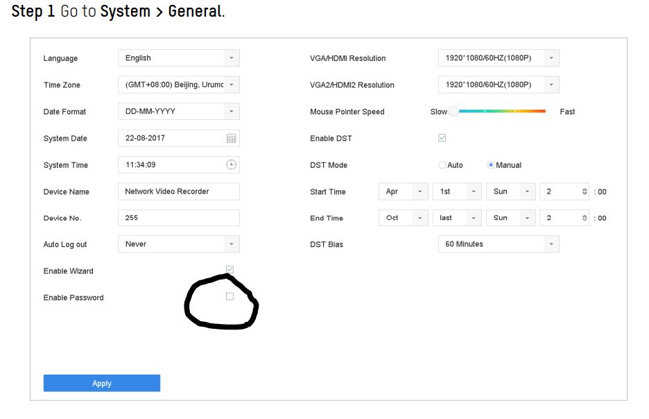

Is there a way to set a Hikvision NVR to boot into the live view screen on its HDMI output rather than having the log in splash screen until the user has logged in?
I have one particular client who’s NVR is on a HDMI switch so there isn’t a monitor local to the NVR.

Phil,
Found a fix,
Locally on the Server output (not web login)
Go to settings,
Disable password, it will now boot to live view, password is only for local view and not remote access.
