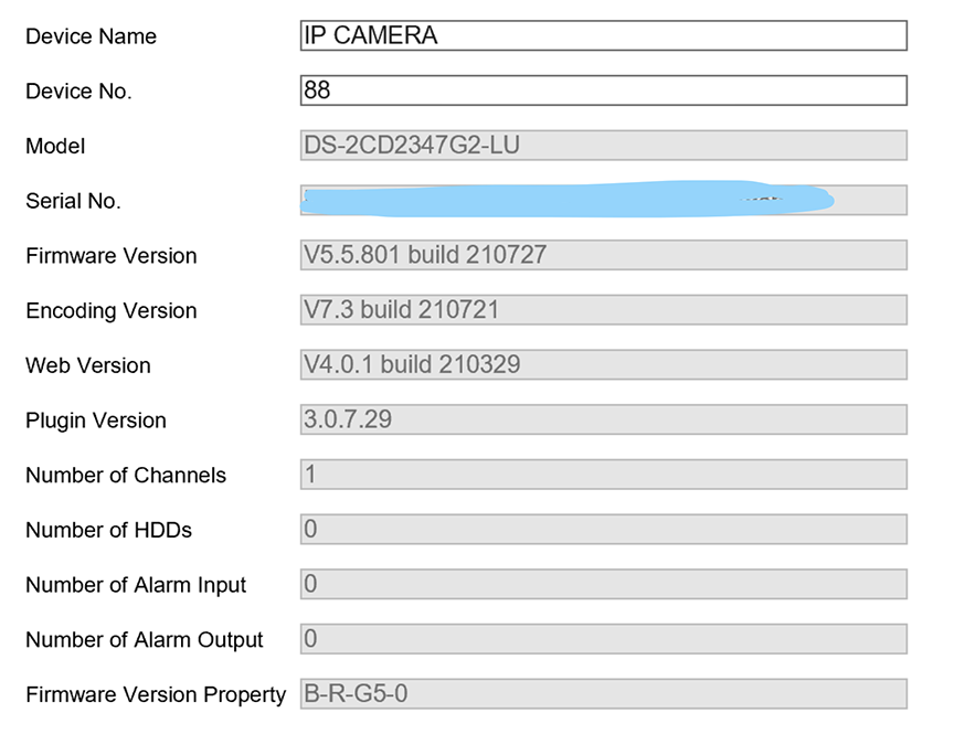

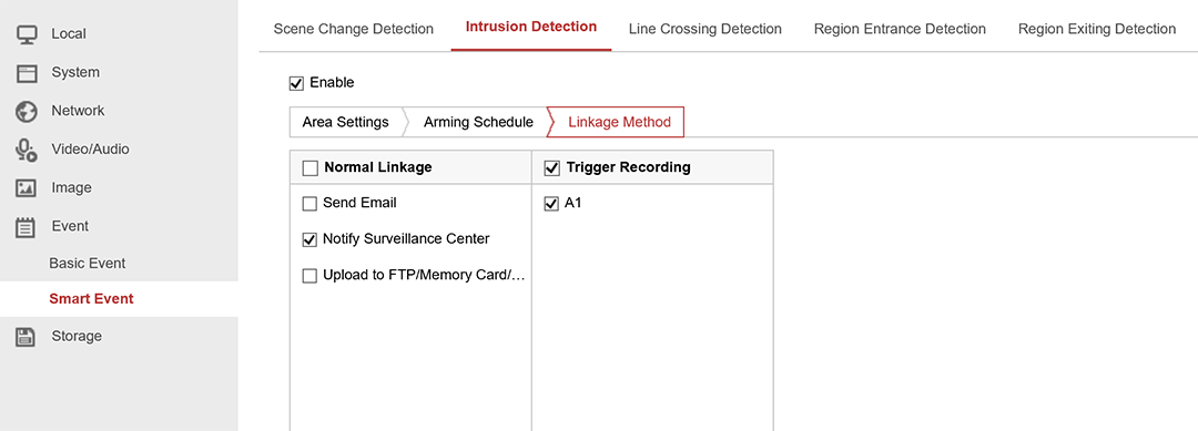

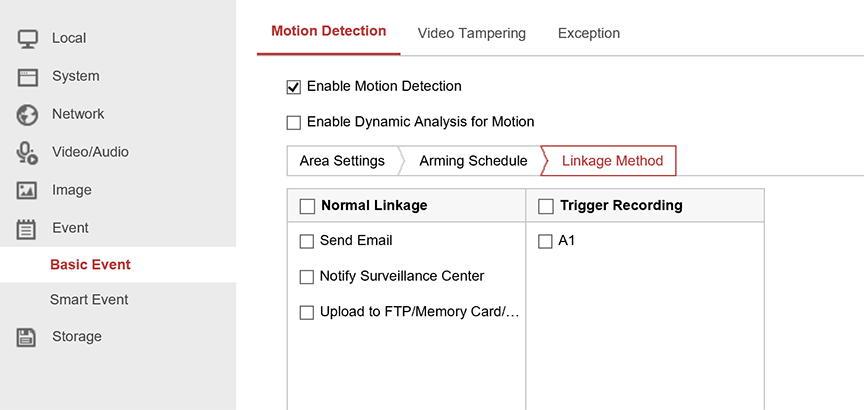

Hello,
I bought a Hikvision Colorvu DS-2CD2347G2-LU camera because I wanted the LED lights to come on with motion detection in a dark alley next to my house. It sounds like the new firmware version on my camera removed this feature. Is there an easy way to roll back the firmware so I can activate this feature?
Camera: DS-2CD2347G2-LU
Current Firmware: V5.5.801 build 210727
Firmware needed: 5.5.114
After posting in another thread, it sounds like I need Firmware 5.5.114 to gain this feature. Does anyone know where I can download this firmware and have a simple process to install it? I'm missing the "LED Light" option under the Linkage Method. I really need this feature.
I've attached screenshots of my camera interface and here's the youtube video that shows the "LED Light" option under the Linkage Method:

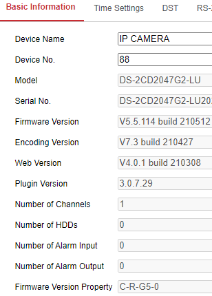

i had the same, i was triggered by your post, and checked my G5 firmware of the DS-2CD2047G2-LU. I had upgraded last week from 5.5.114 to 5.5.800 but overlooked the issue which you are referring to.
This was the version i installed and i managed to "downgrade' via chrome and localservicescomponents from 5.5.800 to 5.5.114 and the option is back.

mtv,
I tried downgrading to a few firmware versions and this was the only one that worked. Thanks, I have the feature back now with 5.5.114. Now the question is how to configure it best to turn on the LED with motion. If this camera is recording constantly to the NVR, then what event type would work best? I tried to setup an area under basic event with motion detection activated. I'm still testing but it seems to work best with humans and autos unchecked, with a sensitivity of 40. Anything higher than 40 and the light keeps going on from movement that I cannot see in the frame.
