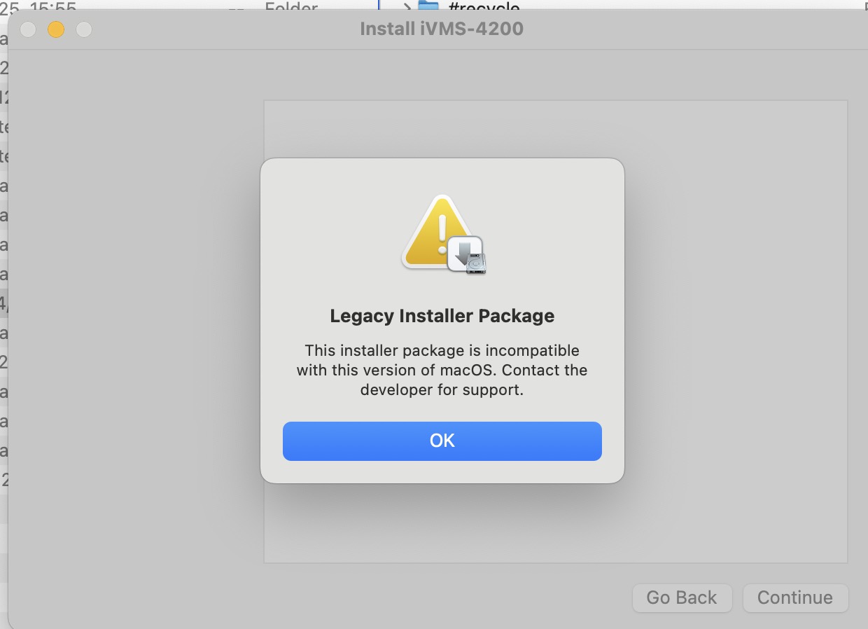

I used to manage the system (download videos from cameras) using the iVMS 4200. The problem is I've now rebuilt my Mac Pro 2 Mini (Apple Silicon), from scratch, no backup used, and if I try to install the iVMS software I get the following alert: "Legacy Installer Package - This installer package is incompatible with this version of macOS. Contact the
developer for support."

Hi guys, firstly with iVMS I've tried version 2.0.0.12 to 2.0.0.19 (I think). All give error:
