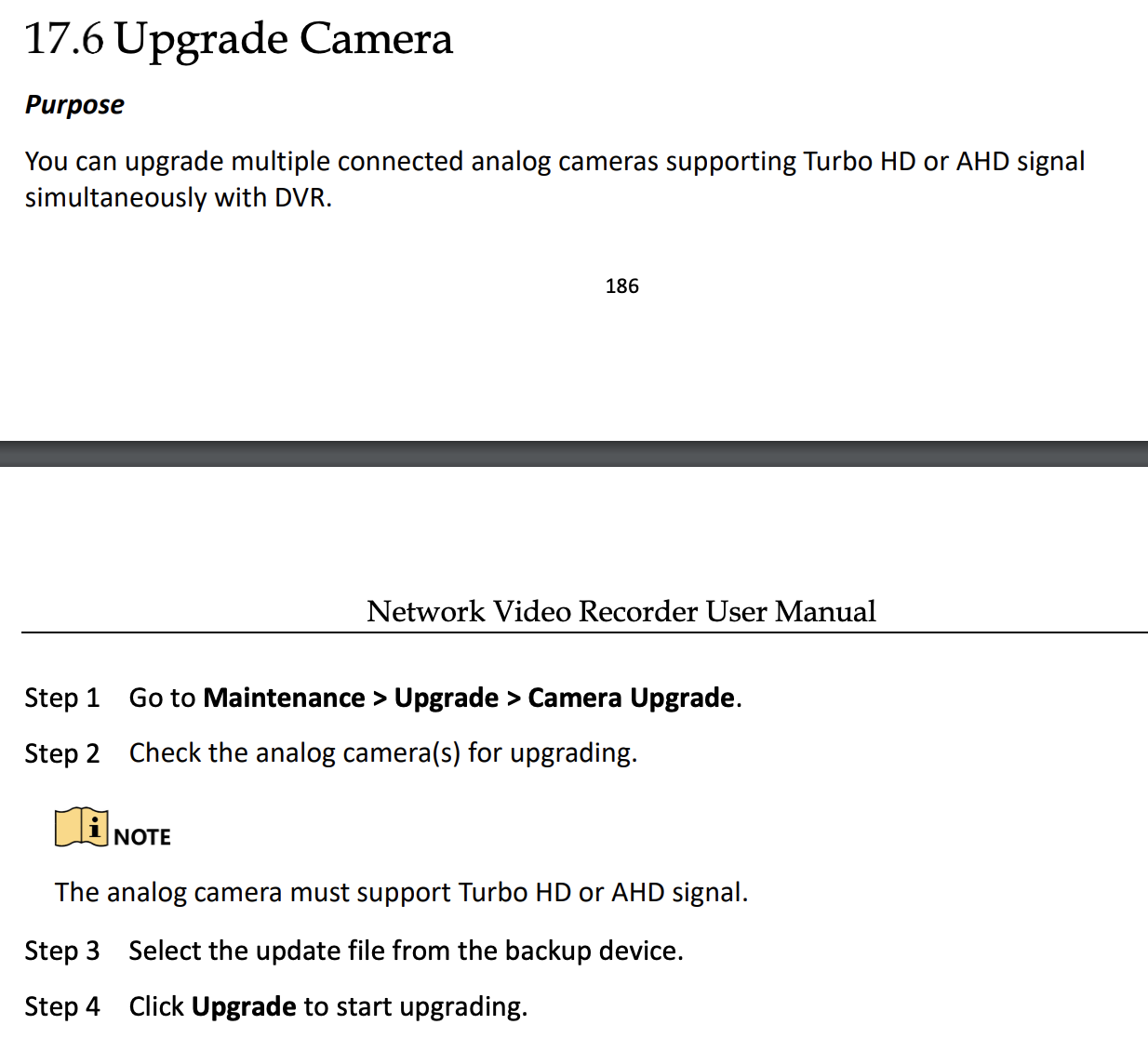

After my last message, I saw your other thread and could see that the DVR model you have is a DS-7208HQHI-K1, I've checked the user manual and it includes these instructions for updating analog cameras:
So you will need to download the camera firmware onto a USB storage device, plug it into the DVR, and then load the firmware following the above instructions.
Grate, I'll do that and come back with feedback.
Thanks!

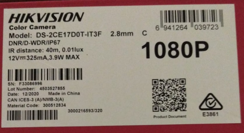

That this mean I have the (C) camera version?
