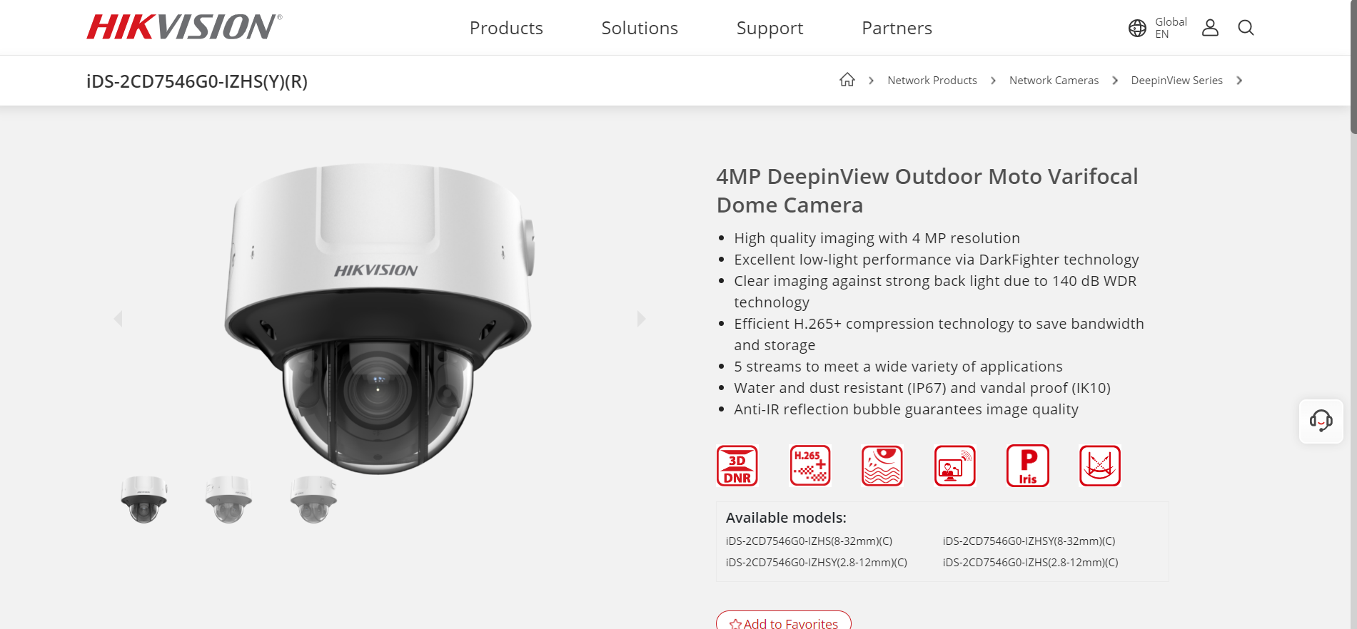

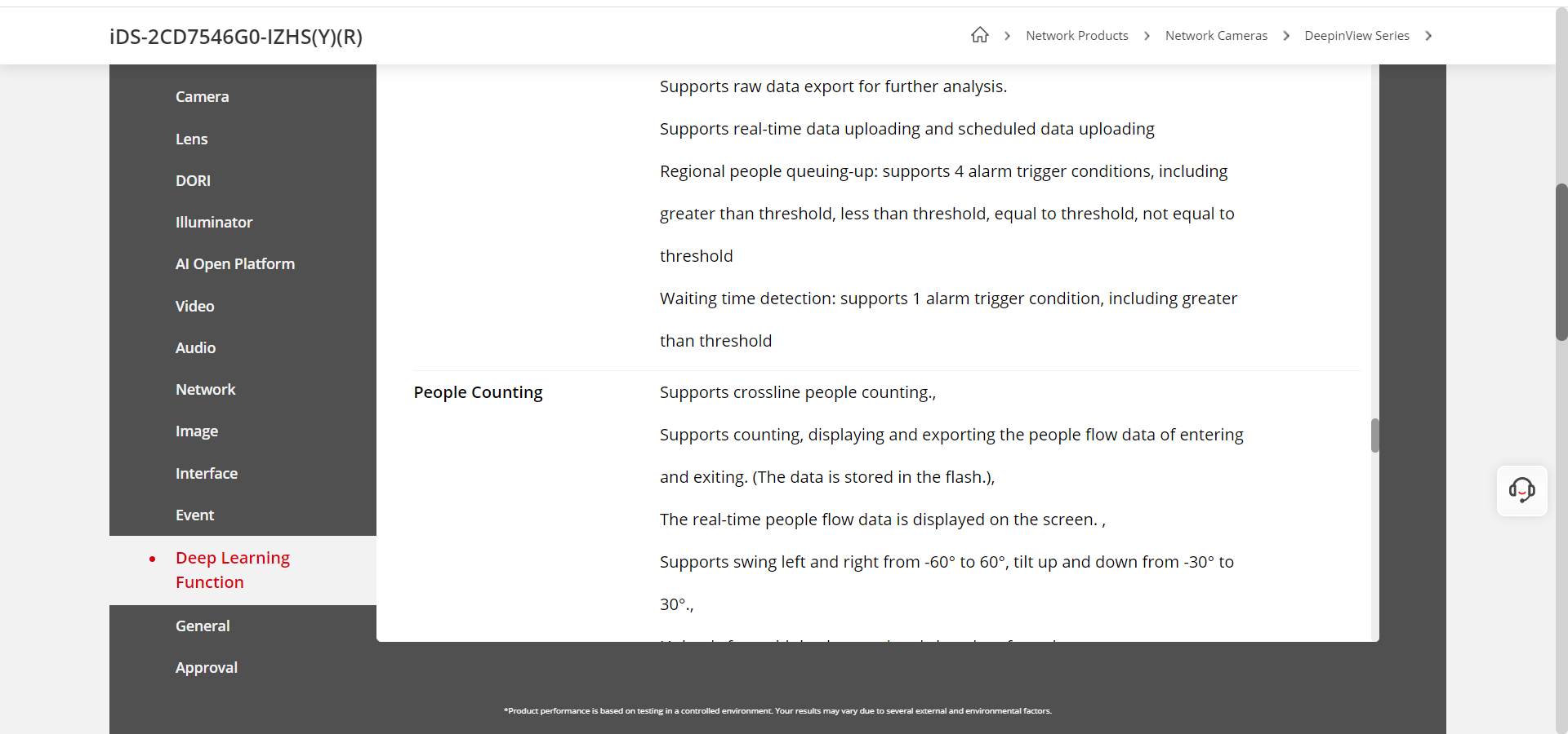

i have a question about the Cam iDS-2CD7546G0-IZHS which is offered in the USE-IP Shop. Does this cam support " crossline people counting " or not ? I found another Datasheet ( below ) of the same cam but with more functions ( incl. supporting crossline people counting ). I am now a little confused...i need this function. Could someone help me please ???
Thank you for any help and Information

First Datasheet is ( C dont know what that means ), but if you read both Datasheets at the end of the document is written: Available models.....the same cam but with different functions
Hi Gagi, people counting with 7 series IP camera works with iDS-2CD7546G0-IZHSY (2.8-12mm). I worked on one project with this camera (there was two camera counting people in open area). They work perfectly.

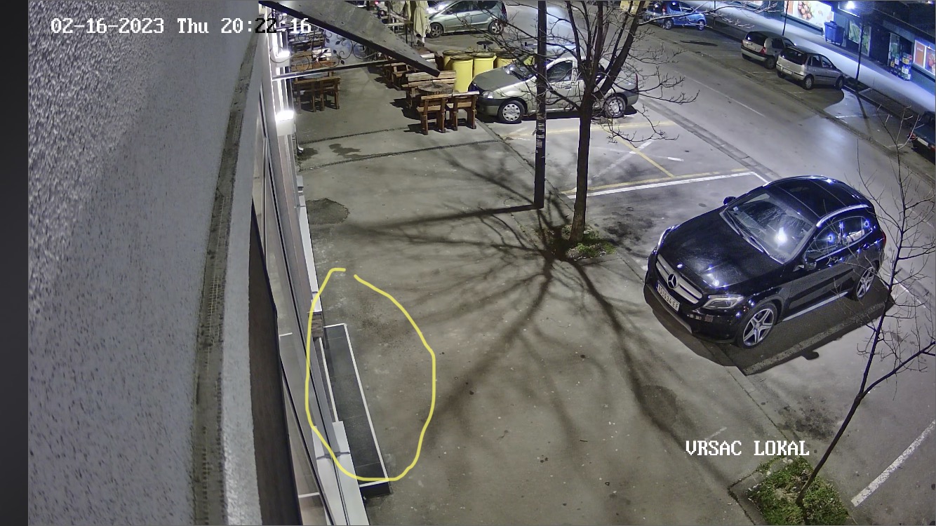

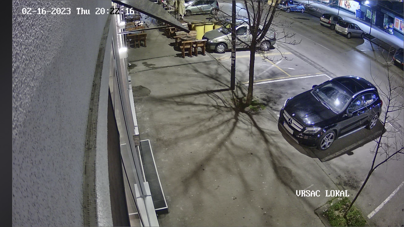

Hi Kamir ZG,
excuse me for my late reply. Thank you for your answer. Could i place the cam beside the entry or do i have to place the cam in front or above of the entry ? I need it for this area…( see the pic below )

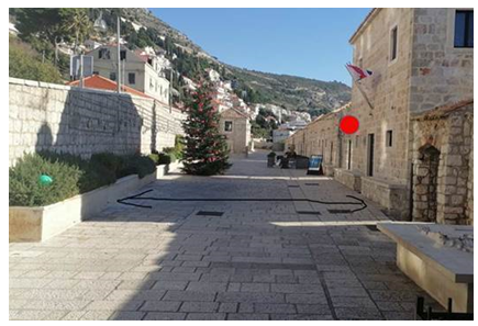

I can give you example of space we are covering with that camera:
It's on maybe 2+m height and it's covering this passage. Camera is installed on red dot. Beauty is that you don't have to install it above of entry.
Thank you very much, i‘ll give it a try.
Which people are you counting ? The people who pass the street or the people who enter the building….i need the function „ people who enter the building“ and in my case the cam would have this view….and i would like to count the people who enter the „ marked“ entry.

It was a street, so any person who goes from direction A to B is classified as a entered one.
