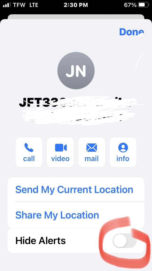

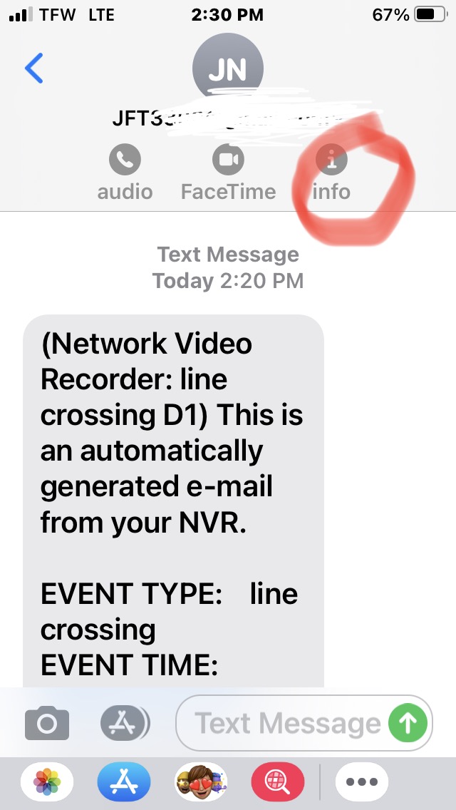

I found my issue when you go into your text message from notification of hike connect app. There is a hide flag. I had it set off. Turned it on and now I receive my banner notices along with sound. I will attach some files
