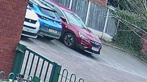

Like most people my aim is to get the best possible image quality.

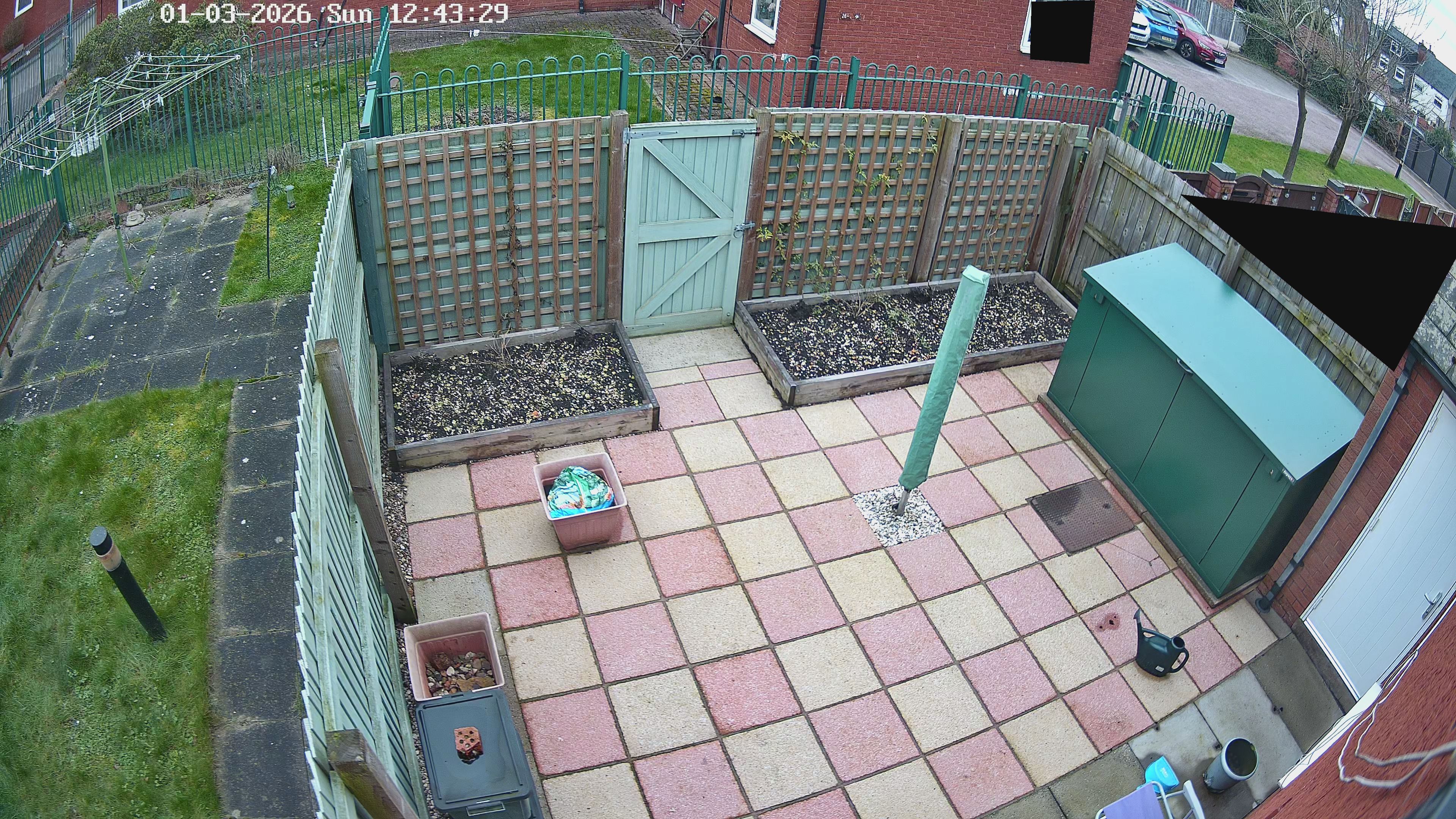

This is the view of my back yard taken with a Hikvision 8mp camera that has a 2.8mm fixed lens.
As you can see from the images, I can't quite read those car registration plates.
In this situation, do you think that one of the new Hikvision 16mp with a 2.8mm lens would enable me to read those registration plates or not ?
It's not that I specifically need to read car reg plates but would like more detail in that area because we get suspicious individuals over there from time to time, usually during the day.
