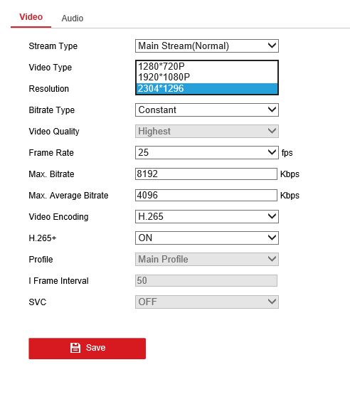

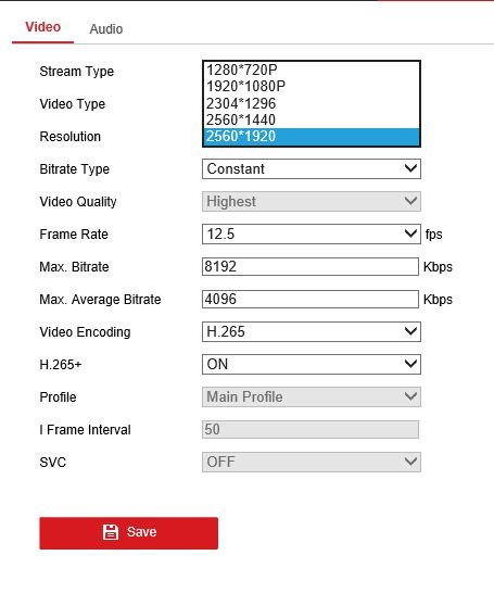

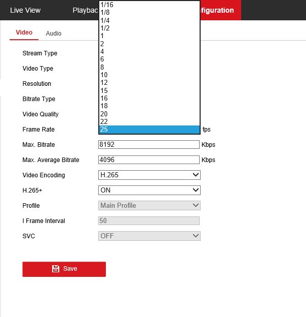

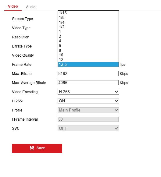

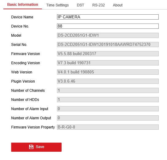

My issue is: In first piece Hikvision DS-2CD2051G1-IDW1 I choose max resolution (2560x1920). In second Hikvision DS-2CD2051G1-IDW1 I only have to choice 2304x1296 for max resolution. See photos bellow. In same time as you see in first Hikvision (2560x1920) there is totaly different choice for frame rates unlike second camera. Whats wrong here? Can I set second Hikvision camera for same resolution as first 2560x1920? In both cameras is same firmware (see photo)

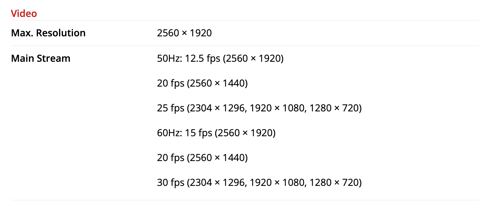

It's simply because of the frame rate. The camera is only capable of the maximum resolution at 12.5 frames per second.
Because you have 25 FPS selected on the camera, it is disabling the higher frame rate. You need to drop the problem camera first to 12.5 frames per second and apply it - once you've done that the higher resolution setting will be available. This is confirmed in the specification as shown below
