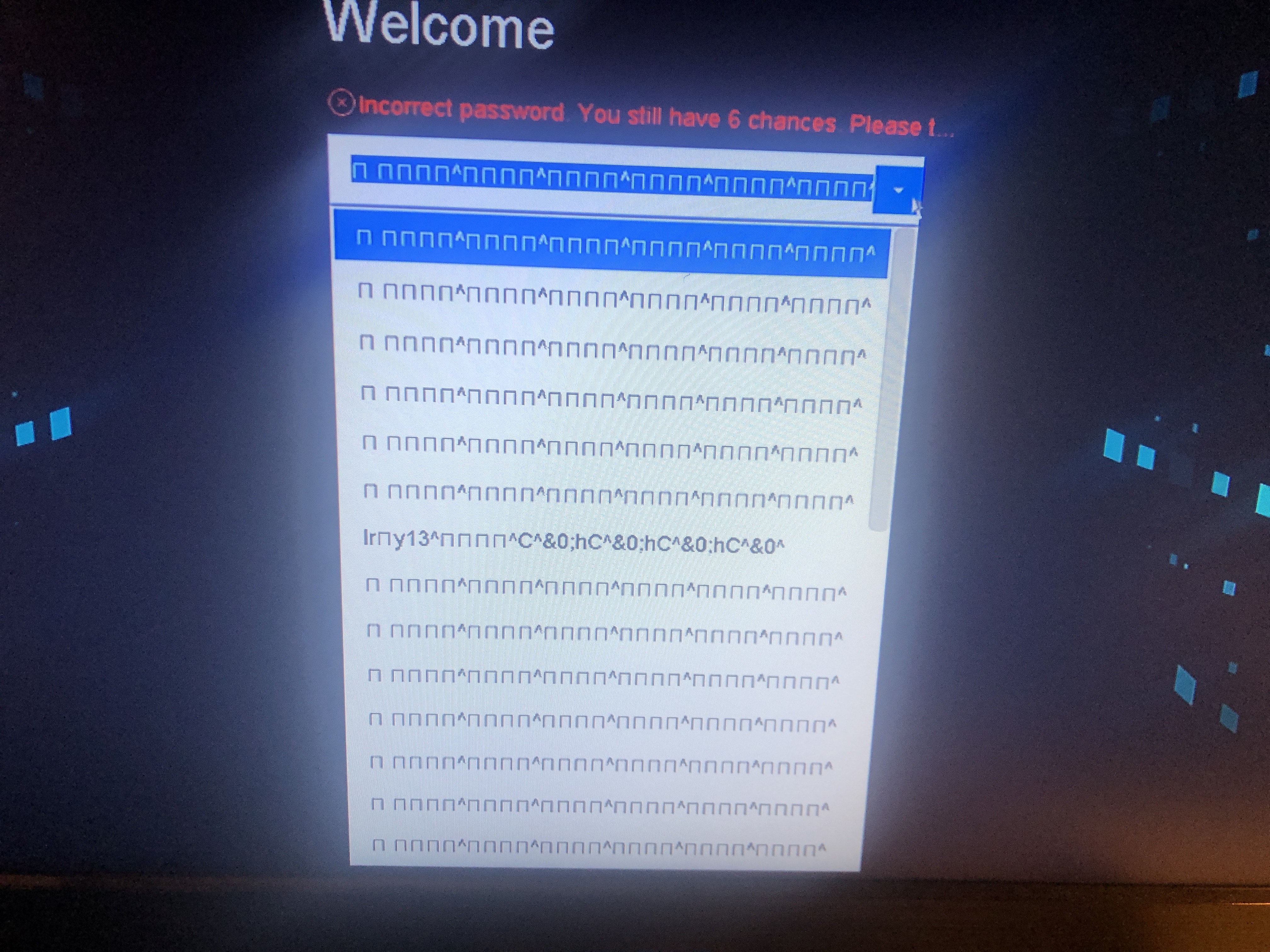

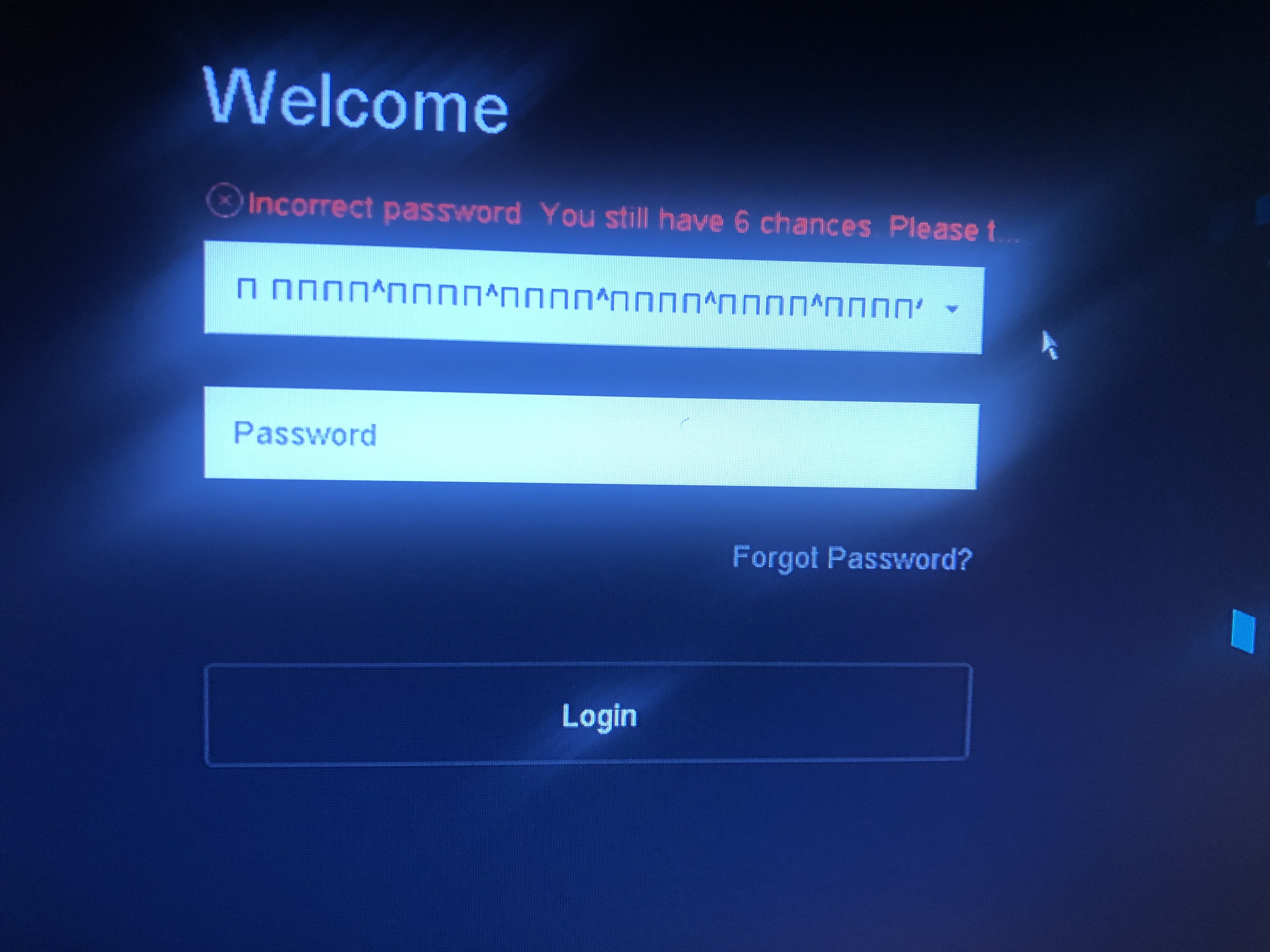

Hi everyone,
After upgrading the firmware of my NVR DS-7732NI-I4/16P to the latest firmware available on the Hikvision website V4.22.005 build 191208, I can no longer log in with my previous username and password, nor I can set my username in the login page. I can just choose one of the unreadable preset values.
Any clue how I can resolve? Please help....

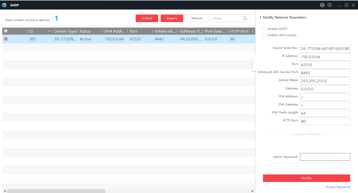

Hi All,
Thank you so much for your prompt reply.
@Dan, please see attached what I see with SADP. The static IP previously assigned to the NVR has changed and apparently I have no changes to modify if (and anything else) from SADP. It does not look either in the range automatically assigned by DHCP (192.168.1.100-192.168.1.199)

Hi @julianF
There is no SADP screenshot attached, can you attach it please as I don't quite understand what you are describing.

Hi @Dan,
Apologies, the screenshot is now attached.

Thanks for screenshot @julianF
What happens when you actually select the NVR in SADP? (e.g. tick the box on the far left of the list) Do you see the device details on the right and can you edit them or are they greyed out?

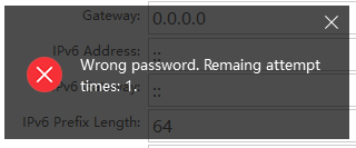

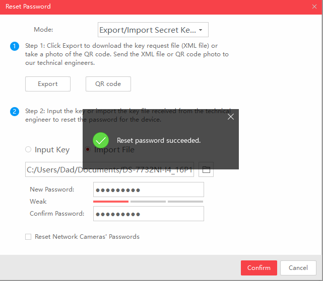

Hi @Dan,
Thanks, when I tick the box it looks I can edit the device details. But now the problem is that the NVR does not recognize my password.
I requested HikVision to provide the input file to reset the password and apparently it works, but then I get an error when I try to use it.
So bad....

Ok, I would try resetting the password again and when you set the new one make sure it is a strong password with letters, numbers, and special characters because we have seen issues in the past relating to weak passwords and the new security measures that Hikvision have introduced in recent firmware.
Done, the password reset is ok, but still error message when I use the new password :-(((
Ok, in those earlier screenshots you tried the password in SADP but have you tried logging in with a browser?
If that still doesn't work then the last thing I can recommend is to install iVMS-4200 on your PC and try adding the NVR to that software, in iVMS you can then access the settings of the NVR and you should be able to try downgrading the firmware and reinstall a different version of the firmware.

The problem I'm afraid is with the default IP address taken by the NVR 192.0.0.64. I can't connect to the web interface I guess because my router handles IP address 192.168.1.* .
With iVMS-4200 i have a similar behaviour. My NVR is found as on line but then when I try to add it goes off line.
I should probably connect my computer directly to IT as suggested in the attached guide, page 10. Just wondering if I need a crossover cable.
