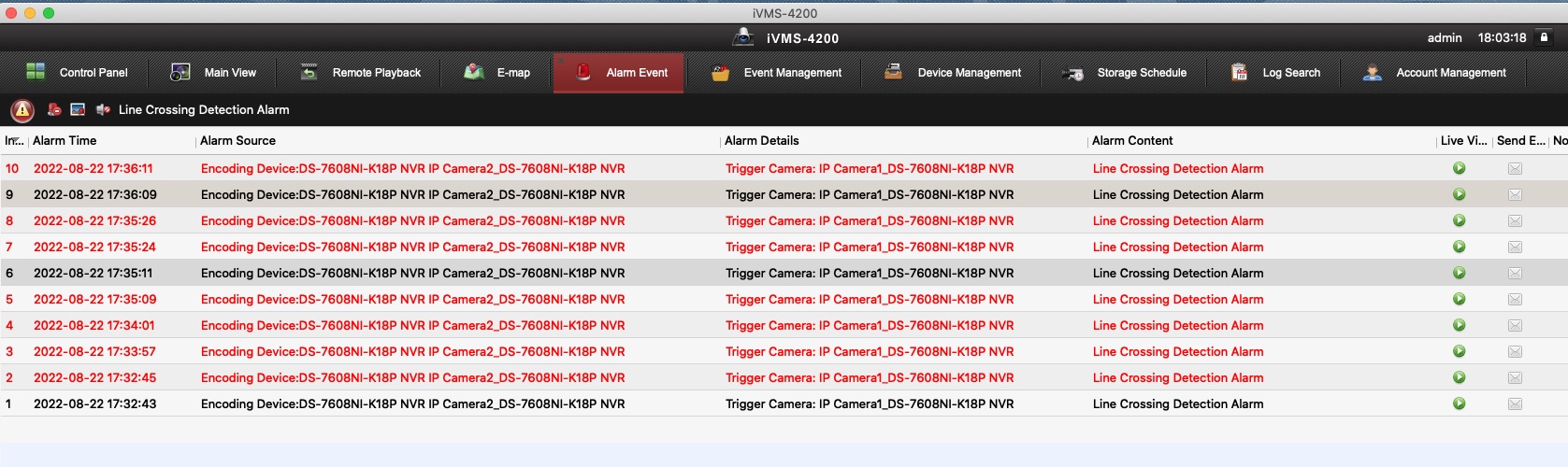

I have an issue for an alarm within iVMS-4200, it shows the correct alarm source ( camera 2 ) but when i click on the live view button it takes shows recording for my other camera and alarm details says camera 1.
Screen show shows this mismatch, its a bit annoying as i cant jump straight to event that caused alarm.
Cheers for any advice.

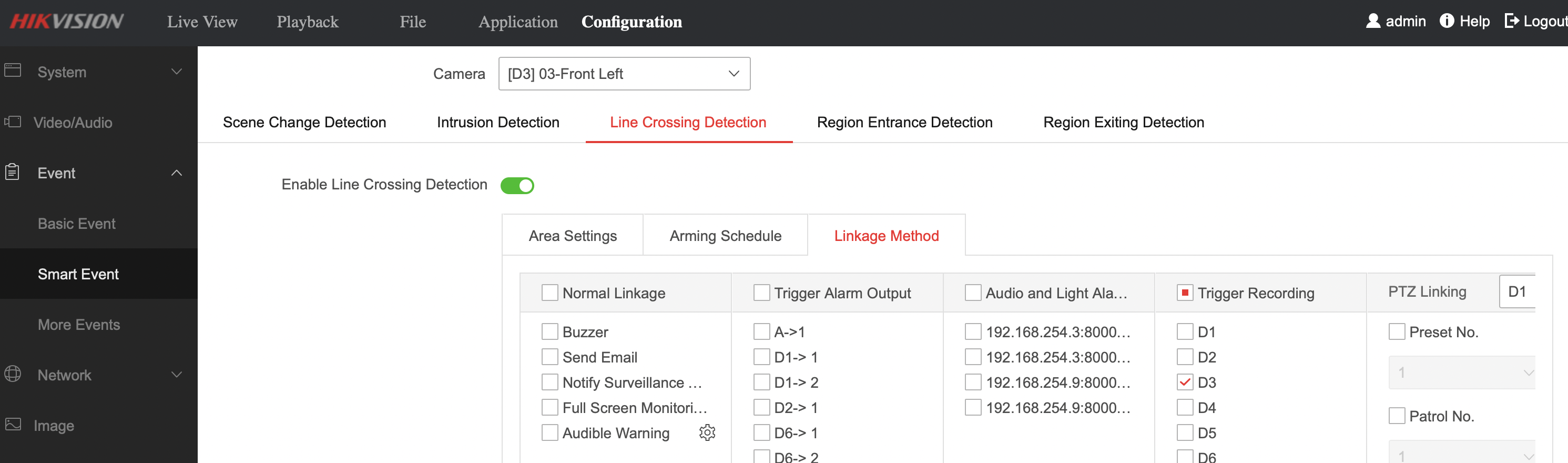

Could you possibly have accidentally linked the alarm actions of the line crossing alarm that is set up in Camera 1 to trigger Camera 2? By default all events are configured to trigger the same camera but that can easily be changed to a different or additional cameras as shown below in Event > Smart Event > Line Crossing > Linkage Method:
Hi, thanks but i checked that and camera D1 -> Triggers D1 etc ( the correct camera is displayed in hik-connect live view) but not in iVMS-4200,

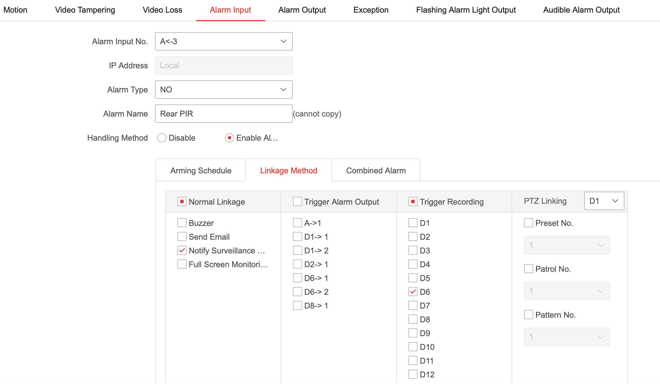

It looks like you have found (yet another) large bug. Something is completely scrambled - I'm using iVMS-4200 for Mac. This is not identical to your issue, but it is similar in that iVMS is completely mis translating channels when an event is received. Below you can see I have a PIR connected to Alarm Input 3 of my NVR and it is set to trigger Camera 6:

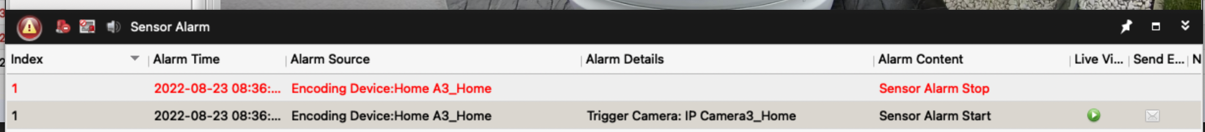

When I trigger the alarm with iVMS-4200 open, it has incorrectly linked alarm input 3 to camera 3 (rather than camera 6) as can be seen below:

I've then triggered alarm input 2 (another PIR) which is linked to trigger camera 5. Again it came through correctly in the Hik-Connect app showing a clip for Camera 5. However in the iVMS-4200, again it is incorrect - showing video from Camera 2 triggered by Camera 3?

Edit: It seems as though all line crossing alarms are bringing up camera 1 regardless of source and all alarm inputs are also linking to the incorrect camera. In my case all linking to camera 3, regardless of input (both NVR wired input and camera wired input)

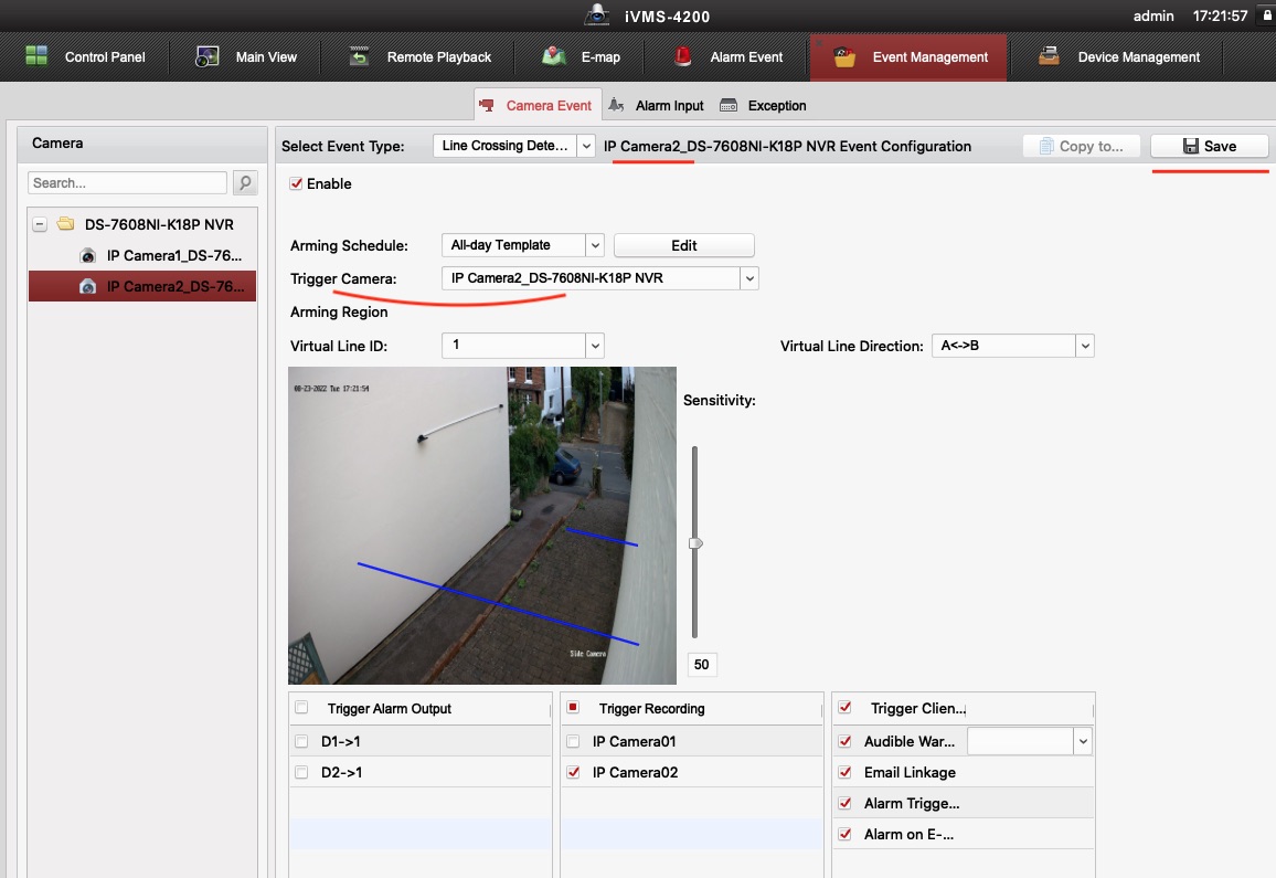

I've worked out what the issue is the Event Management -> Trigger Camera is not saved and default back to first camera on restart.
So for camera2 if you change trigger camera to camera2 and hit save all works, but when you restart iVMS its flicked back to camera1. So as a work around need to set this each time you restart iVMS which is a pain.
In the Mac version of iVMS-4200 all of the selections in Event Management show correctly (matching the event settings in the NVR) when the app is opened each time. However those settings are ignored and the incorrect camera is linked when an event is triggered.
