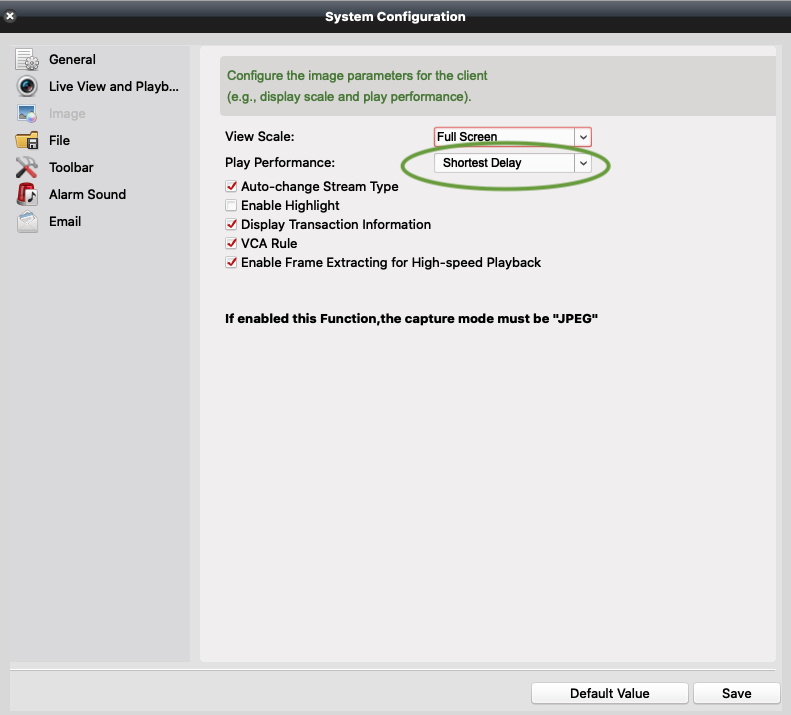

On my Mac the iVMS-4200 was putting a very high load on the CPU.
This may be a well known tip but I cut the CPU load by 50% by setting in the iVMS-4200 app,
System Configuration -> Play Performance -> Shortest Delay
It defaulted to Balanced
