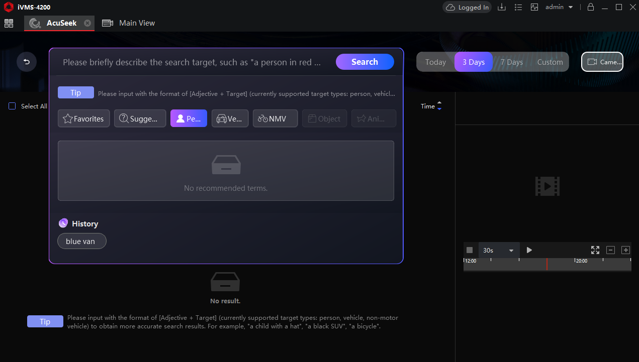

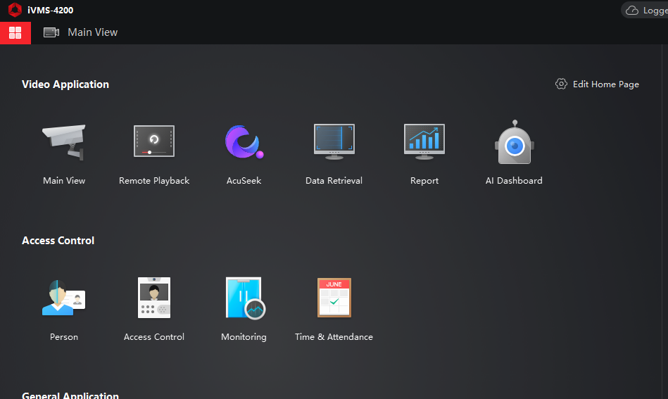

I have just come across a new version of iVMS (V3.13.0.5_E) and noticed it now has an 'AcuSeek' section when loading it, I have been into it but can't seem to get anywhere with it.
Do you need special cameras and or NVR for it to work?

Models ending with /AI will support acuseek. Models ending with /VPro support self learning algorithm for detection. Acuseek will offer user searching by inputing a sentence like. A man in yellow jacket with suitcase. It will list all footage that match criteria. Like a chatgpt within nvr
