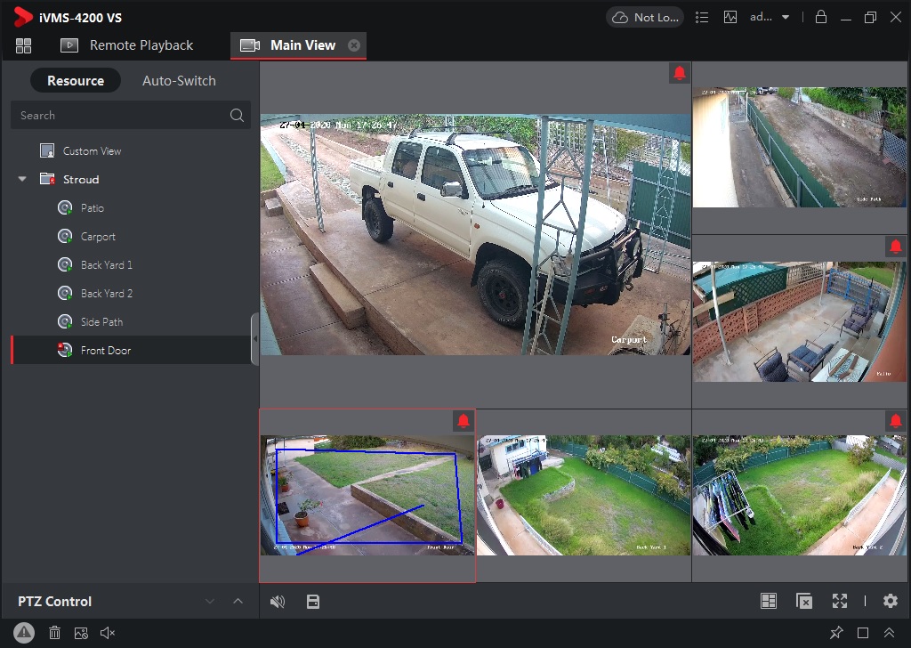

Hi Everybody,
I'm enjoying getting to learn the ropes around the latest version of iVMS-4200 VS (v1.1.0.10), it's certainly quite different from iVMS-4200 v2
One idiosyncrasy that I have noticed is that the red bell icon that appears in the Main View when detected Events are sent from cameras does not turn off after Smart Events (Line Crossing Detection, Intrusion Detection, etc.) have ended. In fact, the only way I can clear this indication is to re-start the software.
Cameras with Basic Events only, the bell appears for the duration of the event, then turns off.
Has anyone else noticed this? Is there a way to make this Bell icon work the same for Smart Events as it does for Basic Events?

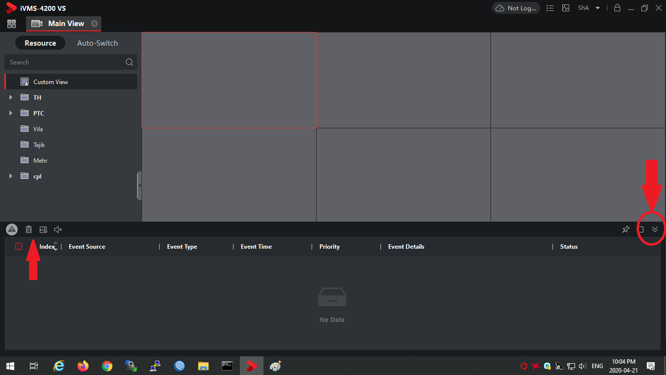

Hi @michaelc ,
there is tab on the bottom of your ivms you can pulled it up by clicking on arrow by doing this it shows your event in main view you could choose the specific event and right click then clear or you could do this by pressing recycle button both work same way and red bell goes clear.

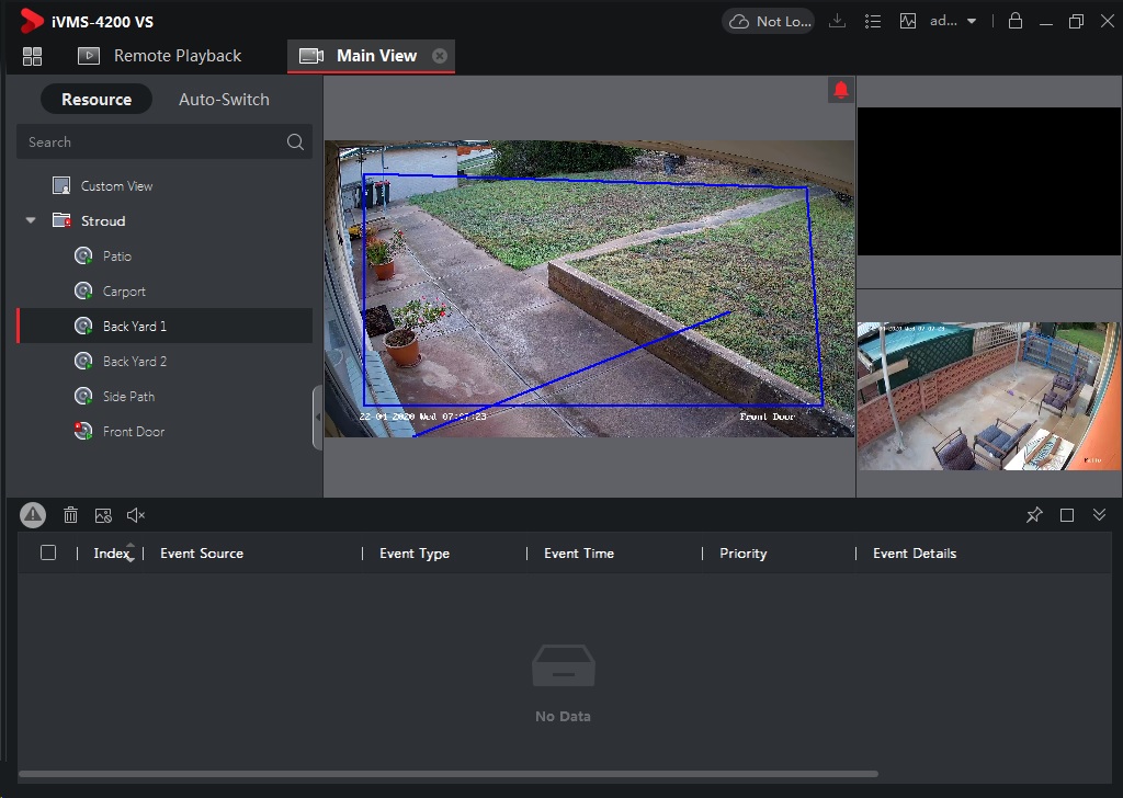

I have tried this (screen capture attached), but even with all of the events cleared... the red bell icon remains.
It is quite puzzling.

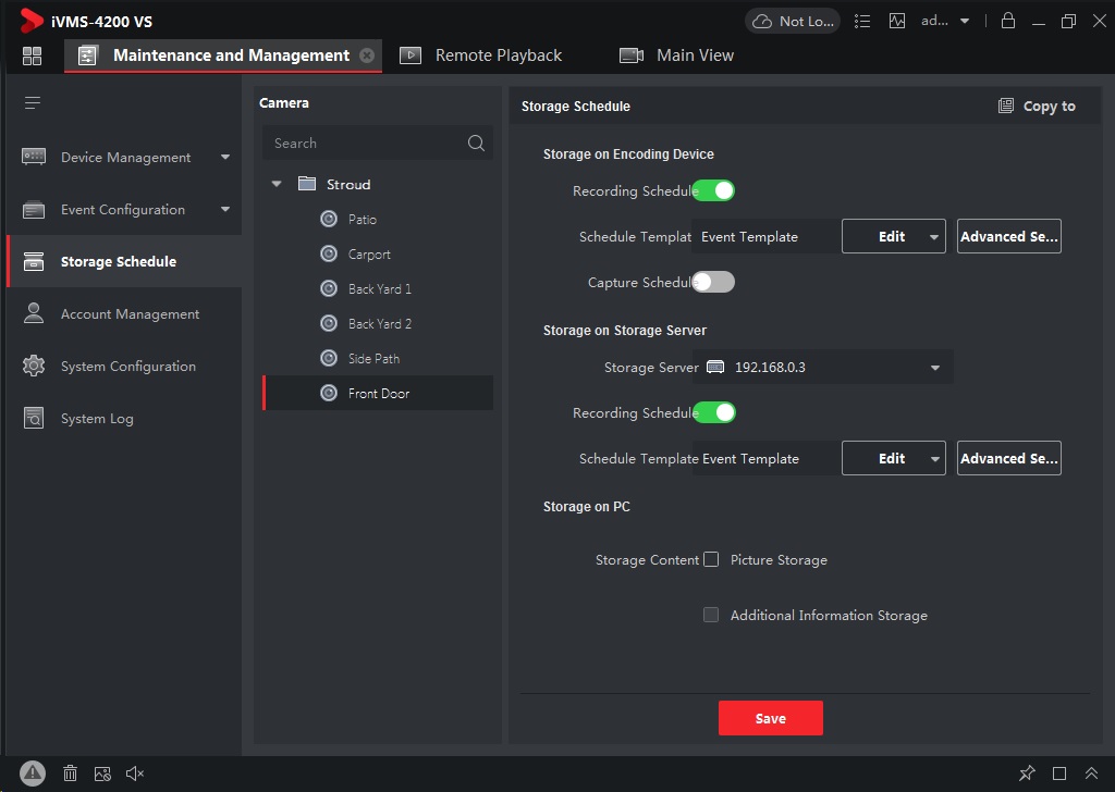

I have configured the camera to record on both the internal SD Card and also on the iVMS-4200 VS software (see attached). This is how I was able to determine that there was an issue with Basic Events on the newer DS-2CD2365G1-I camera. Originally I set it up the same as my older cameras but discovered right away that something wasn't working correctly. My vendor suggested I try different codecs and eventually suggested I upgrade the iVMS-4200 from V2.8.1.4 to the newer V3.2.0.10. I advised my vendor that the new version of iVMS-4200 didn't fix the recording delay with Basic Events on the new camera and how I found that Smart Events worked fine. I guess this was taken by them that my problem was "fixed" and I haven't heard from them since. I have found a nice combination of Line Crossing and Intrusion Detection that seems to work very well.

A quick follow up...
Strangely, when I shuffle the cameras around on the Main View, I get persistent red bell icons on my other cameras that cannot be cleared. The alarm indication in the list of cameras does go away after the event has finished (apart from the troublesome DS-2CD2365G1-I camera).
It's seems to be when I move a DS-2CD2342WD-I camera live view into the location where the new camera once was, this happens. More weird behaviour :-)
Restarting iVMS-4200 VS will clear them, but the newer camera (DS-2CD2365G1-I) still has a "sticky" Smart Event notification icon regardless.

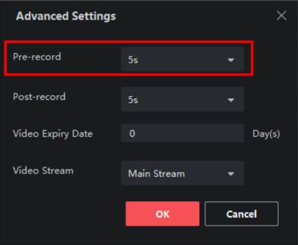

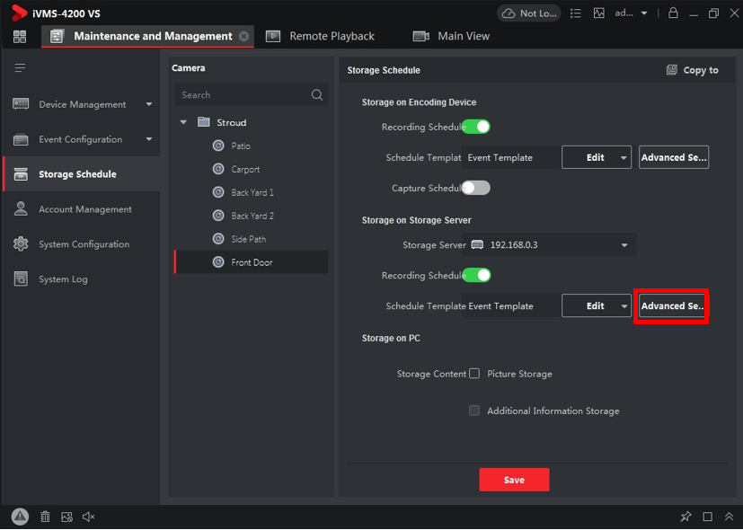

I am checking the second issue with R&D. And please also advise the customer to select longer pre-record time (like 10 seconds) in the Advanced Settings of Storage and see if it helps. (shown below):
Let us know if this helps at all.

I will experiment with the Pre Record time and Basic Event detection on the new camera over the next few days. To be honest, I've never been able to make the pre-record function work properly ever (**edit - with Basic Events)... even in previous version of iVMS-4200.
It didn't seem to matter to what I set the pre-record time (5, 10 15, 30sec), the recorded video always seemed to start at the instance of the Basic Event detection and never before. (**edit - Today I am seeing that pre-record does appear to work with Smart Events on my new camera (Front Door), but not with Basic Events on other cameras).
I am using an Event Based Storage Schedule, mainly to save on disk space. I figured the pre-record time would set up a buffer large enough to allow video preceding the detected event to be captured and saved. I may be configuring something wrong, but I do remember it frustrating me to no end many years ago.

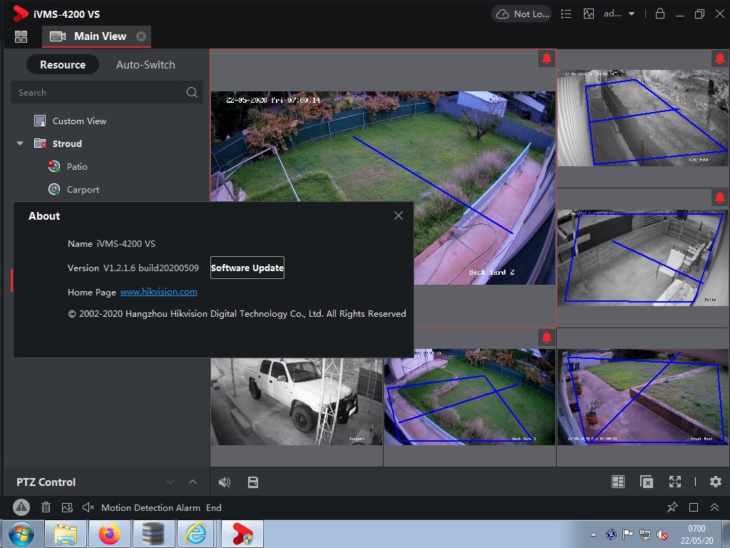

I've updated iVMS-4200 VS from 1.1.0.10 to 1.2.1.6 last night... interestingly the "Detect New Software Version" option did not alert me to a new version... I found it out by checking the Hikvision web page.
Anyway, I can report that the new version of iVMS-4200 VS did not fix the issue I am experiencing with sticky red bell icons after a Smart Event has been detected :-( and as before, you can't clear them by clearing the Event List.

An update re this issue!
I am pleased to now report that iVMS 4200 VS V1.3.1.6 build 20200812 has fixed the sticky red bell icons after Smart Events are detected! :-D
