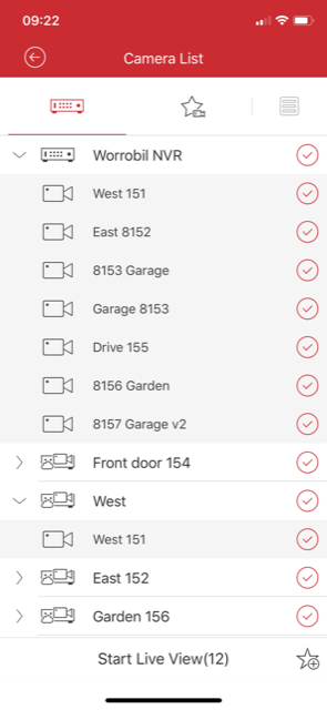

Hi, I've just started using the IVMS-4500 app on iOS but can't work out exactly where it's pulling the camera name from. In case it makes a difference my cameras are connected to a switch and not to the NVR. Any help most appreciated. Thanks

Hi JB, thanks for your help with this, I still can't manage to work this out and get consistent naming. Is there a time delay for syncing?
I've checked the OSD settings, please see attached. Thanks

Ahh OK. The names in iMVS 4500 iOS app update once you close fully and re open the app or refresh it. However it looks to me like the names updated in the camera GUI aren't being updated in iVMS 4200 software.
To sort that out:
  1. in iVMS 4200 software in the left hand pane click group
  2. on each NVR or camera folder right click on "encoding channel"
  3. click "update camera name"
That will replicate the names from the camera display settings into the iVMS 4200 software.
I don't use the iVMS 4200 software much but the names you enter in the software can be anything you like and won't affect the name in camera display settings. You should probably make changes in this order:
  1. Edit camera names as you want them using either the individual camera web GUI or the remote configuration section of iVMS 4200 software
  2. In iVMS 4200 right click "encoding channel" and select "update camera name" as described above
  3. Fully close/reopen iVMS 4500 iOS app or force refresh it
Doing it in that order will ensure everything matches with regard to the camera names. The "alias" for each group will need to be matched manually.
