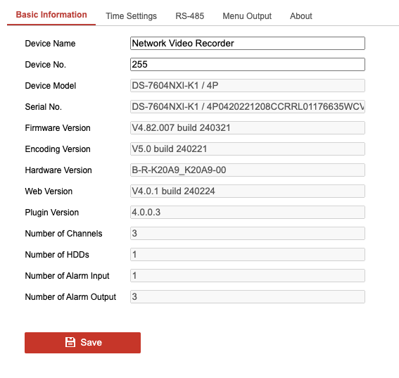

but what confused me even more, see attached, when went back into check firmware now showing this

Hi @seobuilder
Okay, that is strange but at least it does look like the firmware has updated (possibly the reboot was required for the firmware to update).
