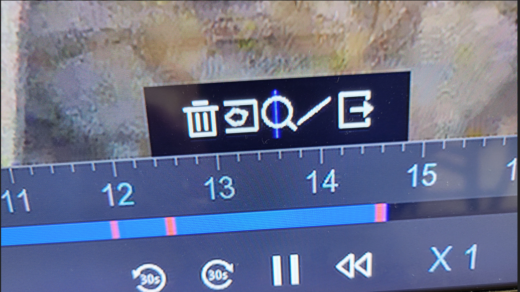

-There was only once a button confusion overlay between Rules and Acusearch that could not be cleared, could not choose one of options, but cleared after exiting Normal Playback, selected Event Playback, perfomed Play with double click the camera and then went back to Normal where lower buttons where clear and visible.

  • When buttons overlay occurs there is also a significant decrease in performance, everything becomes slower, as if low processing power.

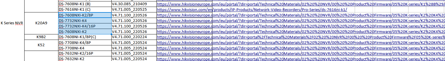

Both the NI-K2(D) and the NXI-K1, K2 use the K20A9 NVR platform so the firmware is the same even though the feature set is not.
Hi @JB1970
The firmware is different.
NI-K2(D) is smaller and size almost 60mb
The NXI-K2 is Acusense and the size is almost 230mb
Yes the platform for (D) is the same as seen here:
I found similar yesterday with the 7604NXI-K1 having a different size firmware to a 7608NXI-K2 despite being the same platform.
Yes I have seen that.
New firmware for K1 is not uploaded when firmware for K2 is uploaded
Can not understand how the two disks affect this difference
Can not understand how the two disks affect this change
I'm gobsmacked that models that have the same platform version have different firmware files. It never used to be that way and I think it'll be too easy to load the wrong right file!
Check this. There is no NXI-K1

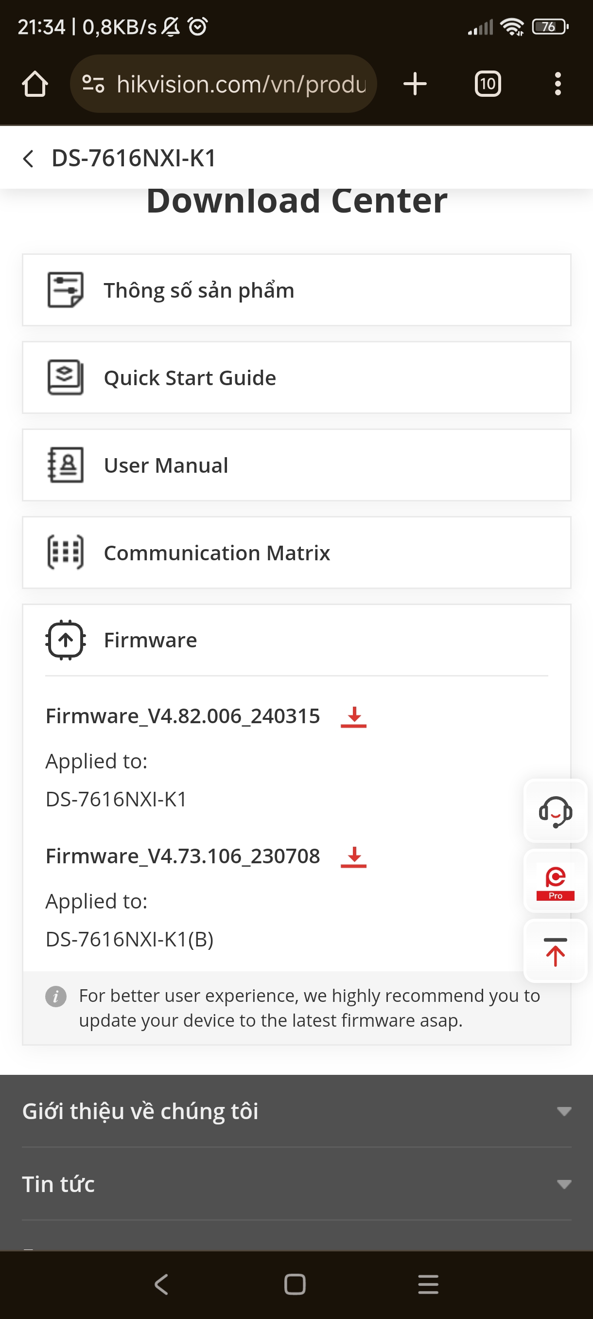

Anyone thinking of purchasing this line should look out for versions with (B) and without (B). I bought version (B) and it was not updated as shown below. When I contacted the seller, they said that version no (B) was produced around 2020-2022, later only version (B) will be available. I contacted Hikvison and they said that the version (B) produced later was shortened and lost many functions, which is worse. Unfortunately, the device produced later has less functionality and the home page does not clearly state or compare the two versions. Now my recorder makes a beeping noise when a pedestrian crosses the line A>>>B while I set it to B>>>A, the probability is about 10%. The company has informed the RD department, and now I see an updated version for version no (B) while version (B) is still not updated nor has the min size and max size algorithm added.
