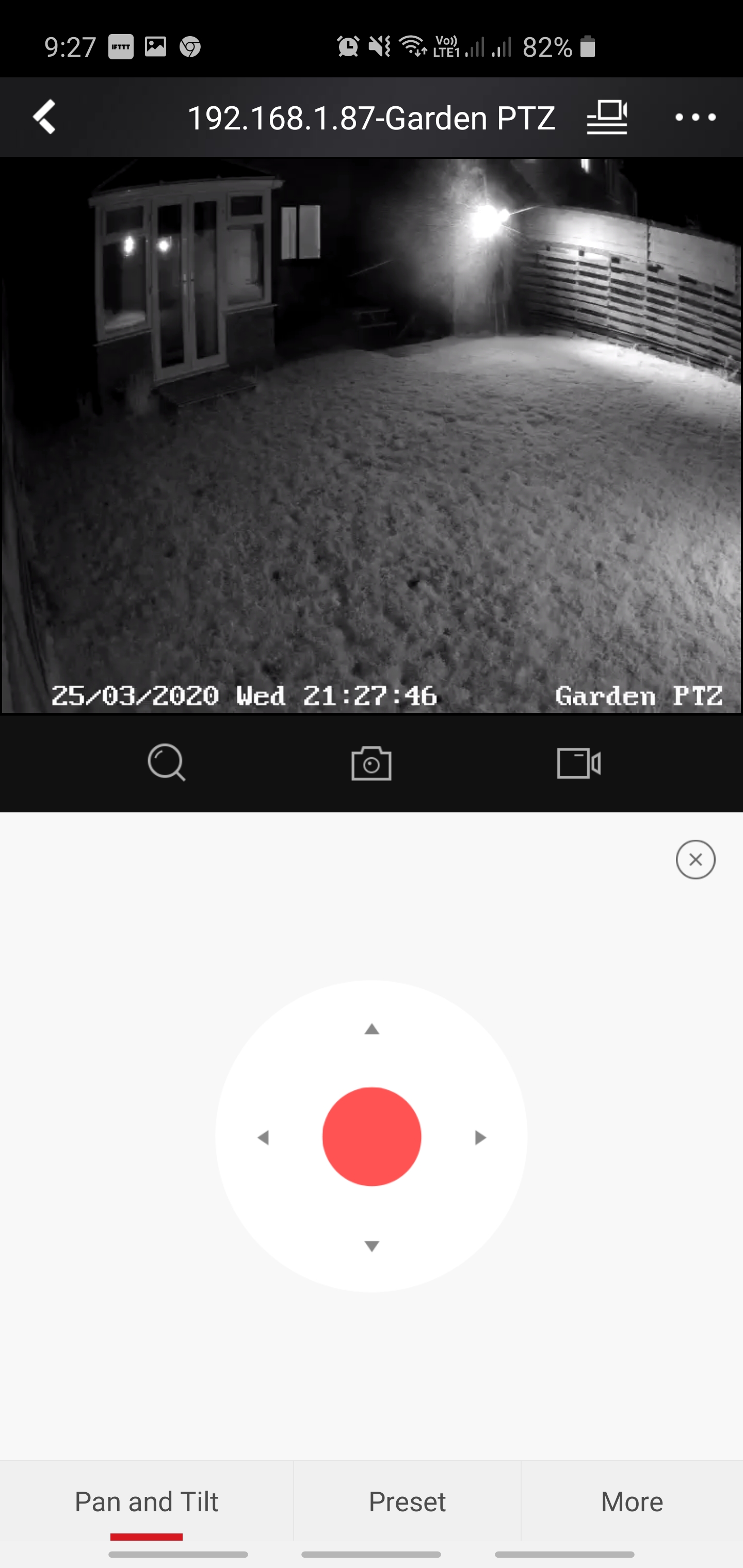

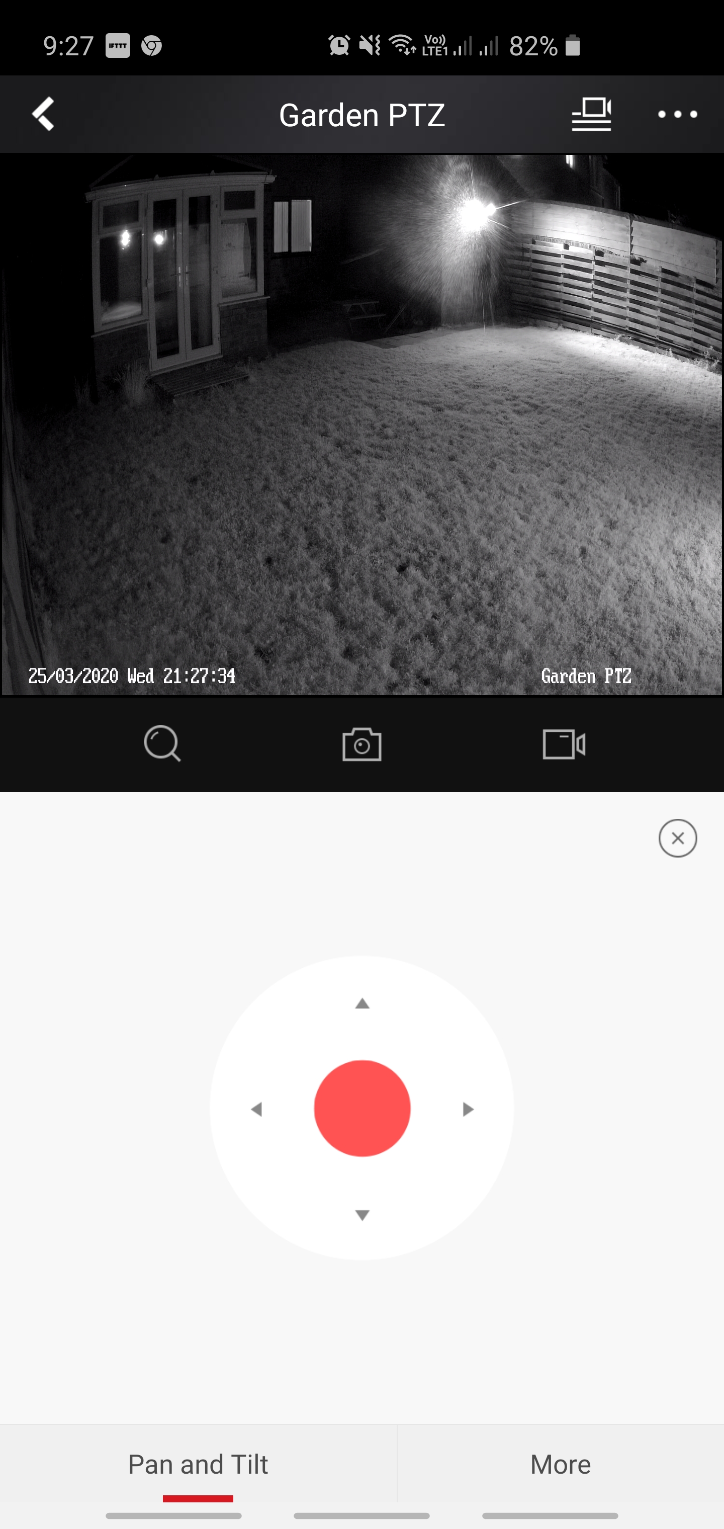

I'm having issues on mine and my dads units running this firmware that the presets option is missing from the hik-connect app so we csnt call any. However when adding the PTZ camera directly to the app the presets option is shown. Only missing since firmware upgrade.
First image is camera connected to NVR and second is app connected directly to camera as it's on LAN.
Anyone else with a PTZ camera experiencing same issues? Any ideas how to fix, is this a setting or do I need to wait for new firmware?
