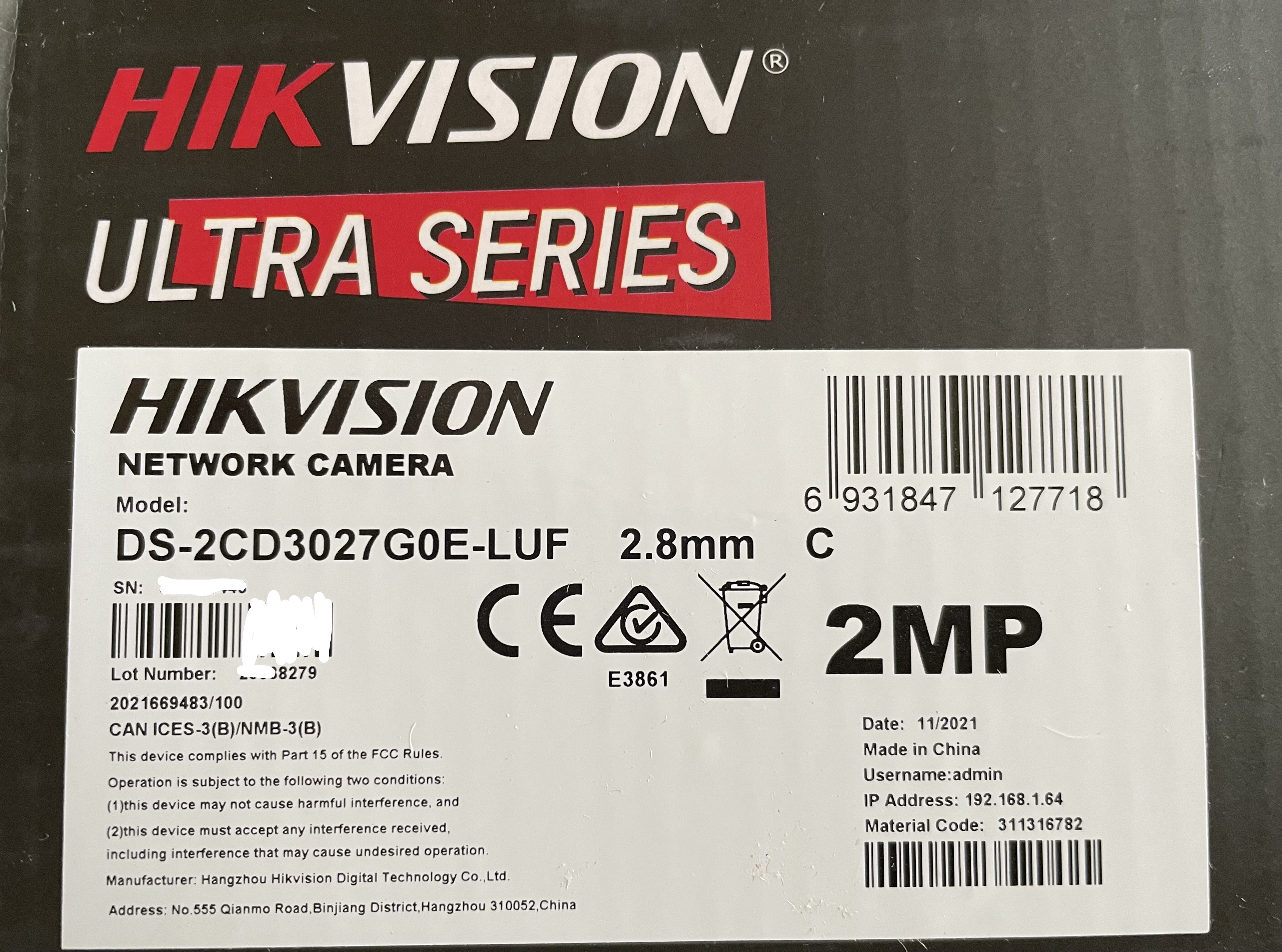

Hi @Dan,
thanks for the heads up. We are based in India, and have bought this directly from Hikvision India. However, their reginal website is not well maintained with all the available models, checked Hikvision Indonesia website as well, nothing turned up.
I've posted label on the box.

This is probably a very late update but:
After having gone down a similar rabbit hole of vendors offering me this model but me mixing it up with 3072G2, wich is a different EOL'ed model, I have been able to locate the following models in the G5 firmware release notes (V5.7.20_SP3 build230425):
DS-2CD3027G0E-LUF
DS-2CD3047G0E-LUF
DS-2CD3327G0E-LUF
DS-2CD3347G0E-LUF
Cool, thanks for update, I was on V5.7.4 build 220509, will try the new one.
@mozley Can you kindly post the link to the firmware ? I could not find it under the E8 platform mentioned in OP.
