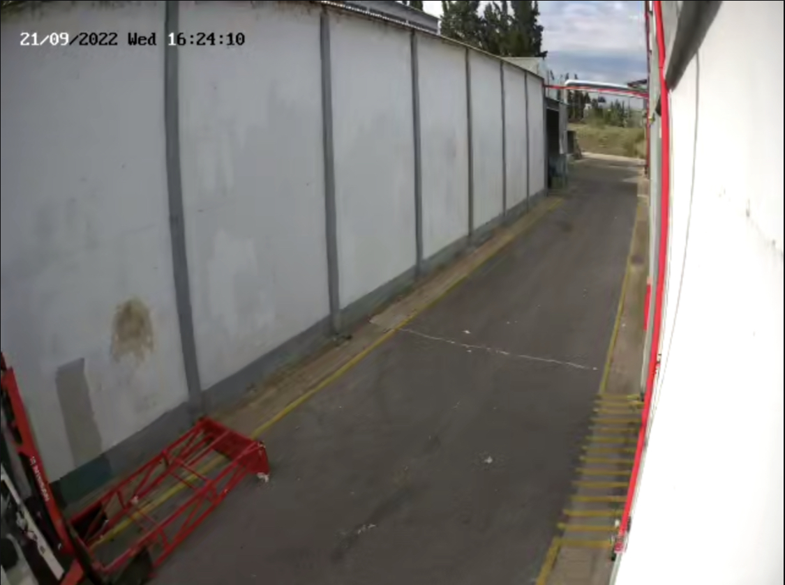

I will attach a photo of one of my cameras to understand what am I talking about.
(Sorry about the quality… is from substream)

I think it is unlikely that the minimum size of a human at the far end of the wall on the left of the image would be as small as a cat/dog in the foreground (I wouldn't set a smart event any further than the end of the wall because the image quality is poor at that distance and this will impact event accuracy), but even if it was, intrusion detection still supports the Human/Vehicle filtering so with either or both of these enabled the event should be far less likely to trigger on animals.
Thanks for your help Dan.
So from your experience how many meters is good point to end an intrusion area for these cameras (2.8mm lens).
I’m asking that because all of my cameras are “watching” large point of fields areas.

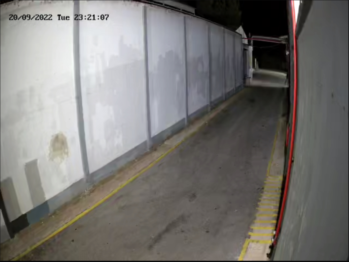

I will attach a day photo of the same area to understand the length. The end of the wall on the left side is about 30meters from the camera. The area above reaches 80-90meters. So in order to have a measurement base to set the intrusion area of each camera and work right, how many meters I have to calculate as the max point for each camera?
Thank you

A basic rule, if you are wanting reliable event triggers day & night, is not to go far beyond the IR range of your cameras (e.g. 60m for 2T87G2 and 30/40m for the 2043)

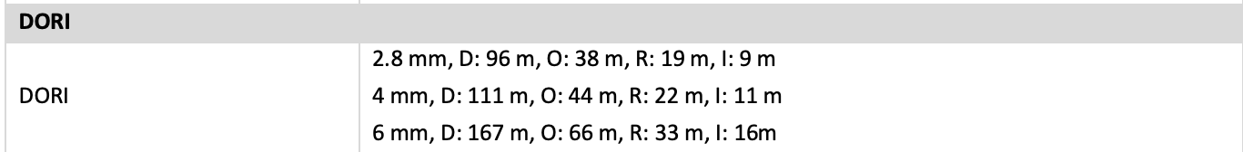

For the 2T87G2 you can also take into account its DORI stats which can be found on the datasheet, see a screenshot below:
DORI stands for Detection, Observation, Recognition, Identify and these figures give you a rough idea of the level of detail you will get at different distances, more info on DORI can be found HERE
You might be able to get events to trigger beyond the Observation distance but as the detail/resolution is reduced the accuracy of the Human/vehicle feature will be impacted and you will probably get more false detection, so we wouldn't set the event zone any further than 40m from the 2T87G2 camera (and 20-25m for the 2043G2).

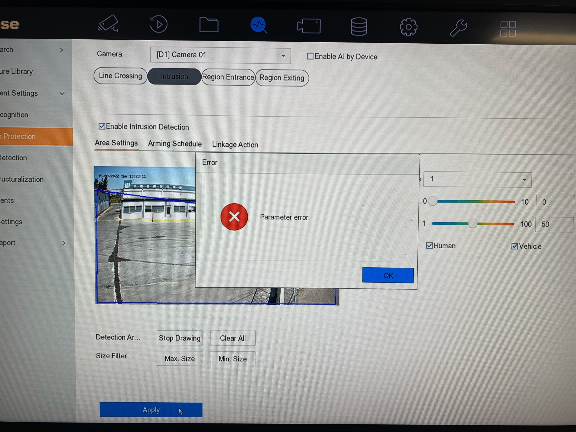

When I enable the intrusion smart event and draw an area in some cameras when I press apply button it gives me a “parameter error” message. Also when this happens it disorganise the intrusion settings of some of my other cameras. For example by unchecking the vehicle and human check box by itself on the intrusion settings of other cameras. Can you help me on what this parameter error means and why this affects the settings of my other cameras?

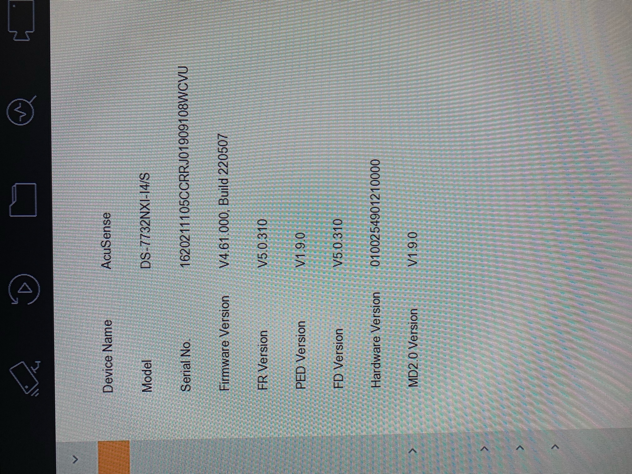

2) I will attach 2 photos. One of the error message and one of my NVR firmware.
But I didn’t understand what you are saying.
I do all my settings from my NVR menu and not directly from each camera.
Also are there any more settings if I login directly to the camera that are not available in the NVR menu?
3) I will check the video. But as I understand from what you are saying, the only available way to check my stored pictures from my NVR is with IVMS and not from web browser. Is that right?

2) The latest firmware for your NVR is V4.61.020, try updating to the STD version of this firmware and see if that removes the error message. On the direct monitor for the NVR, it looks like you do have access to all the event settings (I thought you might have been accessing with a browser, in the NVR browser access, not all settings are accessible).

Dear Dan,
About the error message. Is it possible that the NVR has limit on how many cameras you can set intrusion detection? Or is it an issue if for example I have in one camera both intrusion and line crossing enable?
Also get in mind that I have enable all of my cameras the basic event motion detection.
Hi @alexdel
It could be an issue of multiple events being set, we have seen issues with this on certain models in the past.
I would try disabling line crossing and then try setting intrusion detection to see if that removes the error message.

What about my first question? If there is a limit on the NVR on how many cameras can I enable intrusion detection?
Because I read this on the description. Up to 4ch perimeter protection.
