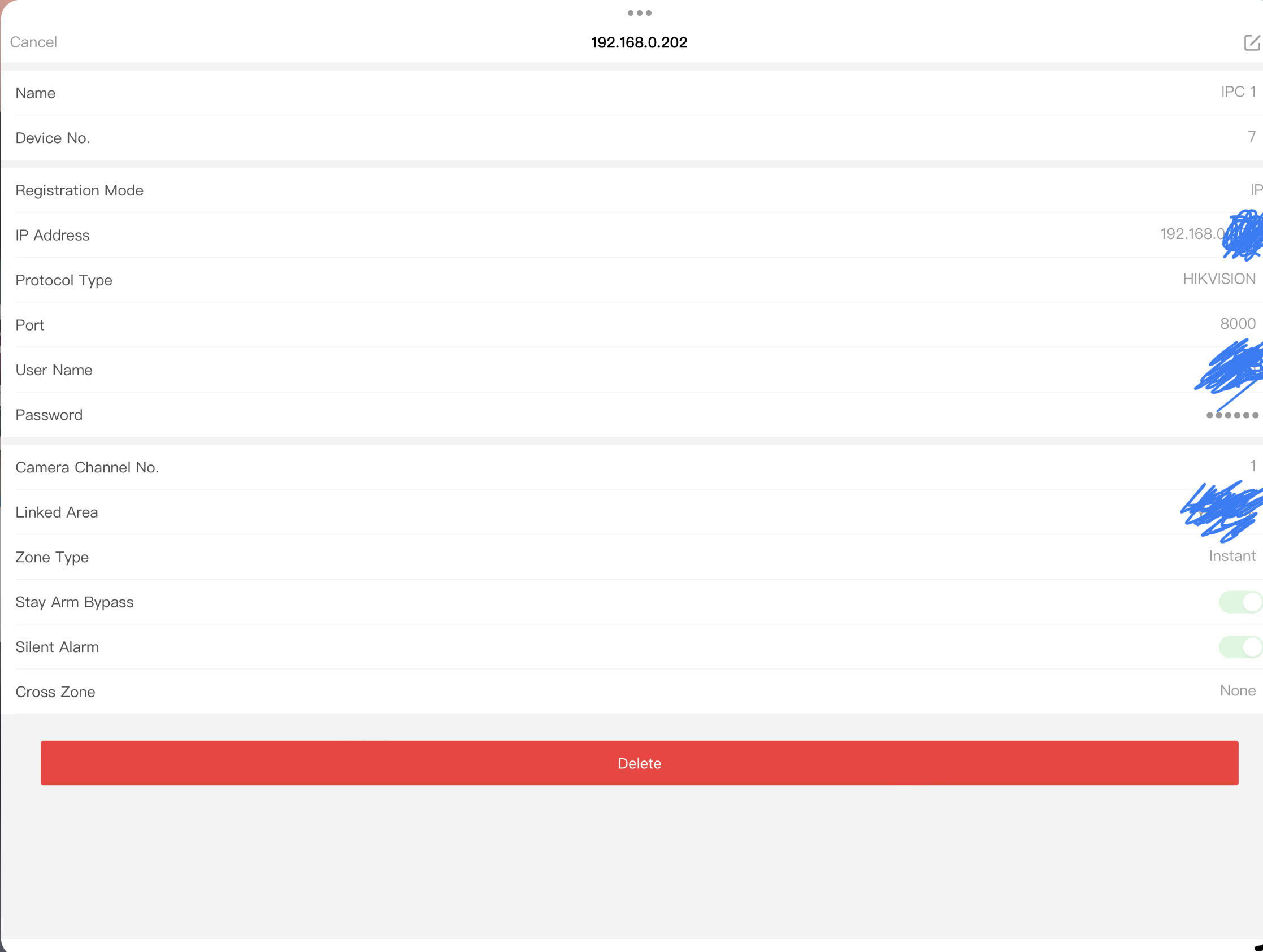

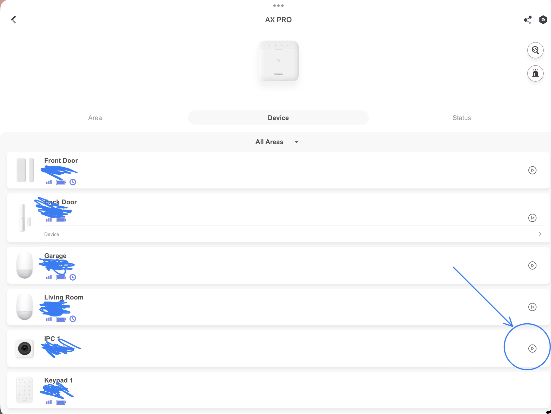

Phill how do you do the line crossing and turn on lights?
I have my hikvision IP camera (ds2386G2 style etc) cameras linked to an NVR and through that I’ve set line crossing not via the AX pro (as i cannot see an option). I have just added the camera i want line crossing (already set in the NVR) to the AX Pro via the AX section of the iPhone HikConnect app.
It now looks like the photo however when you press the play button the wrong camera plays, the IP address is certainly the correct one. Not sure how relevant this is at this point.
I dont currently have a plug, switch, or relay but i thought I’d see the option and then go buy one.
So my questions are;
When you buy a plug do you get additional options appear in the app to link them to cameras or alarms or both?
Can you set times they trigger between, or just when the system is in various states of arm?
What sets the alarm off? The line crossing you’ve set as per the NVR? Or is there a way you setup line crossing in the AX Pro app?
