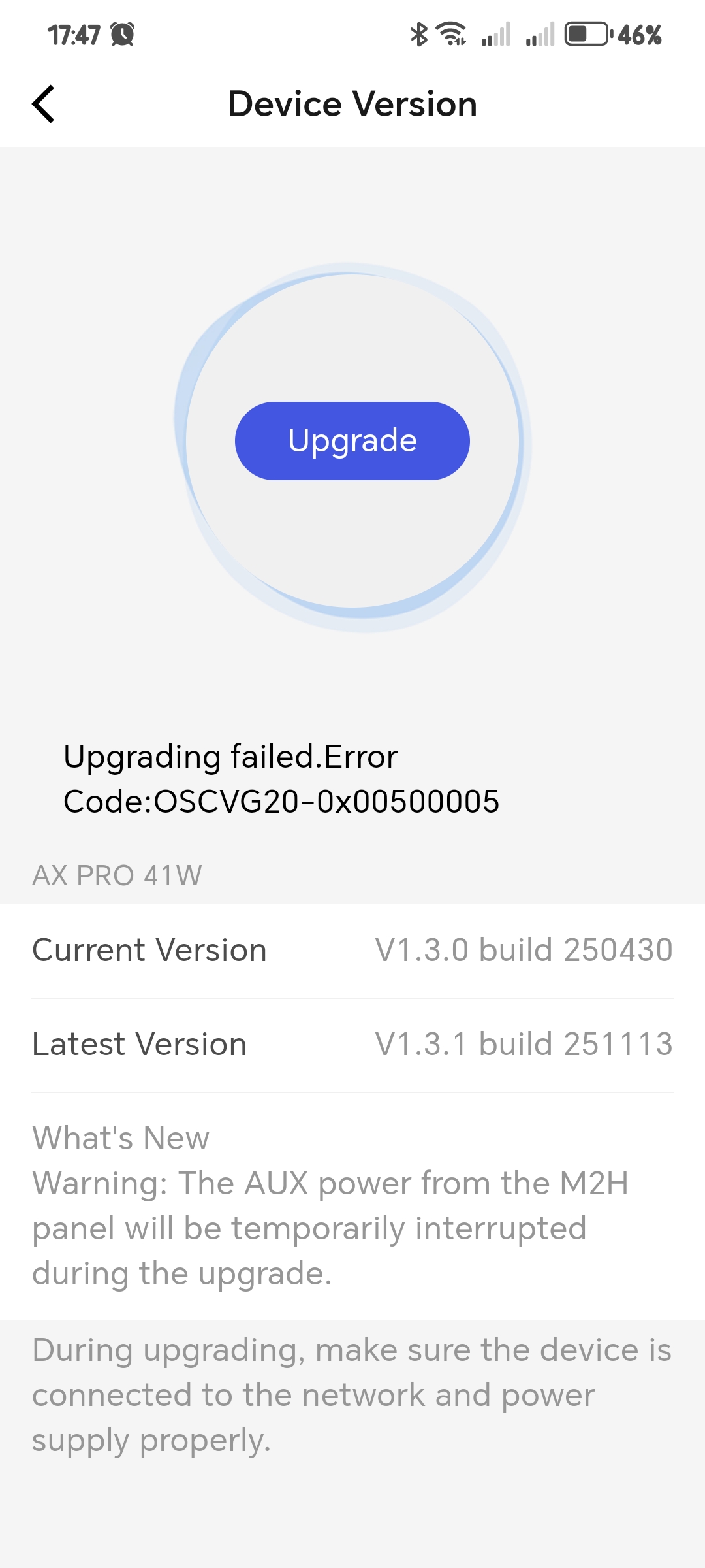

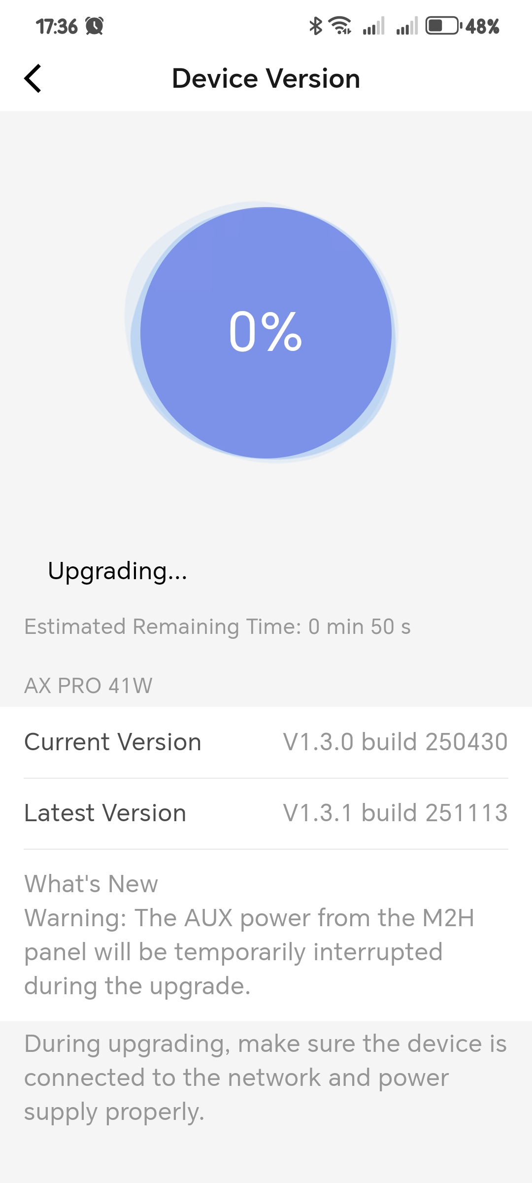

Just had prompt for AX Pro update....
V1.3.1....clicked upgrade.... Estimated 50 seconds, yeah.... 5 mins so far and still 0%....
