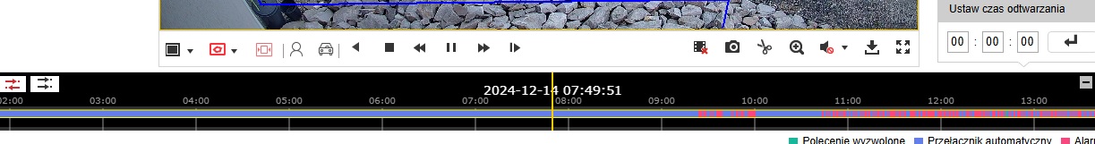

Ok tested the new firmware by installing once again v5.7.18. This time v5.7.18_240924
Same problem again with "Other" targets. The timeline is empty when searching by Rules(draw lines or polygons).
Went back to v5.7.15 and everything is fine again.

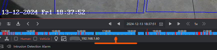

This is yesterday search by rules Motion on iVMS4200. Between 16:30 and 18:10 is the v5.7.18. The rest is v5.7.15

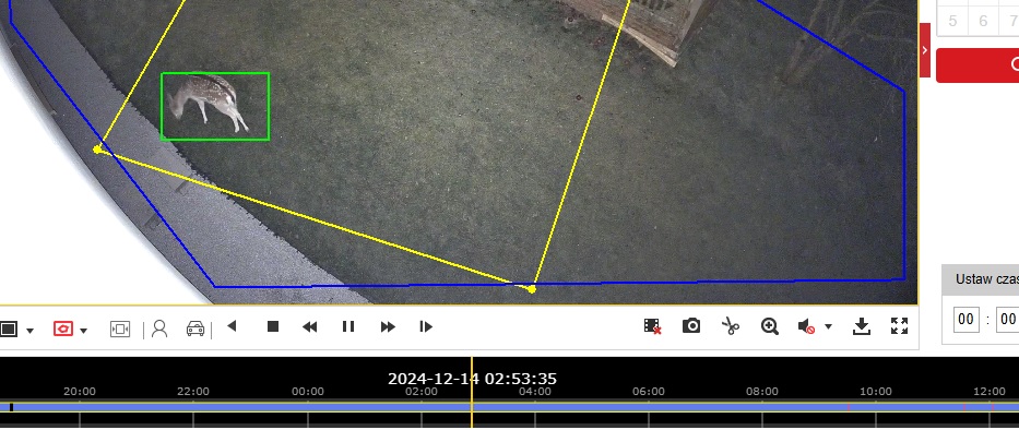

I do not understand. Fallow Deer was not marked, squirrel has been marked hmm

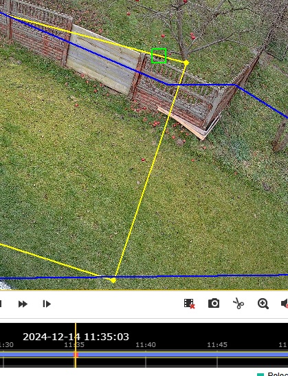

A road where cars are constantly driving, sometimes the traffic is detected, sometimes it isn't.
