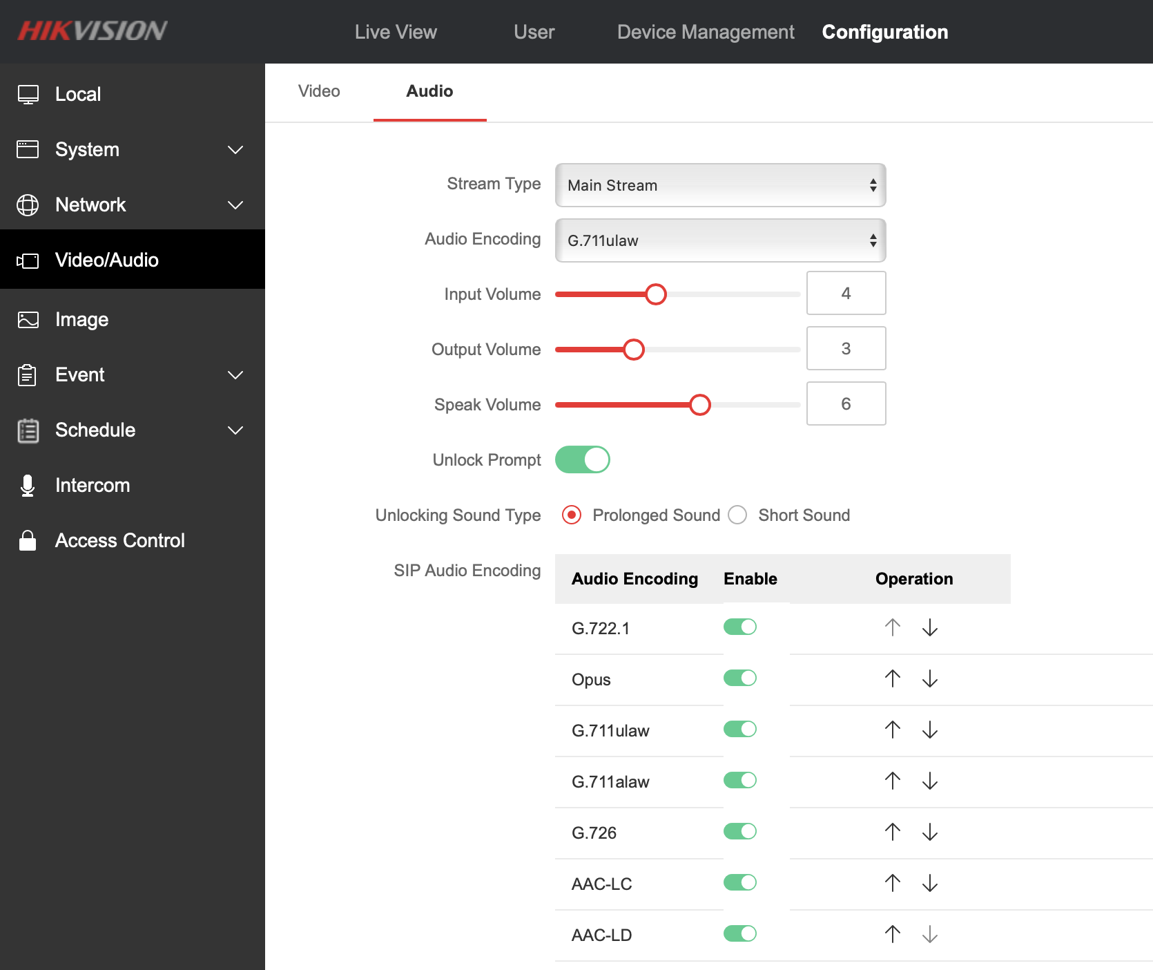

Check the settings in:
Configuration > Video/Audio > Audio
Check both the Unlock Prompt is turned on and whether you have Short or Prolonged Sound enabled:
If it's already set correctly I'd try disabling Unlock Prompt, saving, re-enabling, saving.
