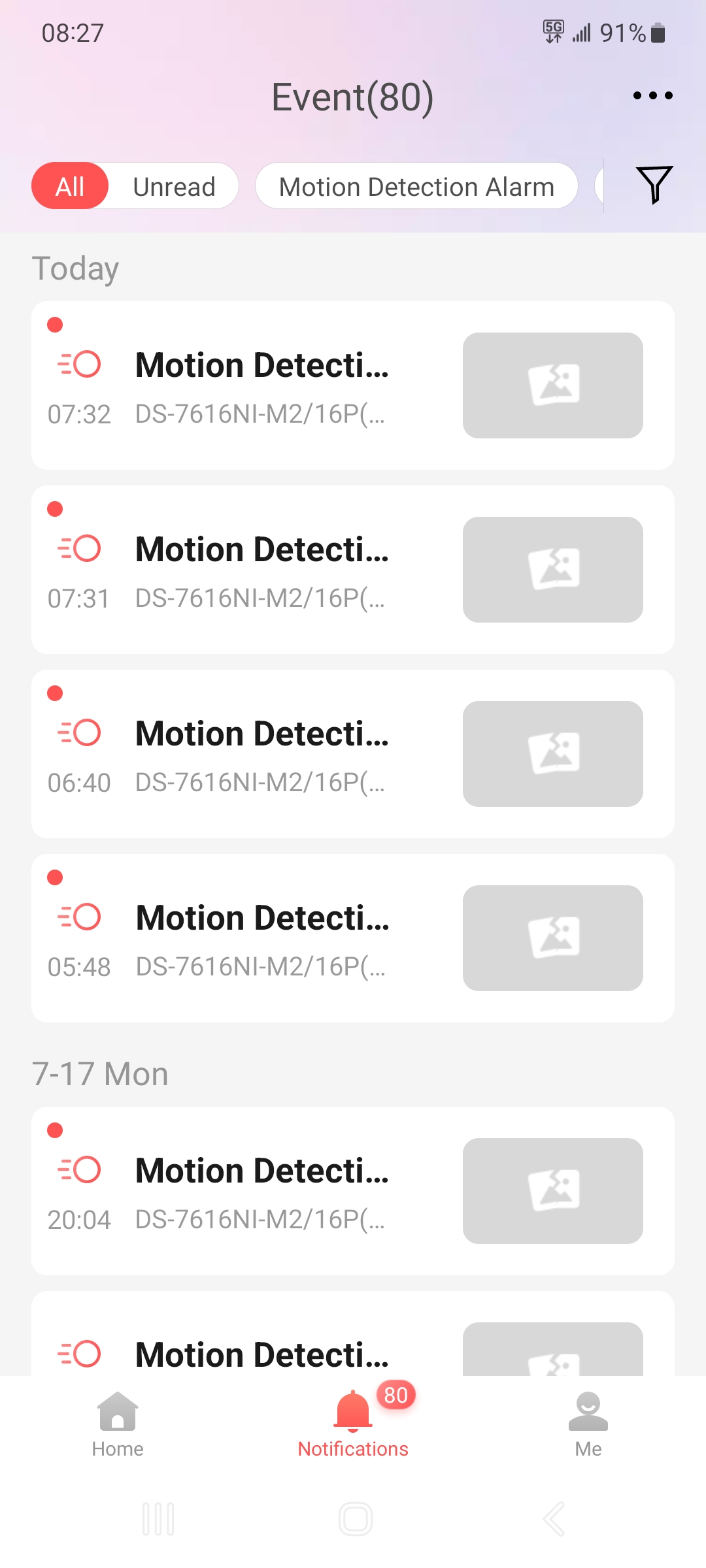

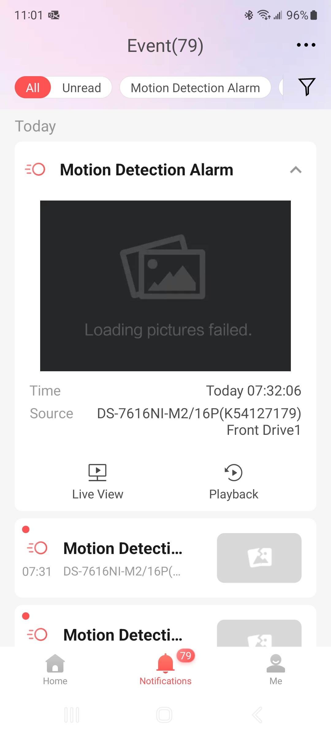

Well did everything. Set everything, removed the entry from the phone, restarted router and nvr. Logged into NVR and opened up HIK-Connect app and scanned QR code. It added it right in. All of the same DDNS settings are still there from before in the mobile app. I can edit them but I dont see a way to turn it off. Its still off on the NVR.
I walk outside, I almost immediately get an alert on the phone. I click it and within a couple seconds it pops up and says Motion Detection Alarm and Loading pictures failed. If I click the Playback at the bottom it plays fine though. Just no pic. :-(
At the point you walked outside, you'll likely have been dropping off your WiFi network and onto mobile data. You may see intermittent issues at that point in time as your connection changes. Temporarily switch off WiFi on your phone to check things. I have had a couple of instances recently when clicking on my NVR in the app, that I temporarily see an error in the event area until I refresh the screen. Likewise, I occasionally don't immediately get the video clip available if I click for it as the push notification is received (presumably as the clip is still being stored on the Hik-Connect server)
Thanks. Yeah I tried that. Connected and disconnected from wifi. Even now several hours later, the same thing happens. I click notifications, then they all show a HIKVISION logo that after a couple seconds changes to a broken image. If I scroll down a little further there are a couple that came through. I might try calling support and seeing what they say since it looks like I have everything setup fine. I will try and attach a couple photos.

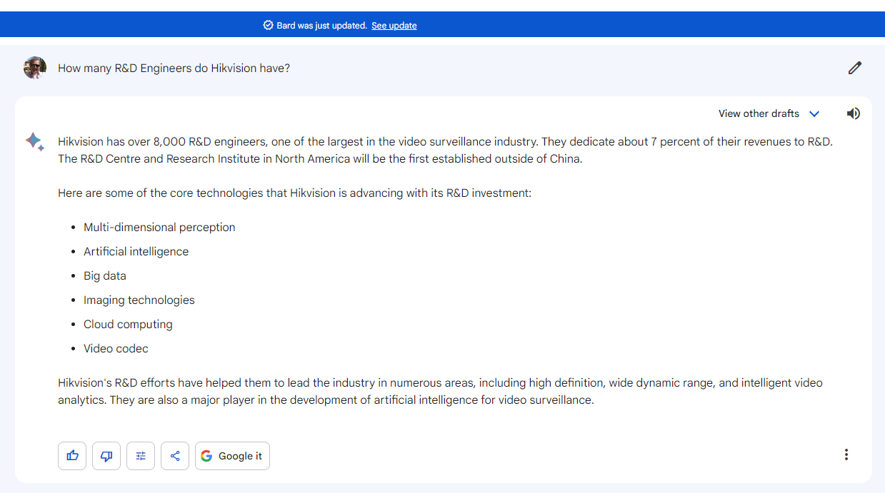

Unfortunately, No, it is NOT a reliable method.
Despite the below amazing statistic, their firmware update checker has NEVER worked :(

There was an update for the app, which I installed but didnt help. I also noticed that this morning one image thumbnail actually came across and shows. The rest all show loading pictured failed.

As I’m having this exact same reported issue which is confirmed by HikVision as a bug. I have iOS, an M Series NVR and new G5 cameras.
Sorry I'm late, but the broken thumbnails you're seeing aren't just affecting you - it's due to some kind of compatibility issue between the G5 camera and M-Series firmware, which I've been discussing with Hikvision (throughout several M-Series firmware releases).
I'm consistently seeing exactly the same thing as you after a customer reported it to me - the first thumbnail seems to work, and then every other is broken.
I tested other cameras (using G3 and G1 firmware) on the same M-Series NVR, and G5 cameras on an I-Series, and there were correct images on all of the thumbnails.
Out of curiosity, is your phone connected to the same network as the NVR when you see them?
If so, and you switch to mobile data, does that get the thumbnails working again?
Hikvision has asked me to check the same, so I'm going to do that this morning and report back.
Thanks John and Kyle. Being on or off wifi doesn't seem to matter I don't think. I have gotten so few of them though like maybe 6 out of 90+ alerts that I'm not sure I noted whether it was on or not. I have never had this work and then they broke since this is a new unit and I've only been using it about 3 weeks.
Yesterday morning when one came through walking to the car, I believe I was on wifi. The only weird thing that's happened is a few days ago I opened the app and hit notifications, and as I slowly scrolled down the list, the images started populating. Didn't change anything. Came back later and opened and they were all broke again. I was thinking it was like they weren't being decrypted sometimes.
