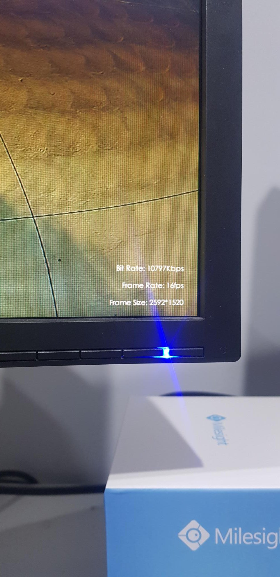

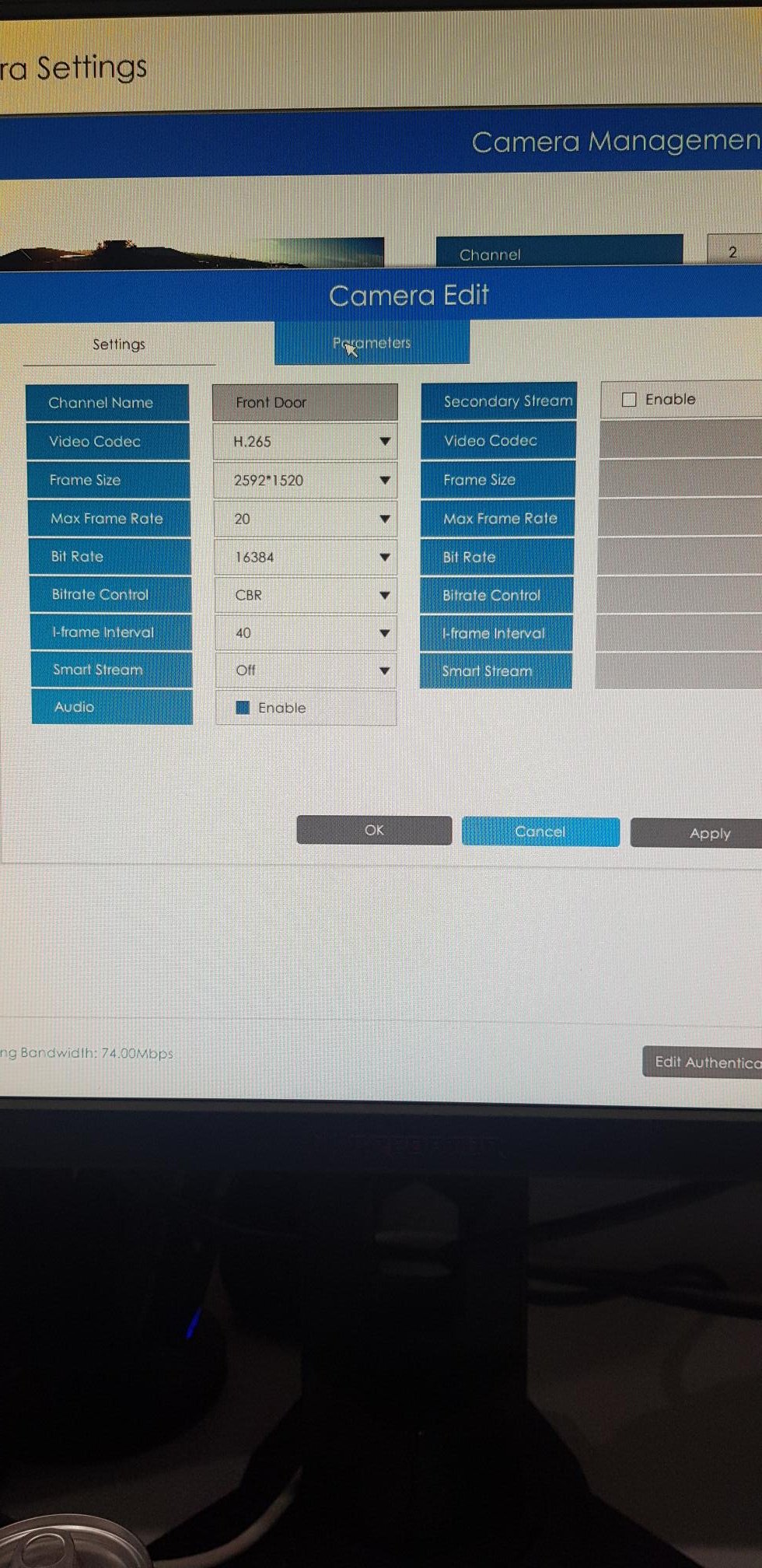

How the camera has stutter. When I look at my NVR directly and my 1 camera the feed stutters. I can't figure out why?
The photos of my settings are attached. It looks like the FPS drops.
I have tried lowering my bit rate and MP and there is still a stutter also in the recorded footage when I look back.

I have seen some unpredictability in the frame rates. 16 fps should be running smooth. Perhaps there is still some configurations to be done in your network.

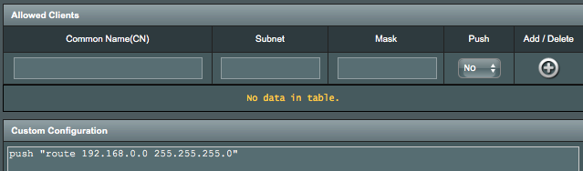

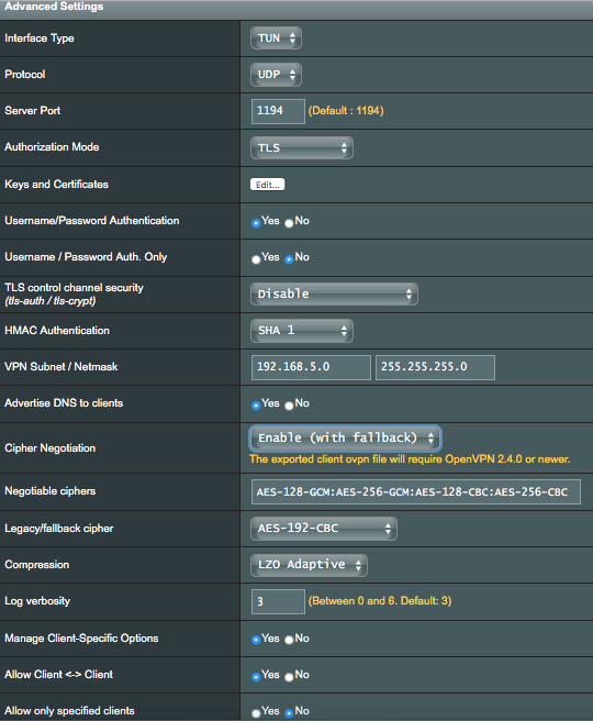

Here are my settings as an example. The version of Merlin is 384.8_2.
