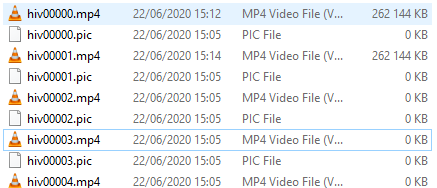

The camera's are actually doing some recording, as I can see some folders getting filled with larger files
As I try to view these mp4 files in VLC, I see recorded footage, but also here strange stuff is happening. The files are indicated to be 37:33 minutes long, but in reality they only last about 6 (?) minutes
It's really getting stranger by the minute... Also, why does the software start filling up datadir8 first, instead of datadir1?

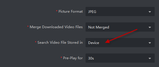

See above setting in iVMS, what isn't that straightforward. You can choose 3 things here:
- Storage server and device
- Storage server
- Device
My thoughs were, that "device" was the camera itself, with an internal memory card and that "Storage server" meant all other types of storage, like NAS devices and so on. Clearly that's not the case. Storage server is only the actual software based Hikvision server, device is all other types.
So I set it again to Device and now I can view recorded files again. I will now stop playing around with it for a while (day or so?) and test it at regular intervals, if I can see the recordings of both camera's...

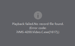

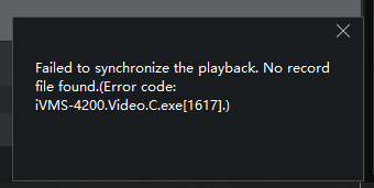

Tried a couple of days now. Keeps very unstable when trying to view remote playback... I haven't yet had to get to view a stable playback. I keep getting errors like this...
So it records from 1 device (I can see the blue line in the timeline) but not from the second device
It seems like it records sometimes, then doesn't... I can't get to get it stable :/ both camera's are recording to the same HD, could that maybe be the problem? Are the recorded files too big to get it all written? I assume that couldn't be a problem, as the basic hikvision NVR's also come with only 1 HD and can record up to 4 streams.

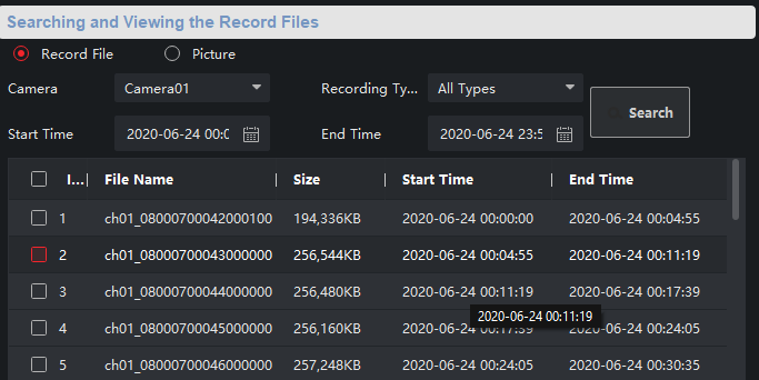

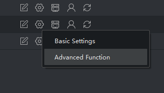

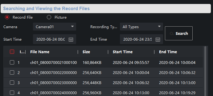

So I need to keep searching for a solution. What I did found, looks strange to me... Follow these steps:
In Device Management I select the first camera -> advanced function
There I go to Files and select a timeframe (1 full day, that is supposed to contain a full day of recordings) I press search
But in this list, I only see recordings for this day from 9:55? When I then select the same view from the second camera I do get a full day of recordings, starting from 00:00 to 23:59
Another strange thing (maybe nothing wrong) is that both camera's are called Camera01 ?

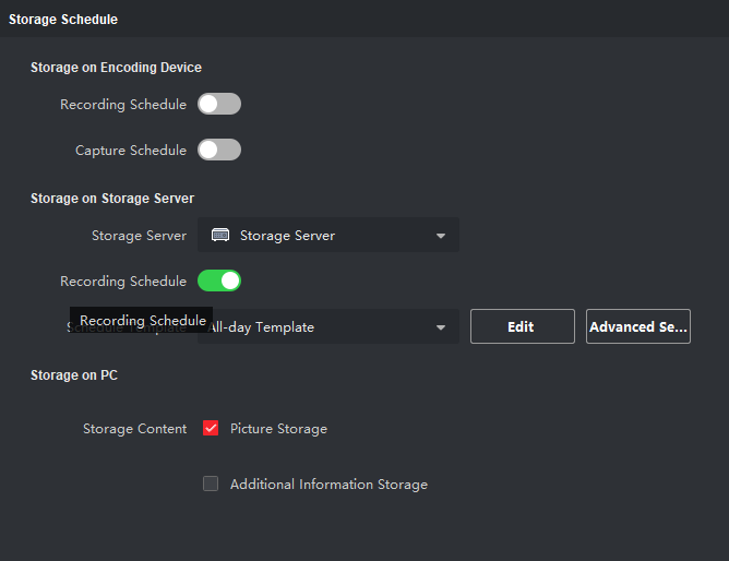

So I now installed a windows server machine, with a spare HDD. I then installed the Hikvison Storage Server software and configured iVMS to use this storage server directly, instead of configuring a storage schedule on each camera itself.
Also in iVMS, under Maintenance & management -> System configuration -> Live view & Playback, I now selected
I let the system record for a while and when I then tried Remote playback and clicked around the timeline, panned, ... All went butter-smooth now... No errors anymore!
So I think I'm correct in assuming that this now all goes trough my networks gigabit connection directly and not trough the 100Mbit camera's anymore... (but I still can be wrong, still learning a lot)
