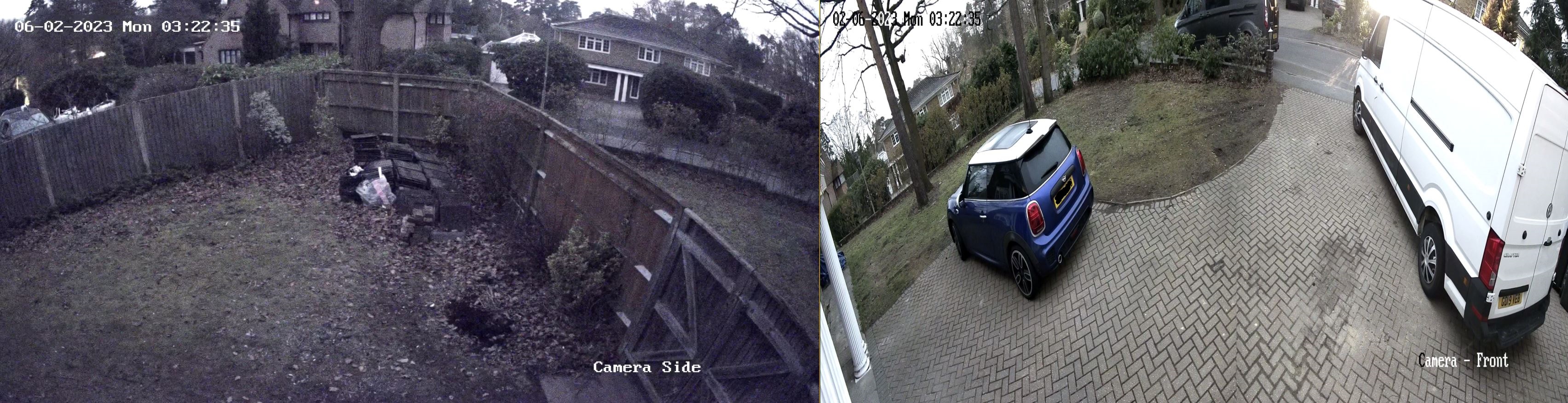

See enclosed the image. Side is the 4mp turret, right is the 8mp panoramic. thanks for looking

Are we actually looking at two views captured at the same time?
If you view those two cameras LIVE now, are they both showing the same/correct time?
Your front camera seems to be capturing the sun rising at 03:22? (light and shadows in front of the van)
In the UK today?
The BBC weather page says that the sun rise was at 07:25 this morning.

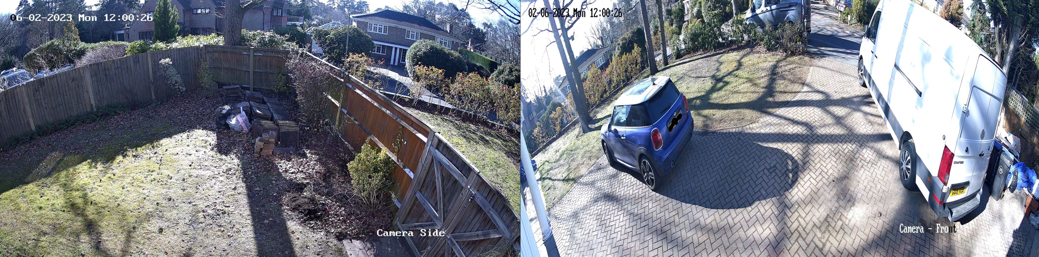

Enclosed for mid day today yes the same and correct time on each
I think the "sun" is actually some light from the house opposite and I checked its pretty much on in the night

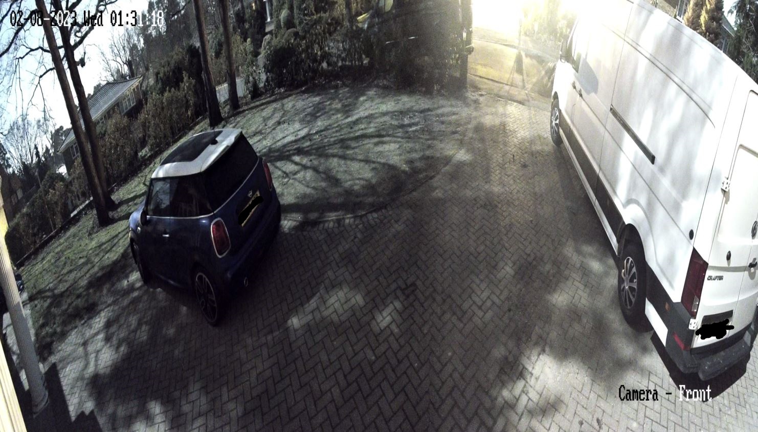

At 1/12 the pic is like this...

That’s the mystery solved of why it looks so good. Each time you double the exposure time, you’re exposing the image sensor to the available light for double the time. Unfortunately that will causes issues:
1 - Recorded footage image blur. When you pause playback if someone moving, the movement over 1/3 second will be your still image. At slowish walking pace someone’s face may have moved 300mm in that time.
2 - Frame rate. If your cameras are at 12 frames per second and exposure is 1/3 second that’s no good. Exposure time ideally needs to be the same or faster than frame rate, so at least 1/25 sec for 25 fps etc (possibly slightly different with ColorVu as default settings are 1/12 sec with 25 fps whereas default for other models is 1/25 sec)
3 - Wide Dynamic Range if needed cannot be used at slower exposure times.
I never go slower than 1/50 sec to reduce motion blur.
