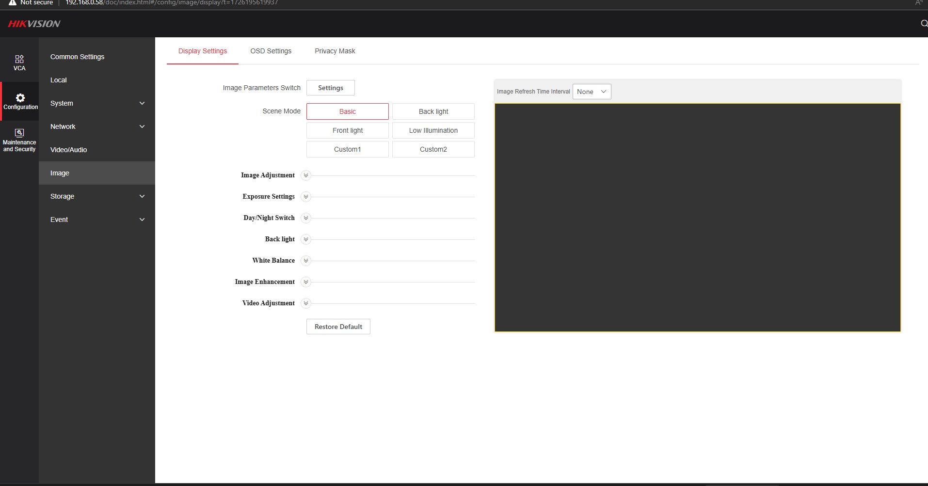

Does anybody know how to get image to show through browser on camera settings page?
Browsed to my nvr then camera settings page but no video:

Does anybody know how to get image to show through browser on camera settings page. Browsed to my nvr then camera settings page but no videoView attachment 11640

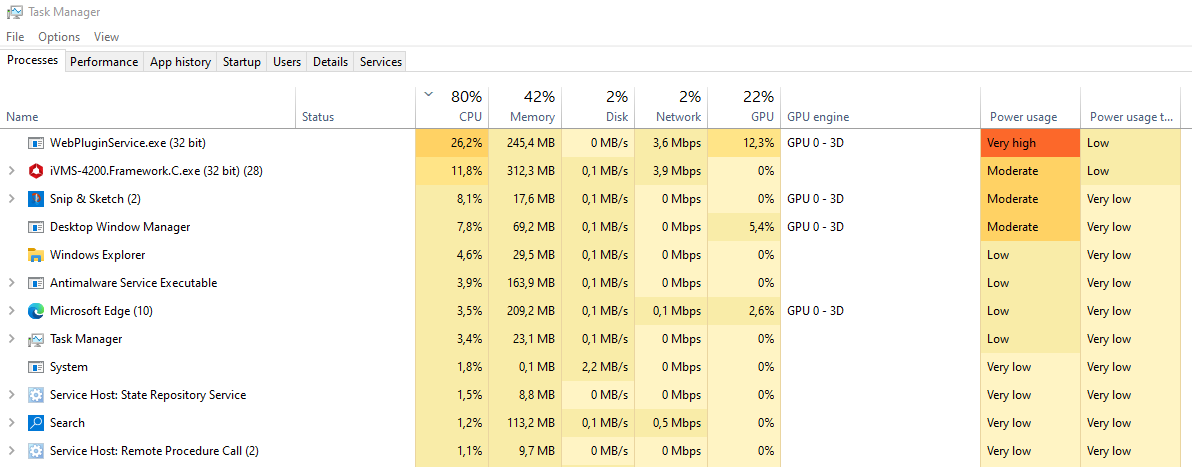

For Microsoft Edge to work, you must see this in Task Manager. WebPluginService.exe(32bit) with high CPU usage:
