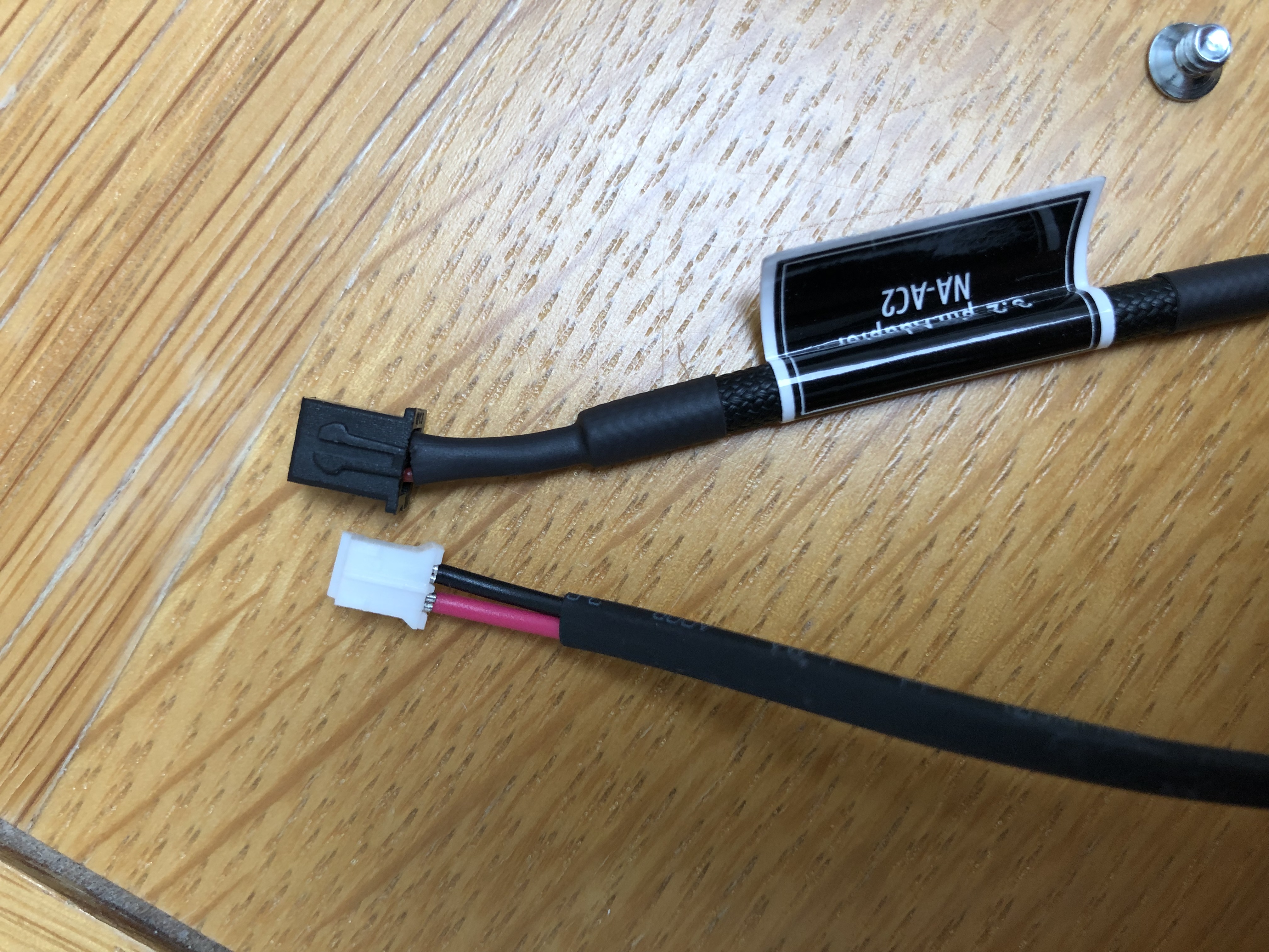

I am trying to replace the fan on my Hikvision NVR psu and have the same question as the op
I bought the a4x20 and the fan itself will fit fine, however didn’t come with a 3 pin to 2 pin converter. So I bought the NA-AC2 to do this (fine for the side fan). But this to too big!!
Can someone please direct me to a U.K. link to the correct adaptor to purchase? I do not feel comfortable soldering or requiring.

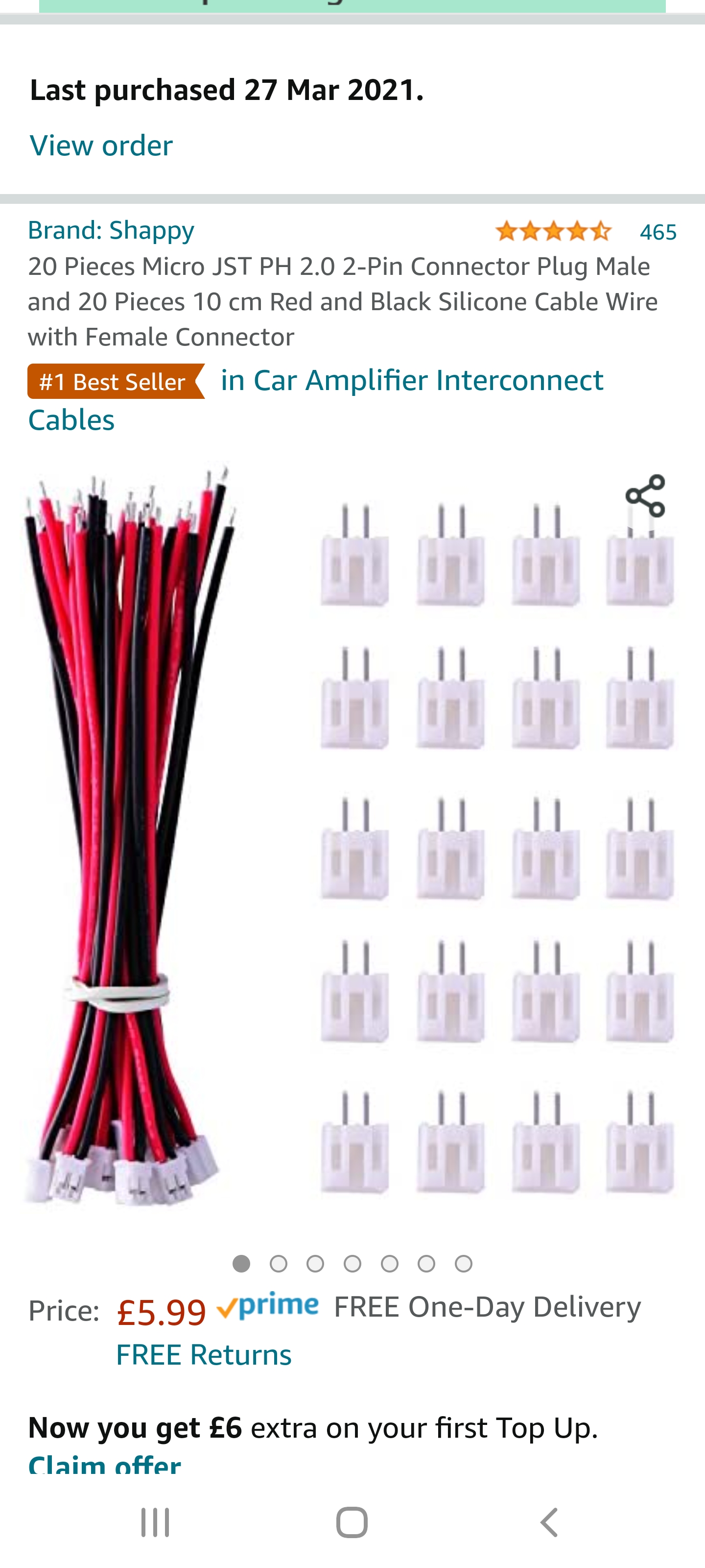

I bought these and used them on the noctua fan splicing that wire and keeping the original in 1 piece.

Ok thanks. Is splicing easy??
Also what width is that 2 pin connector please
Yeah. Get some heat shrink to go with it and solder together.
2.0 it says.
