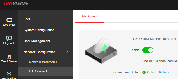

on the NVR configuration page:
is the connection status showing error "Offline (0xe0020008)"?
