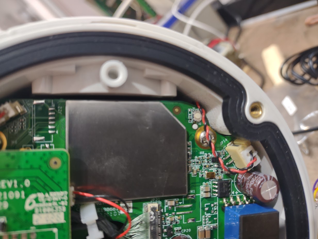

Reset is a very small white button near the screw.

Hi insecurity,
i‘ve tried a reset too ( power off, push and hold button, keep holding pushed button while power on….release button after 15 seconds ) but nothing happens. I don‘t know what i could do more to solve the problem ?! Is the cam dead ???? Thanks for any help
