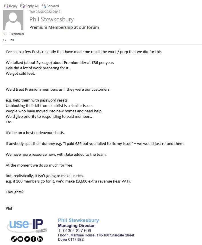

The team here discussed it again very recently (2nd August - see attached).
We just have not yet 'pulled the trigger' for fear of any pushback / upset.
The team responded to the below with a number of concerns.
Mainly worried that people might expect too much and be disappointed i.e. for such a small fee we are NOT going to gear-up for out-of-hours responses!
And, despite masses of experience, we might not be able to fix every problem :(
