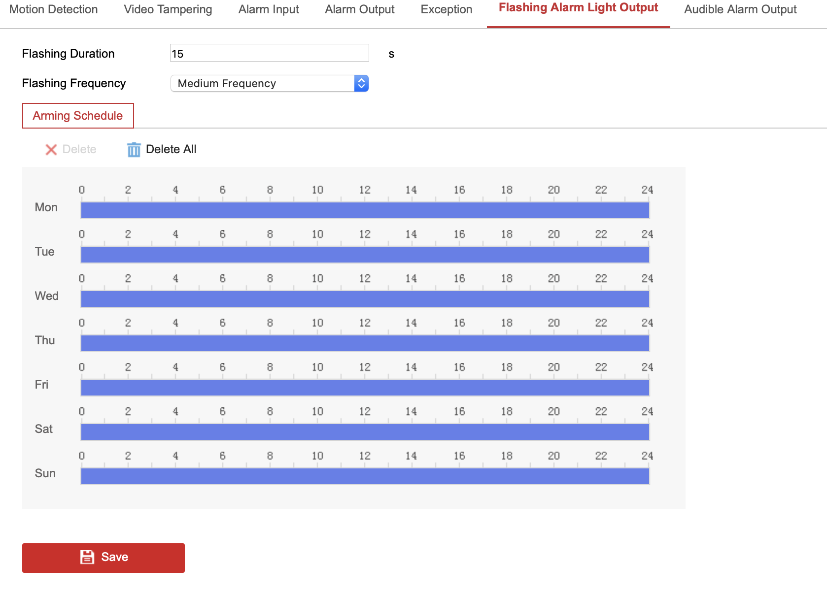

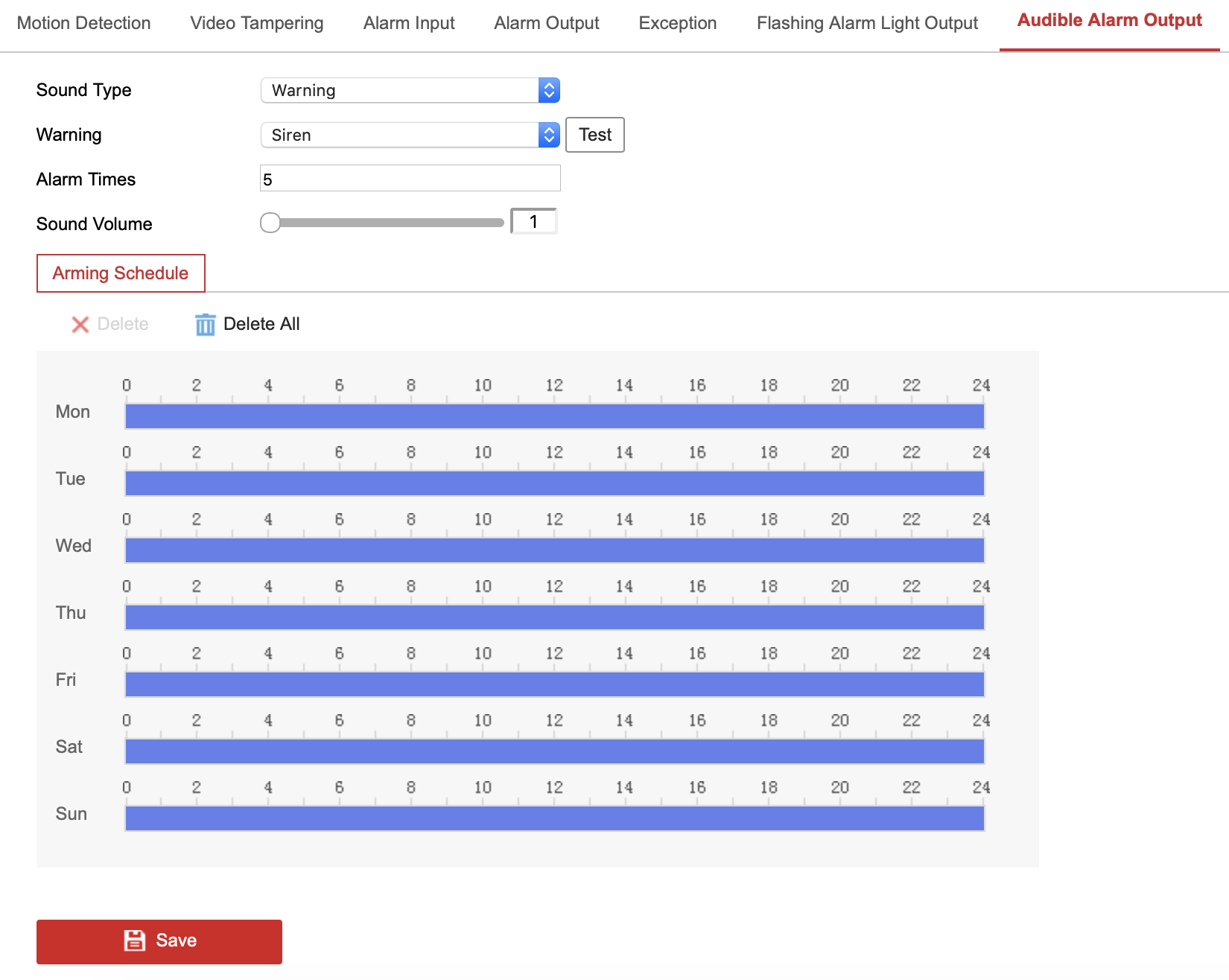

Even if the event is set to trigger the alarm and light - both the audible and visible warnings can be set to individual schedules as per the pics below.

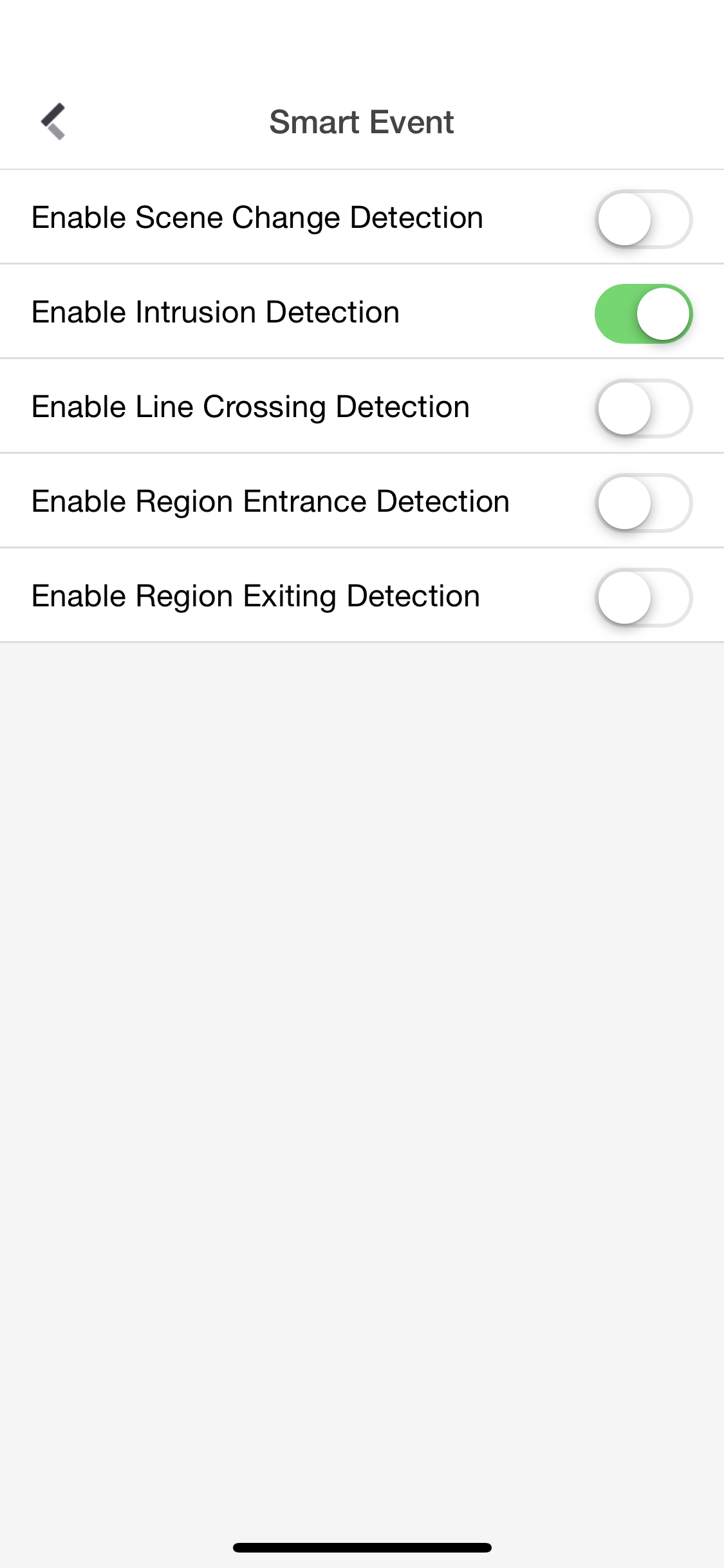

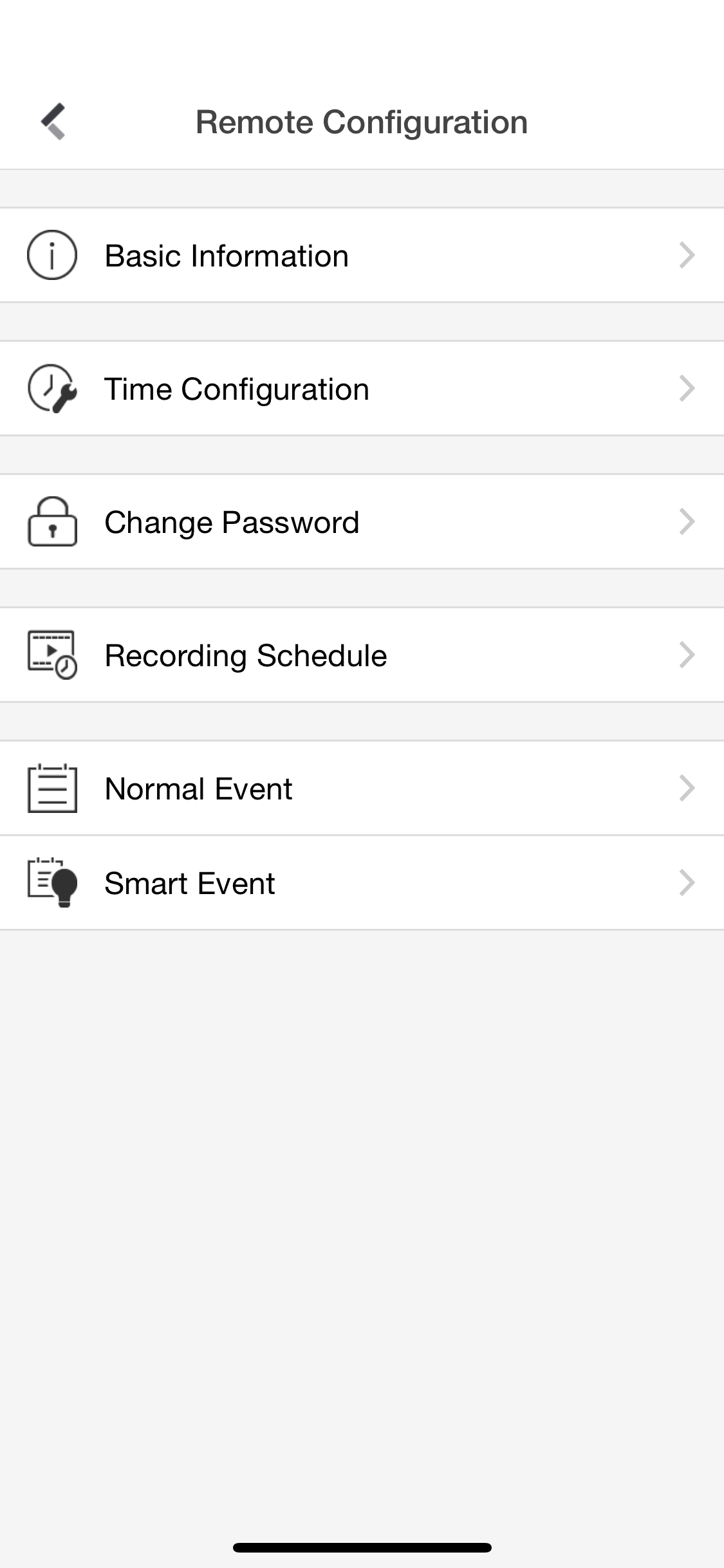

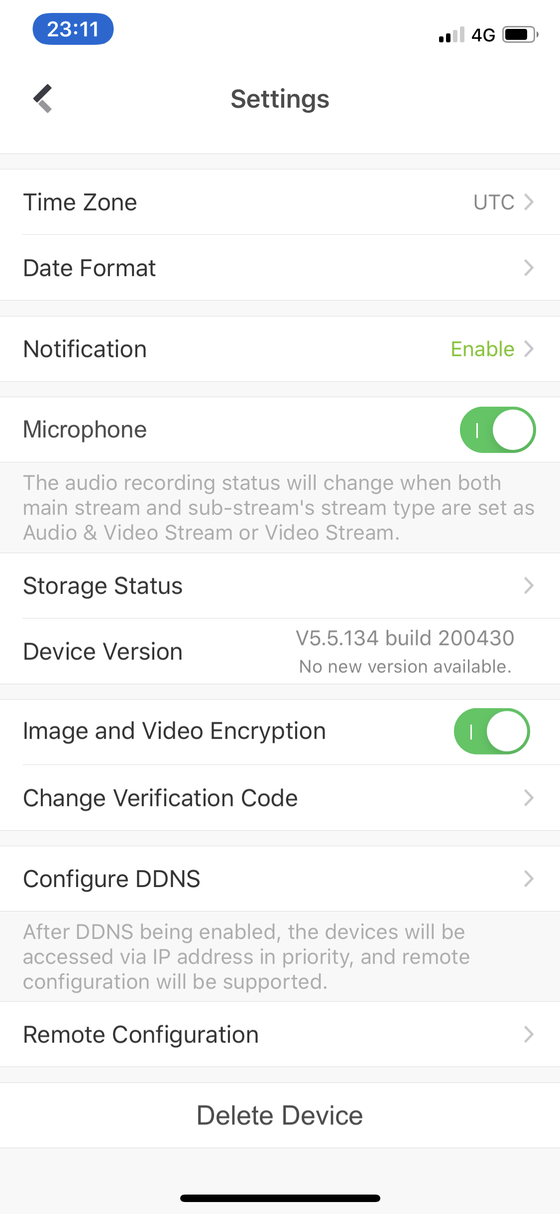

I've just been trying to find away to turn off the Alarm an Strobe on my G2 for a few weeks now.
Tried the One-Key Do Not Disturb function in Hik-Connect, but found out that only stops the notifications an doesn't turn off the Alarm and Strobe.
The only way I have found that dose work to disable the Alarm an Strobe remotely through the Hikvision-Connect app is if you Configure DDNS through the App. then you will be able to toggle off Smart Events.
